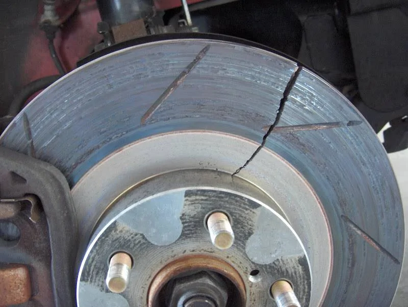

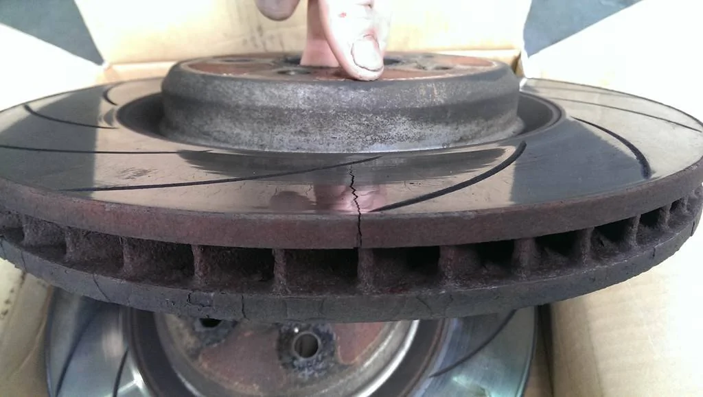

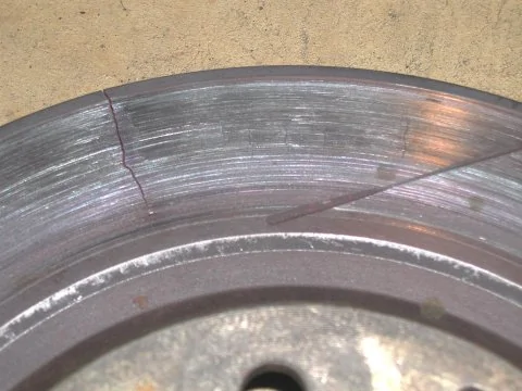

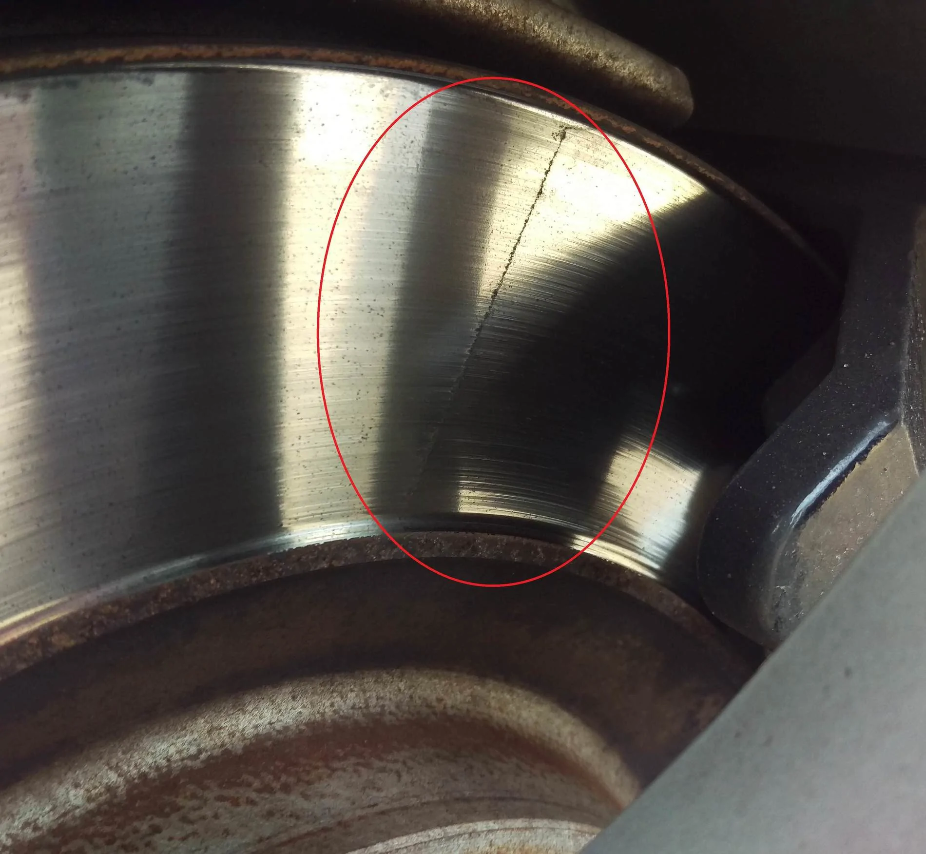

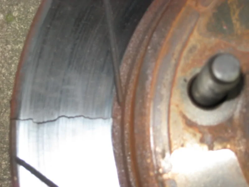

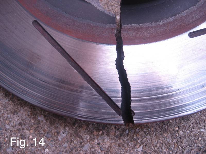

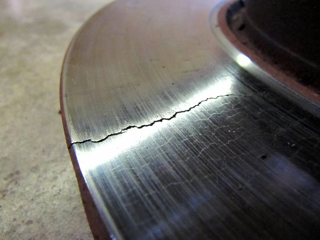

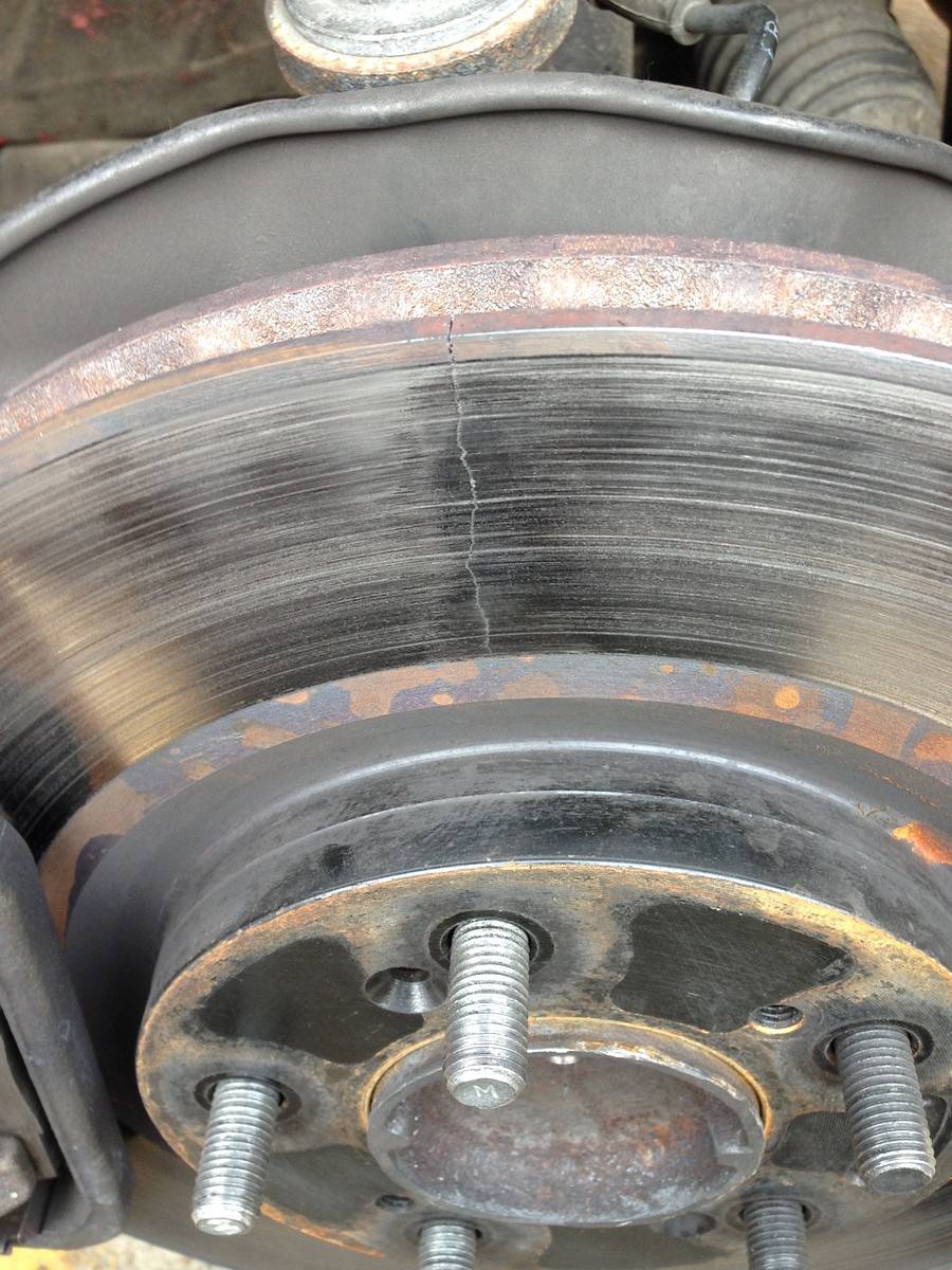

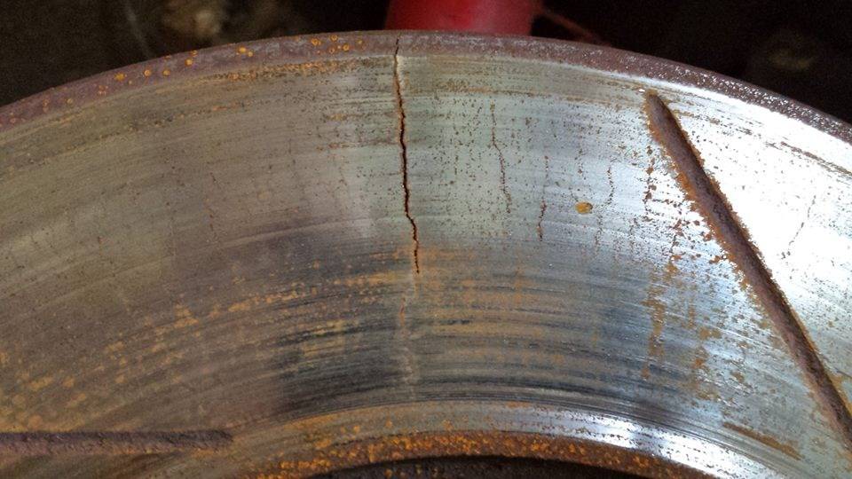

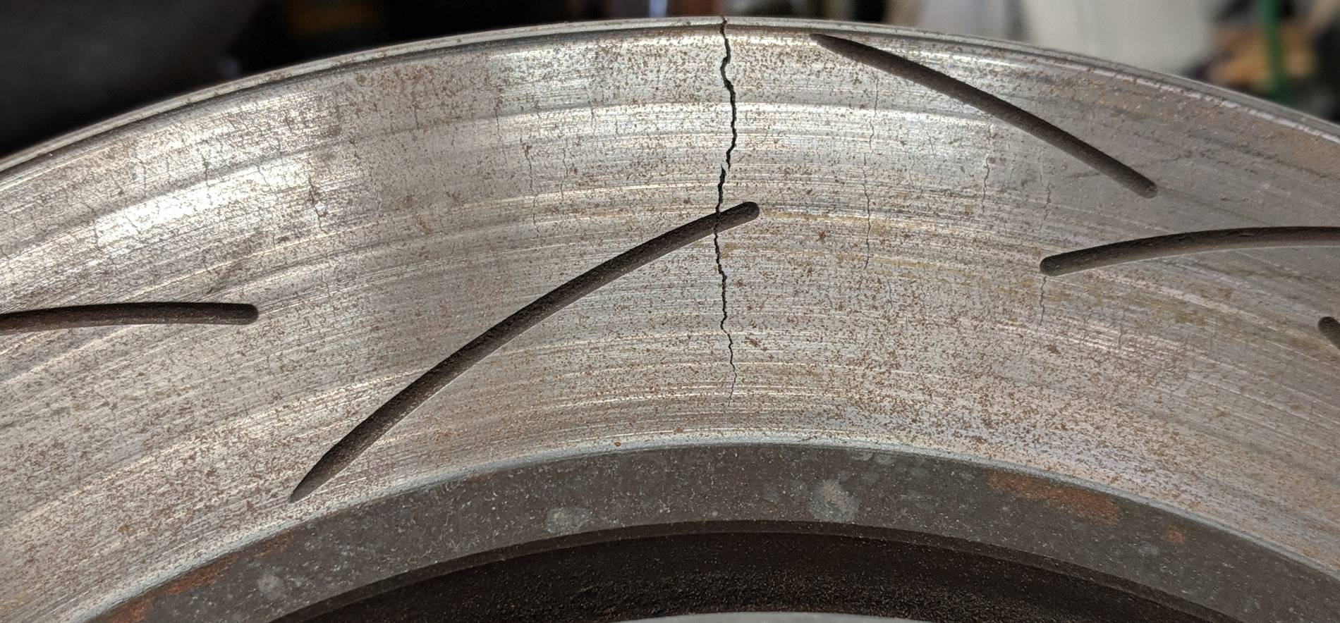

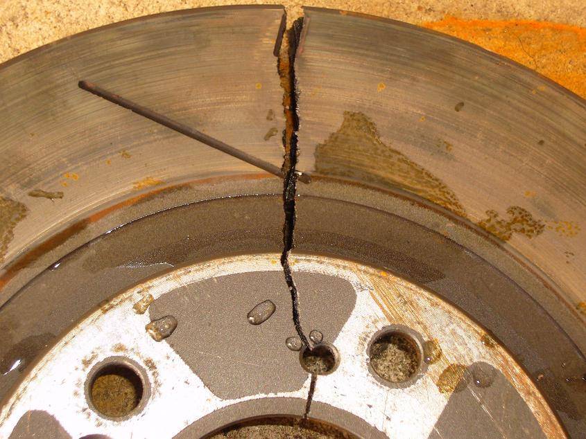

Ive had my drilled and slotted rotors for 30k miles, and 770 rwhp, hit 193 and braked down with them (slowly though) but no issues at all with the rotors. Better 100% of the time that ive had them than undrilled rotors because they have been lighter this entire time and have not given me any problems with how I drive. For most people drilled and slotted rotors will be better because they are lighter and almost no one drives hard enough to crack rotors.
That being said, ive also seen atleast as many cracked undrilled rotors online...

Lol no.
The OP asked about tracking the car. If you actually use the drilled rotors on track, they will crack and fail a lot more quickly than non-drilled rotors. That's been proven over and over again.
The main weight savings is from two-piece rotors, not the holes drilled in them. Modern brakes don't benefit from holes.

Yep...I was going to say the same thing. This is the HPDE sub forum and we are talking about driving them hard.
A one-time high speed gradual braking down with drilled rotors is not a test of durability or performance...Of course you'll still find other rotors cracking if you're doing a generic search - no one says you can't crack a rotor at all. Drilled will see earlier and more sudden failures, especially under hard use.
