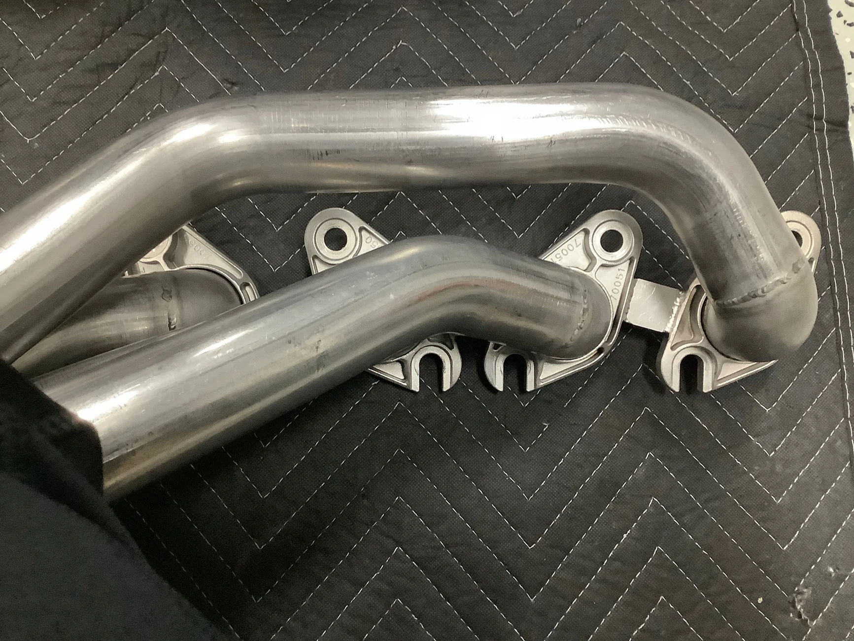

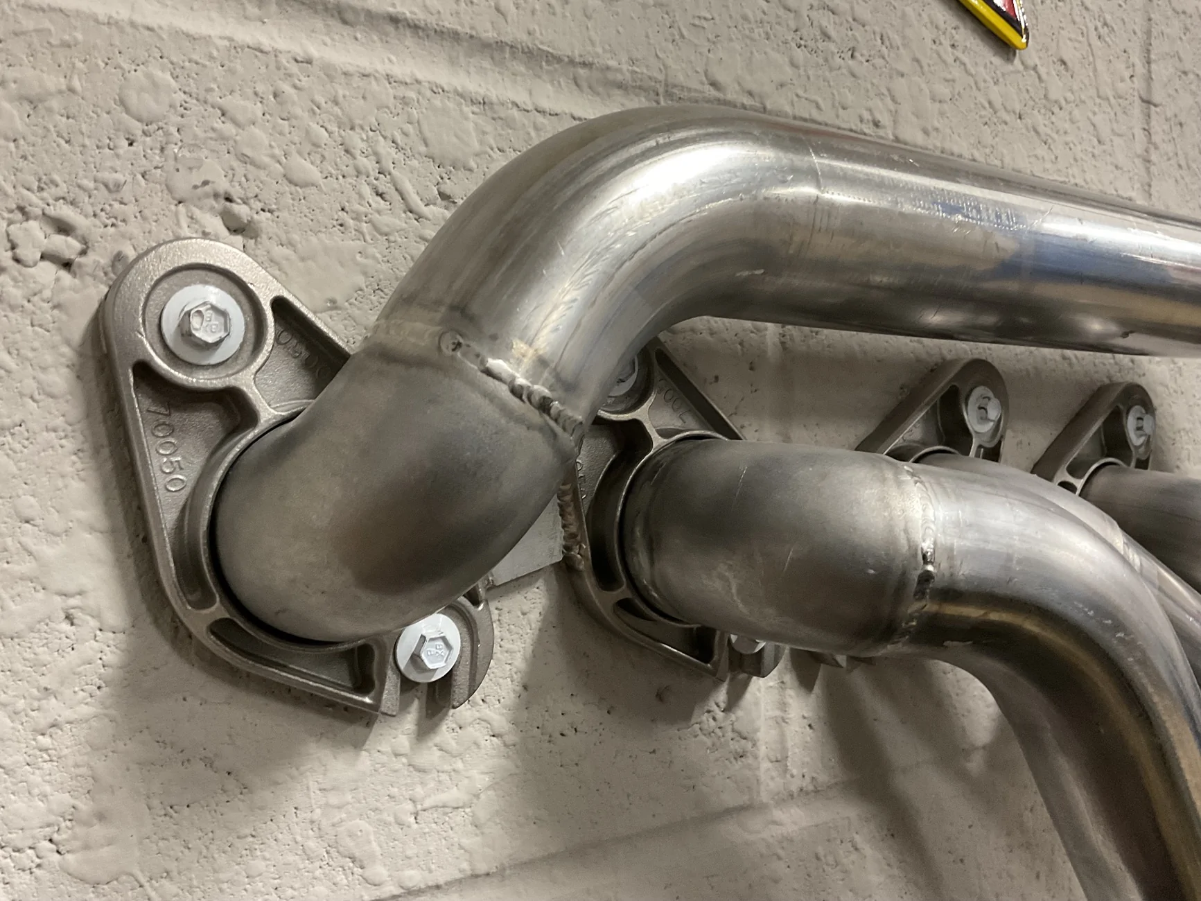

It looks like they switched to 304 like everyone else, no mention of 321 on their web site anymore.
The whole header was never 321, only the first 2-3” of inches of the primary tubes were. I doubt they changed that, but a quick call to the office would confirm for certain.

@John S here’s a pic of my spare Ultimate Headers header which I use as wall art. Look at the difference in material in the first couple of inches on the primaries.

From what I recall of their previous literature of what differentiated their headers from everyone else was the thick, investment cast stainless flanges and cast stainless tight radius elbows welded to those flanges for better fitment. The tubing welded to the elbows was supposed to be 321 alloy instead of 304. Not that my naturally asperated exhaust manifolds will reach extreme temperatures, I've seen plenty of headers and turbo-charged exhaust systems glowing bright orange and I'd rather have 321 over 304 or 409 alloy if I had the choice. I e-mailed Ultimate, tonight, for further clarification.

I can't image 321 has an advantage over 304 in a long tube header street or drag race application. Possibly in a road race application. I suppose it's nice LTH offers 321 but I wouldn't pay any extra for it.
