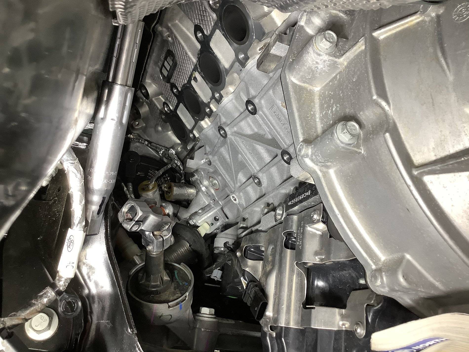

I’ve been working on the long tube header installation on my 2019 Bullitt for the past three days. Prior to this, I had done one other LT install on my previous S197 Mustang. On that one, I dropped the entire K member. I had planned to do the same on the Bullitt, but ran into a problem getting the lower strut bolts to release after hitting them with a hammer. I only had a carpenter’s hammer on hand, so I had to work around the K member. I’ll share some lessons learned, so that the next person doesn’t struggle with certain parts of the install like I did.

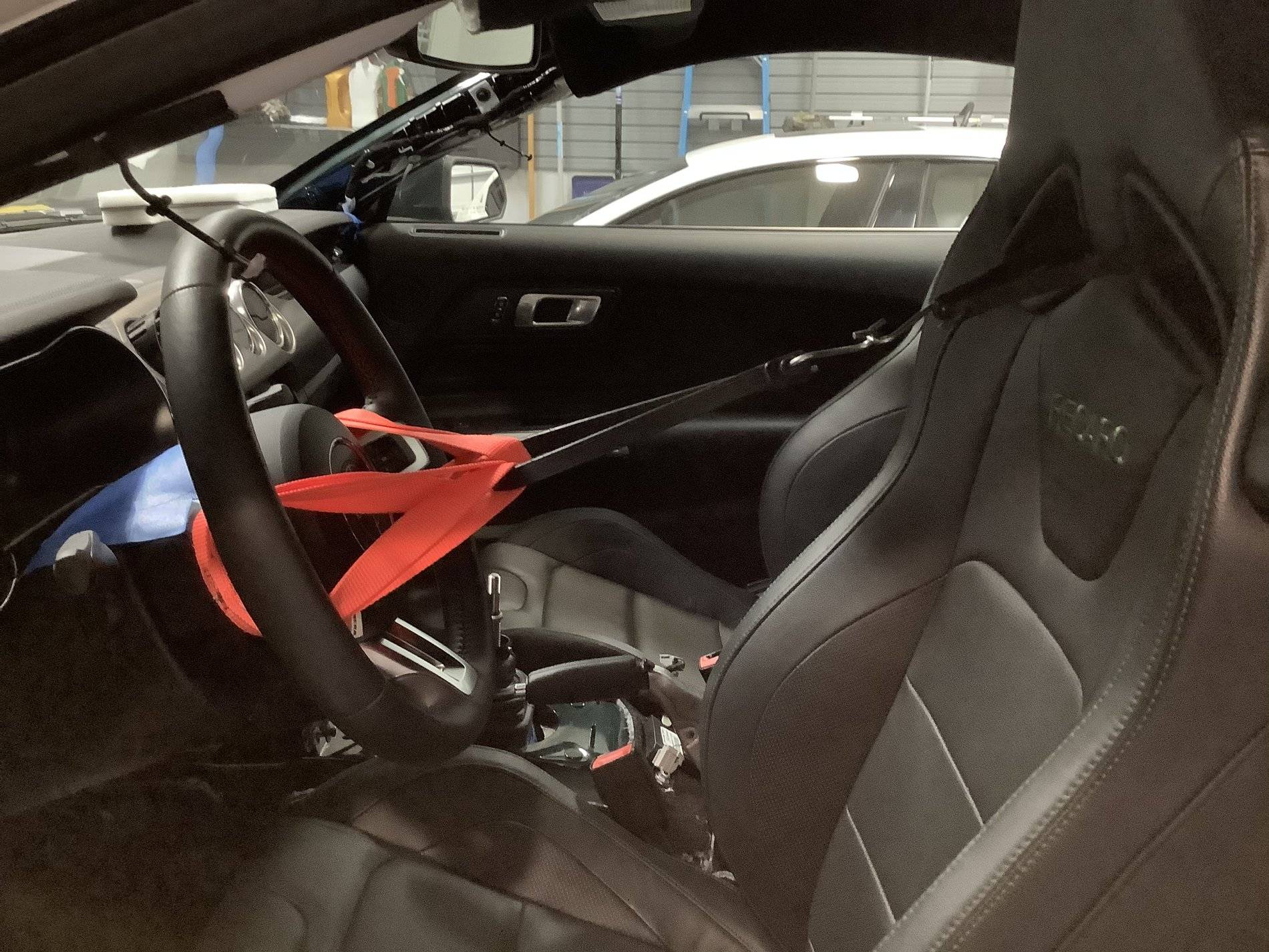

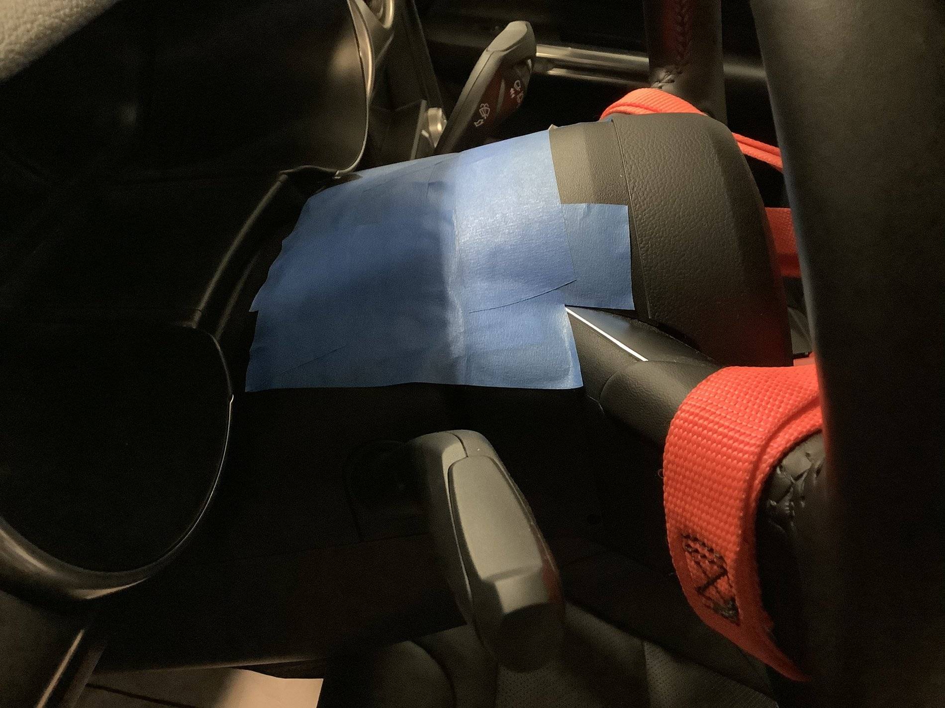

- Tip: Strap the steering wheel in place, so that when you disconnect the steering shaft, the steering wheel doesn't rotate and lose it’s clocked position. I’ve heard that it is really a big deal to correct if you allow this to occur.

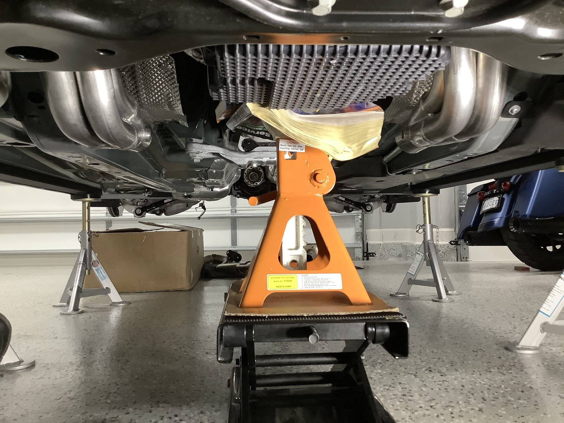

- Support engine and transmission with a jack. I used my scissor jack for my motorcycle (1000 lb capacity) with a tree stand on top of that to gain the necessary height. I also used two old phonebooks, so that the transmission wouldn’t rest directly on the tree stand.
- Remove motor mount plates (accessed top nuts from engine bay with three long extensions and then removed studs and bolts mounting the plates to the engine, followed by the starter last, as this makes accessing the starter bolts easier.

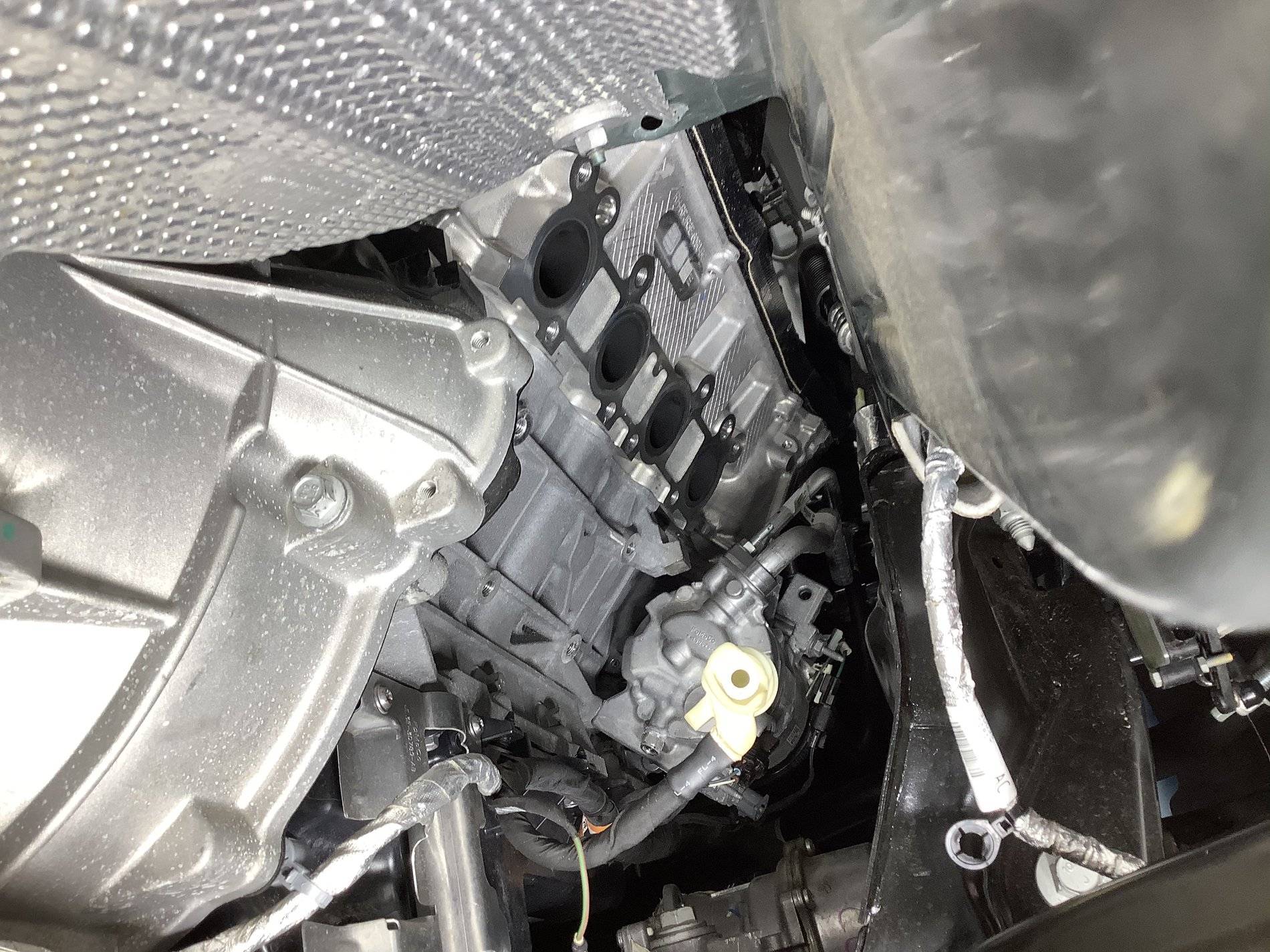

- Tip: Removing all studs made the factory header removal much easier on the passenger side. I struggled with removing it for over an hour before I decided to remove the studs, after which the header came right out.
- Tip: Run a thread chaser (not a tap) through all 16 holes. Note: This is a long and tedious process, but it is very necessary to make sure that the new header bolts go in with ease. The reason this step takes so long is, you have to tighten, loosen and tighten the chaser repeatedly until it is seated. Don't forget to spray the chaser with WD-40 or some other type of lube.

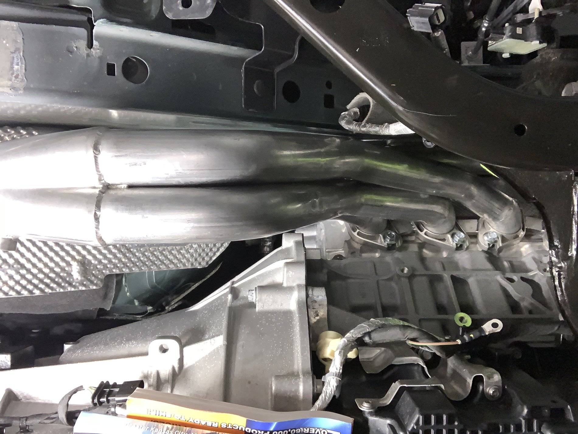

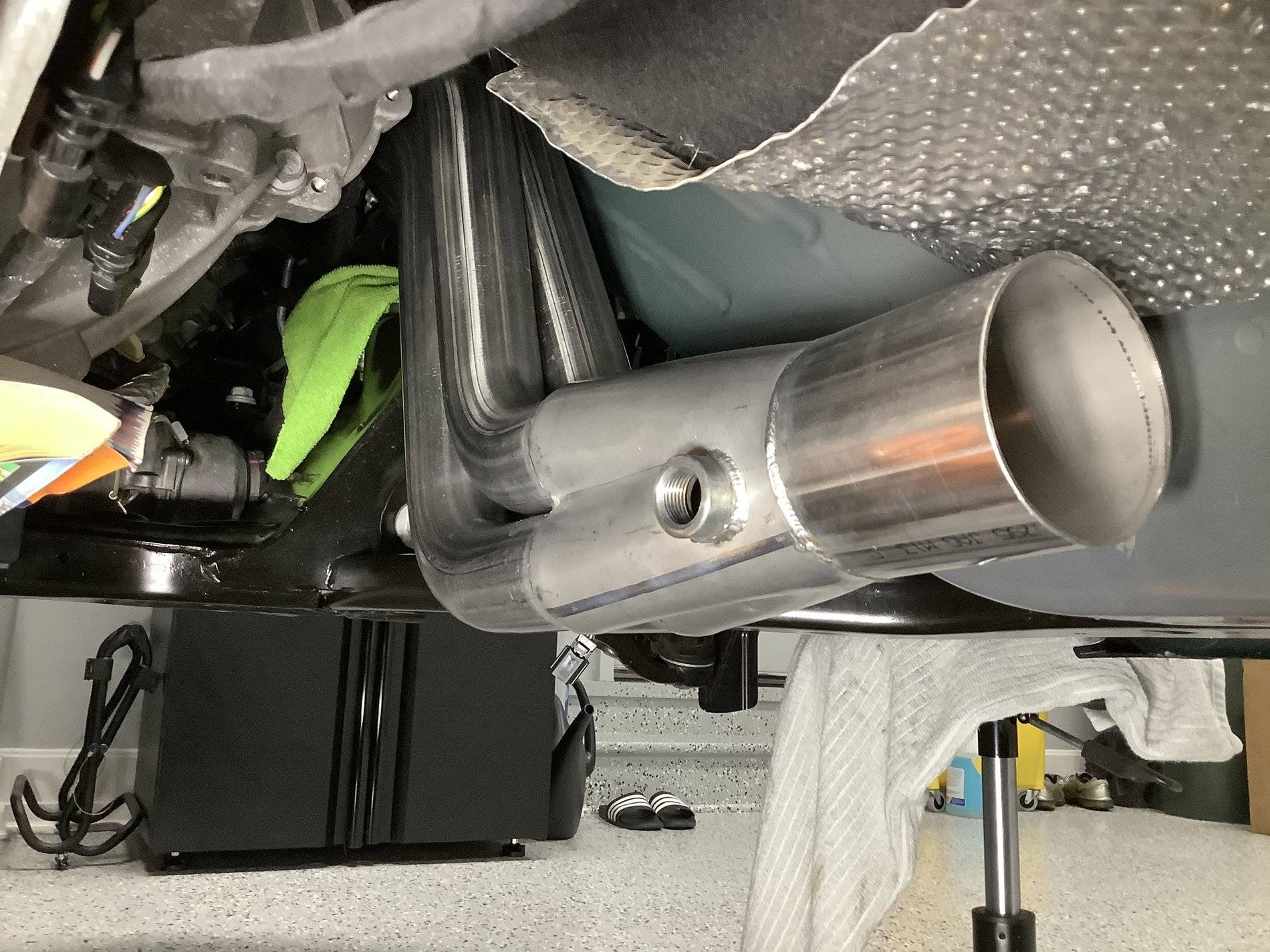

- Installation of new headers was a little tricky. The instructions said to install the four bottom bolts about three threads in, to hang the header off of. This would not work for me. After about 30 minutes of trying, I resorted to installing the most forward bolt and gasket, hung the header on that bolt and then with the rear of the header resting on my head, aligned the rear of the gasket and installed a rear bolt, so that the header could hang without me having to continue holding it. Note: All bolts screwed in super easy by hand only. Once all bolts were in, I used a combination of a 1/4” ratchet, 13 mm socket, short extension and a 13 mm box wrench to snug up all bolts.

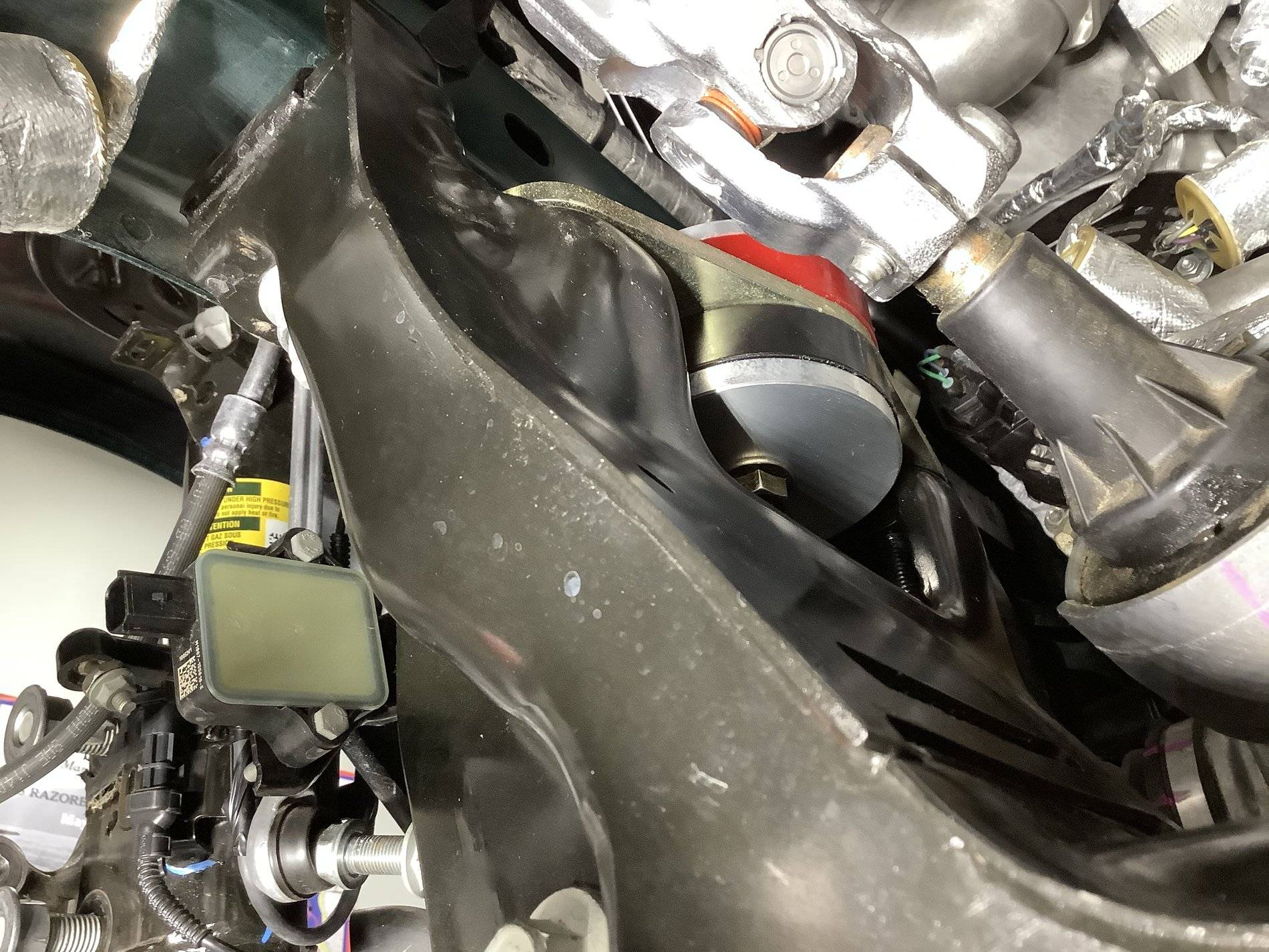

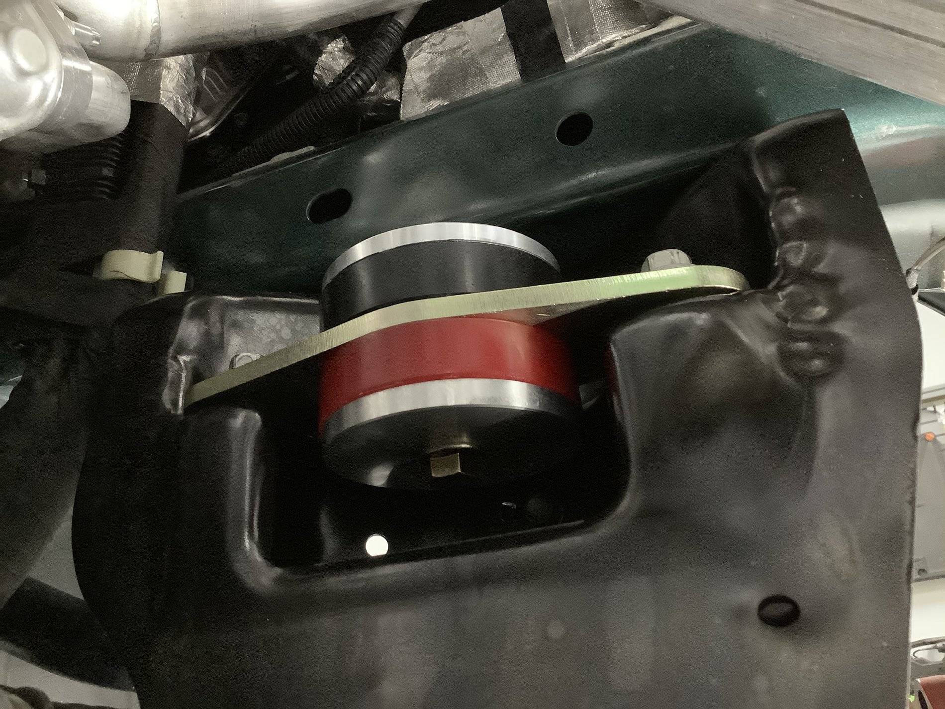

- Running a thread chaser through the motor mount bolt holes also made installation of the Steeda polyurethane motor mount bolts super easy as well. These were torqued from the top of the car via the engine bay.

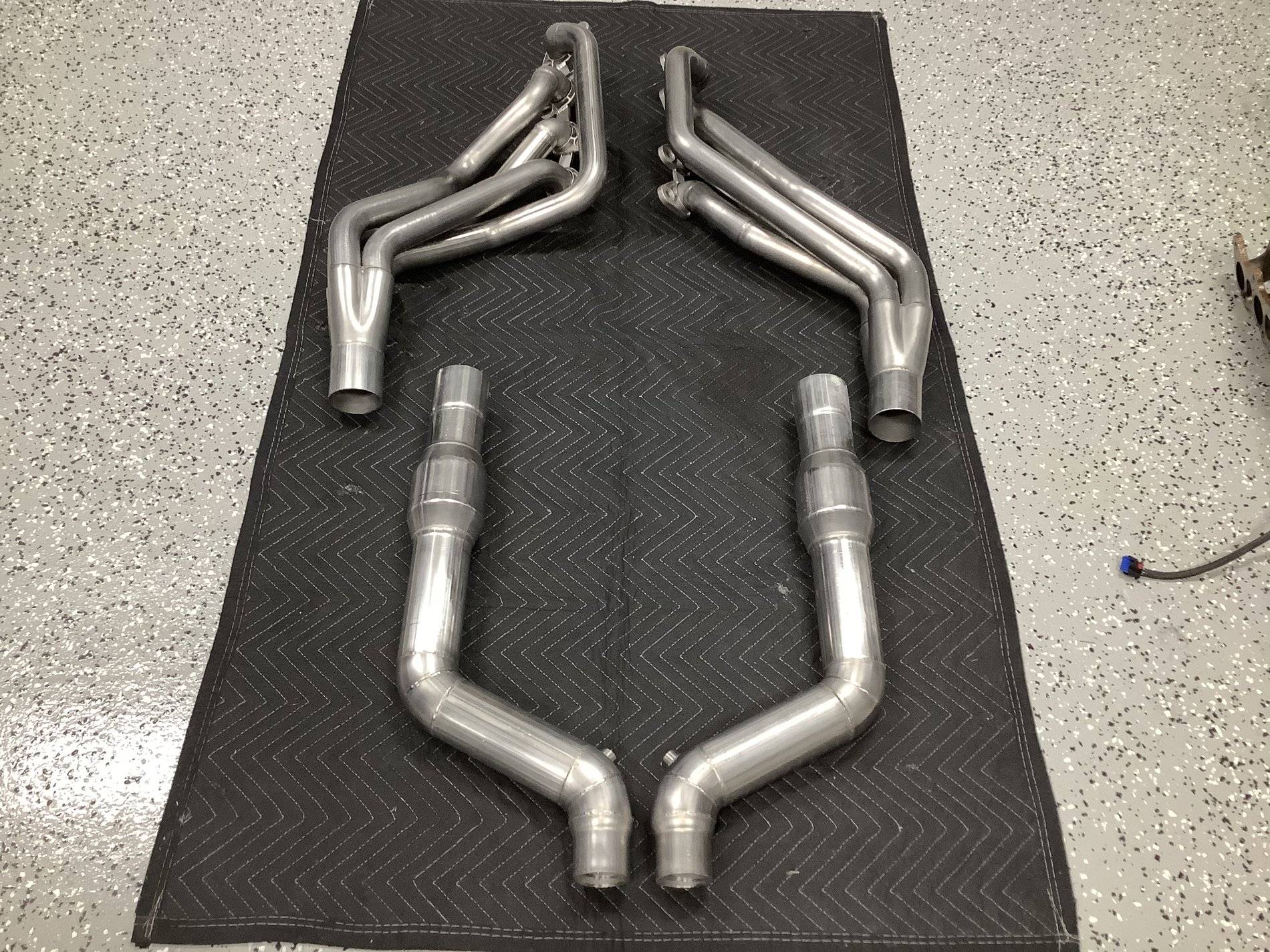

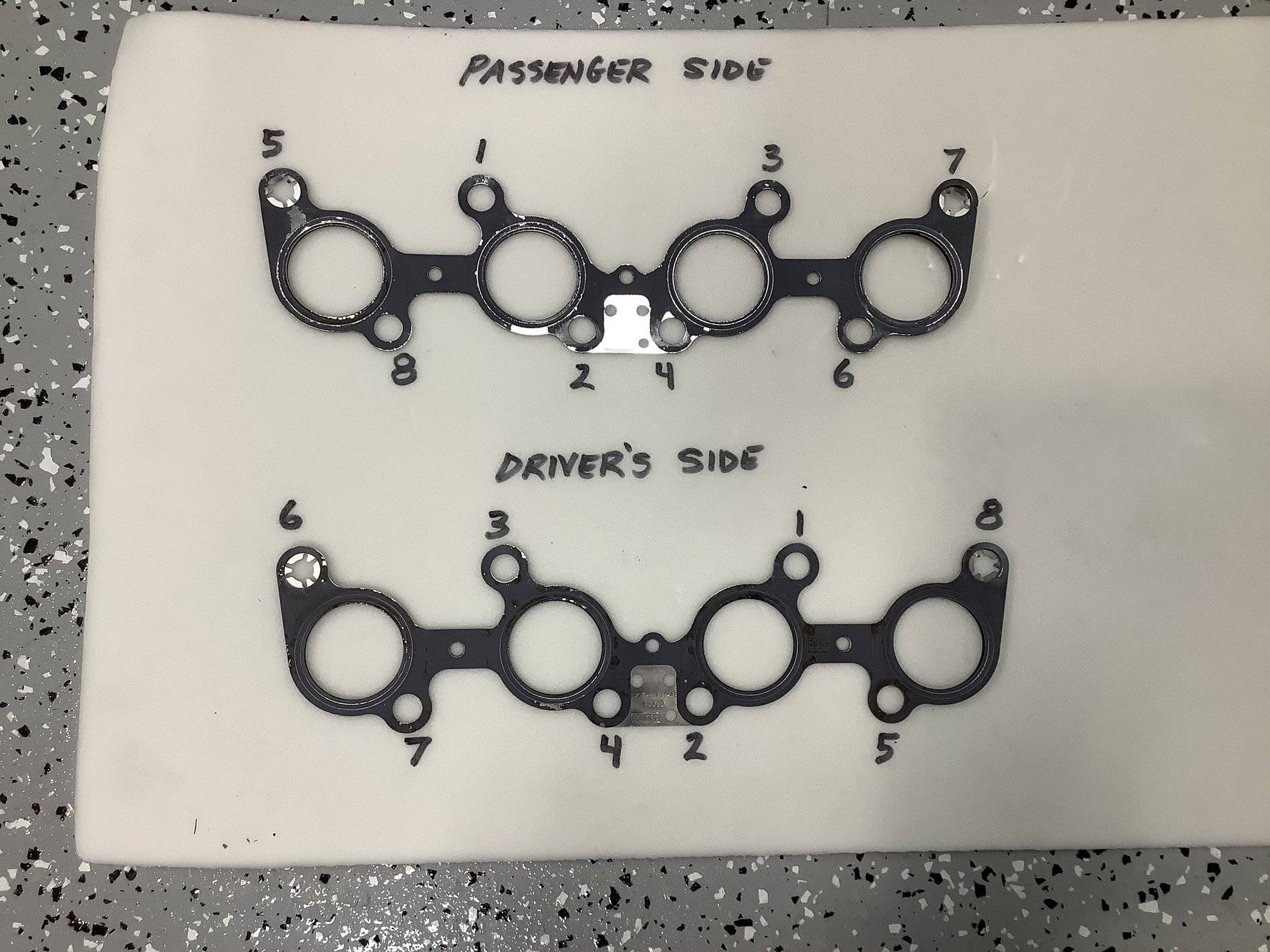

Thanks Chente04! They’re Ultimate Headers. Top tier quality and no fitment issues at all. They even cleared the AC line; was worried that I would have to bend the line like I’ve read about others having to do with certain brands of headers on the S550. I am in the process of torquing the bolts as we speak. The battery died on my shop light, so I’m waiting on it to recharge. So far, I was able to easily get a torque wrench on each bolt except for the rear top and bottom on the passenger side. Still working on the driver’s side and will report back on that shortly. Here is a photo of the torque sequence that I am using.

Thanks Elp_jc! I torqued in two stages. The first stage was 18 fl-lbs and the second stage was 24 ft-lbs. I was able to get a torque wrench on all but #6 and #7 on the passenger side based on the torque sequence pic above and all but #1, #8 and #3 on the driver’s side. I had to use either a 1/4” ratchet and short socket, or a 13 mm box wrench on those.

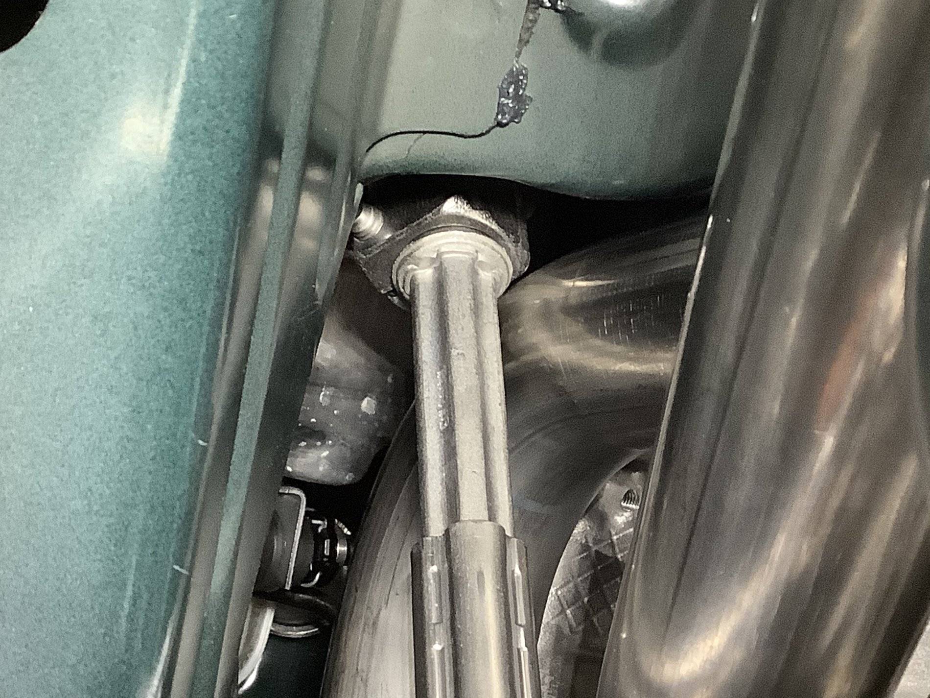

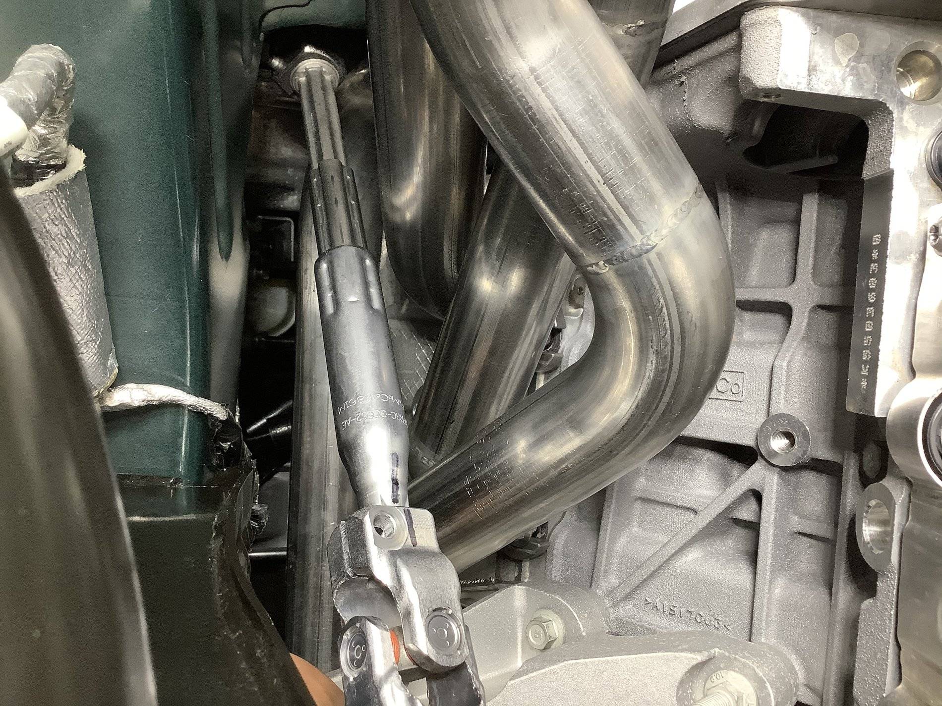

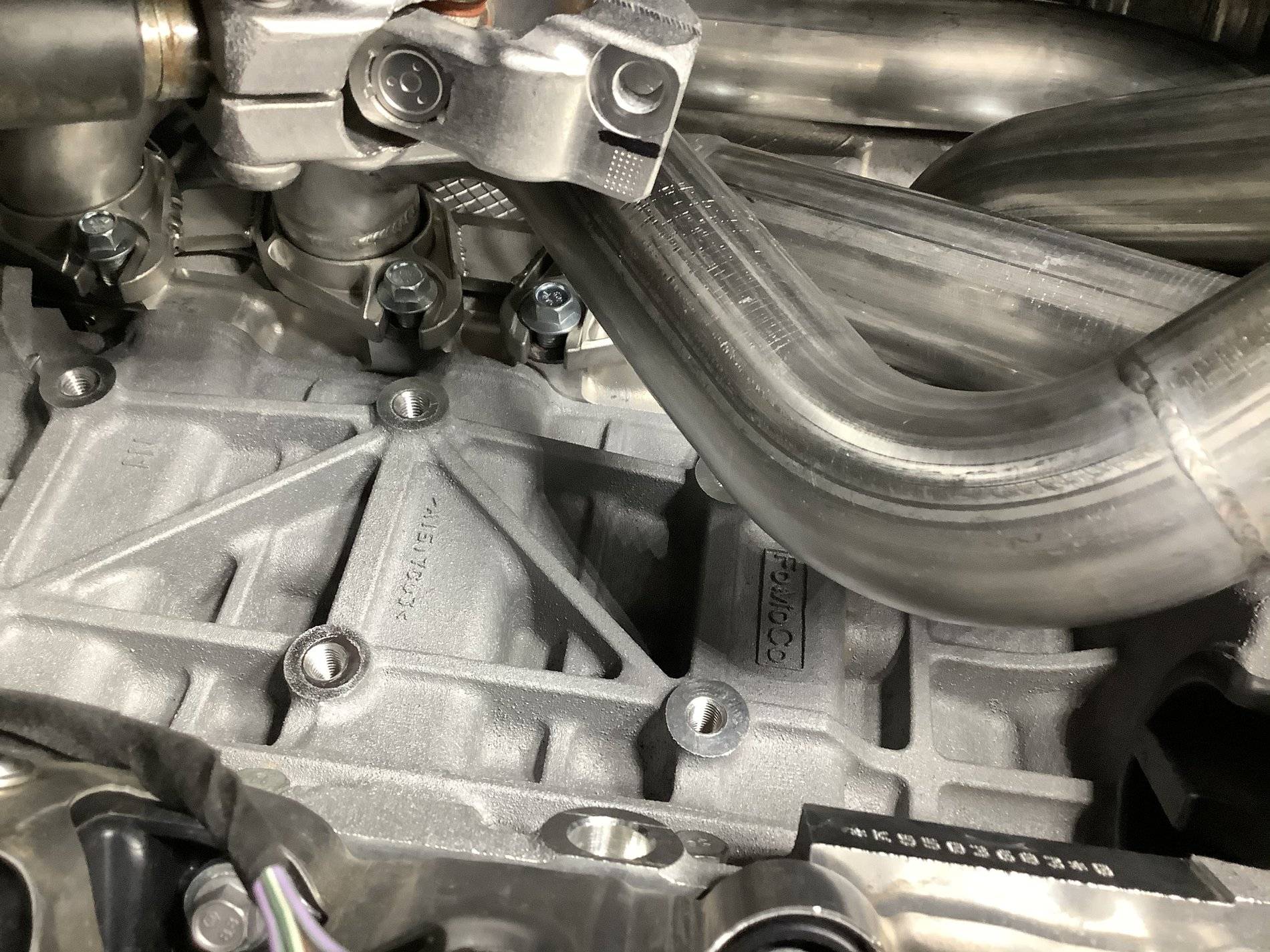

I reported earlier in this thread that I had no fitment issues; well, that was said prematurely. When I said that, the motor was still slightly jacked up in the air and awaiting the install of the motor mount bracket top bolts into the Steeda mounts.
Fast forward to today, I threaded the top bolts into the motor mounts by hand a few turns, lowered the motor and snugged them up to check fitment and everything looked good. Note: The passenger side top motor mount bolt has to be installed and tightened from the bottom, but the driver’s side can be accessed via the engine bay with a few long extensions. Once both motor mounts top bolts were in place, I moved on to connecting the steering linkage and that’s when Immediately noticed that there was a clearance problem. As you can see in the pic, the top knuckle on the shaft, as well as the shaft make contact with one of the header primary tubes. I decided to move on to prepping the rest of the exhaust, while I try and think of the best way to deal with the steering linkage problem.

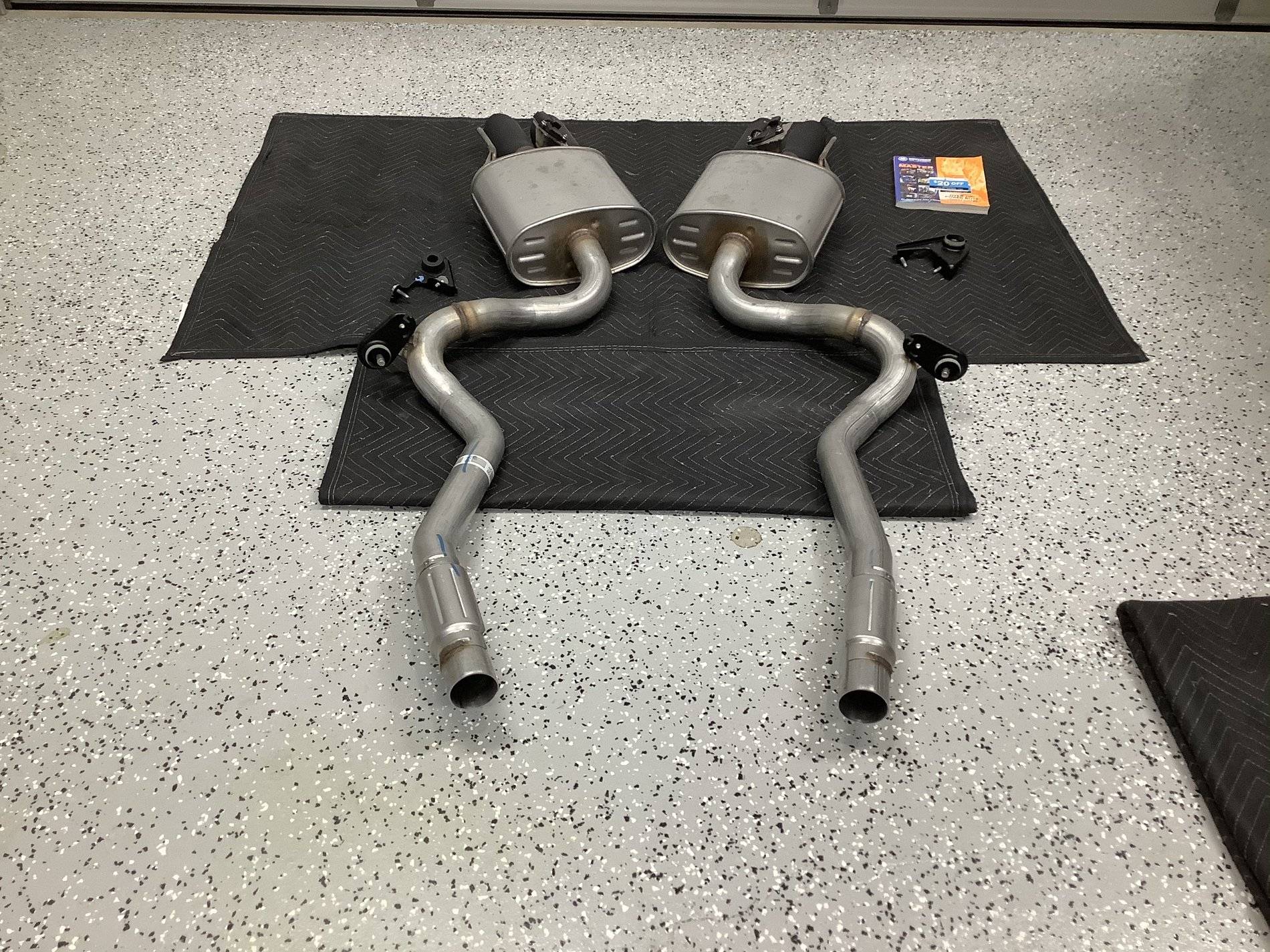

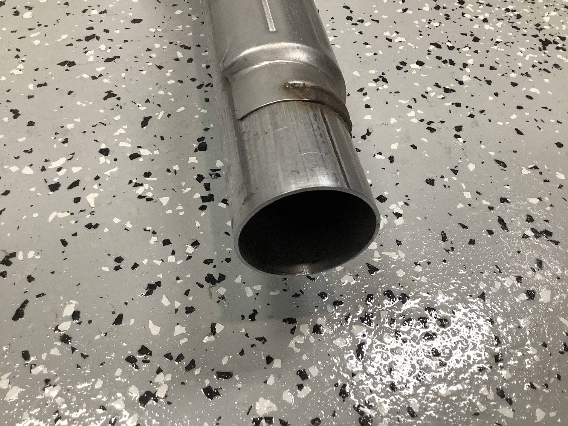

I cut the suitcase off of the factory active exhaust in preparation for installing the Steeda X-pipe. I used a ratcheting exhaust cutting tool to cut the pipes to length and the cuts turned out super straight and clean. I also weighed the factory suitcase and X-pipe. The suitcase was 15.9 lbs and the X-pipe was 9.6 lbs.
