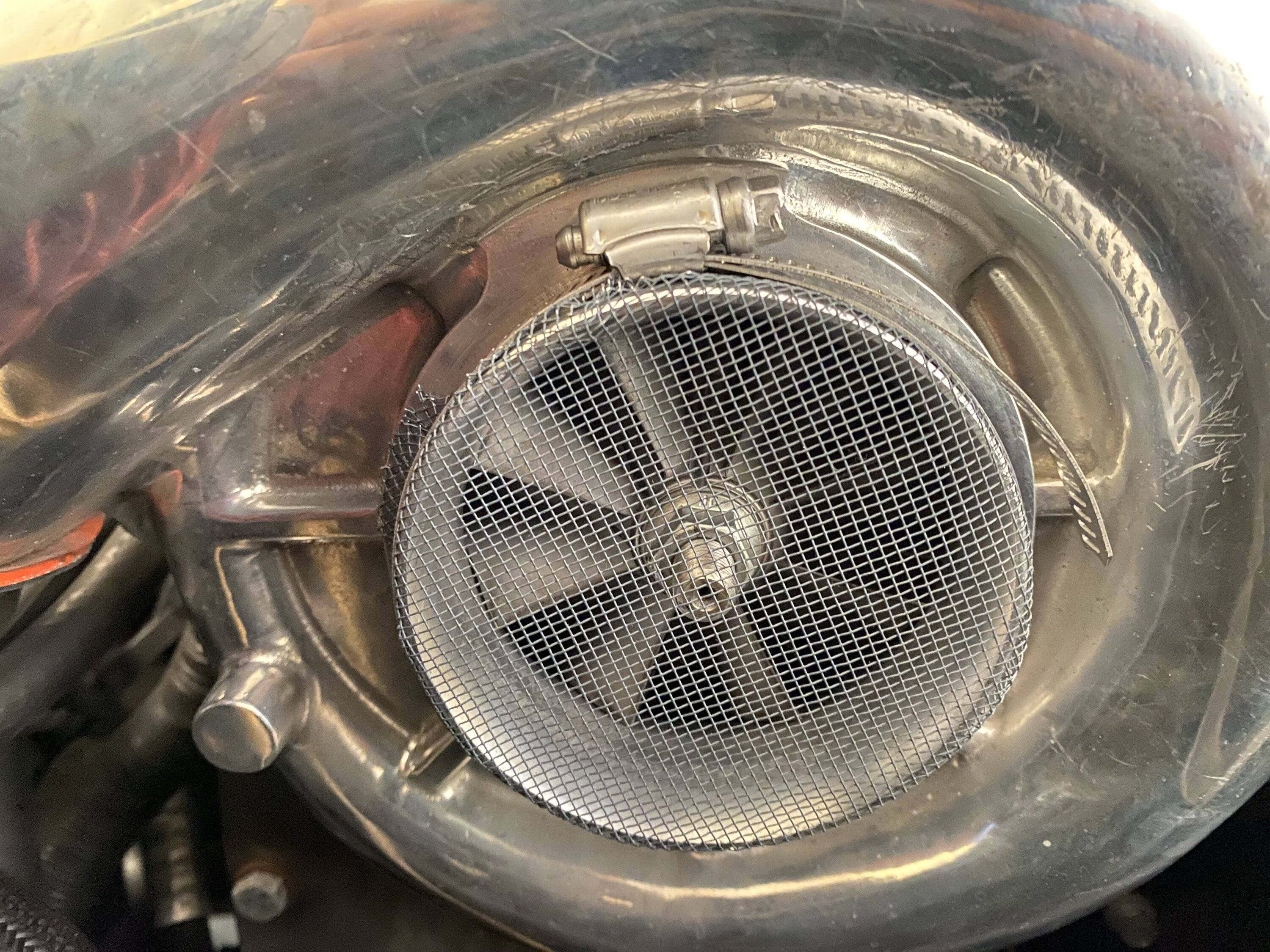

Anybody daily there vortech/paxton or procharger with a turbo guard? Mine just came in the mail and want to put it on but I'm scared something may get sucked into my blower. Small rock or something stupid. Anybody run into any issues? They say the cold air kit for the vortech/paxton cars are restrictive especially at the inlet of the blower. Thanks in advance for your input
Just run a stubby filter for daily use and open blower for racing

I run 2 turbo guards on a low mount turbo system and have 0 issues at all. If anything you might hurt the supercharger/turbo (still rare) but I have a hard time believing anything will actually make it to the motor.

It fits on my vortech JT, no issue.

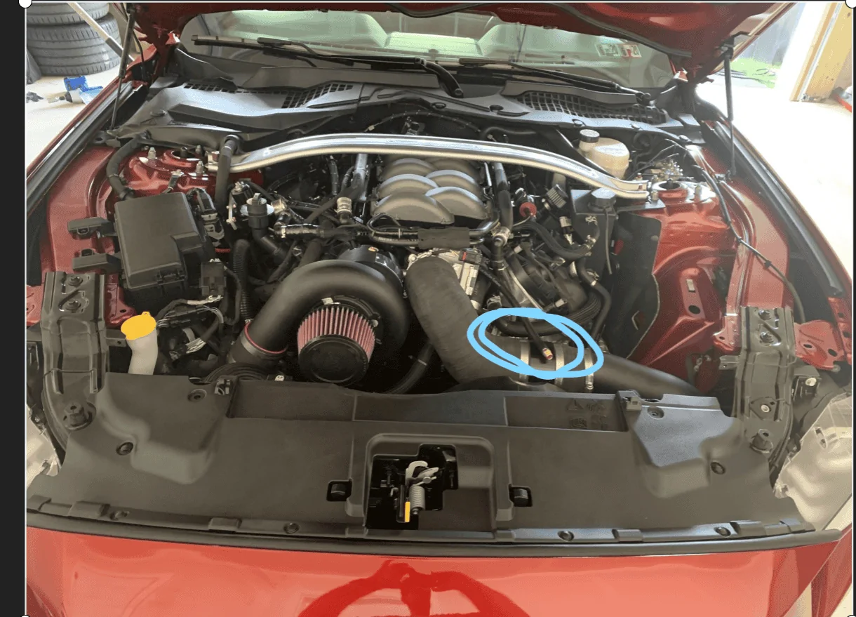

I see that you just vented to atmosphere on valve driver side. But what about the vacuum line that attaches to the intake snorkel? Do i just let it vent out or plug it? See photo below.

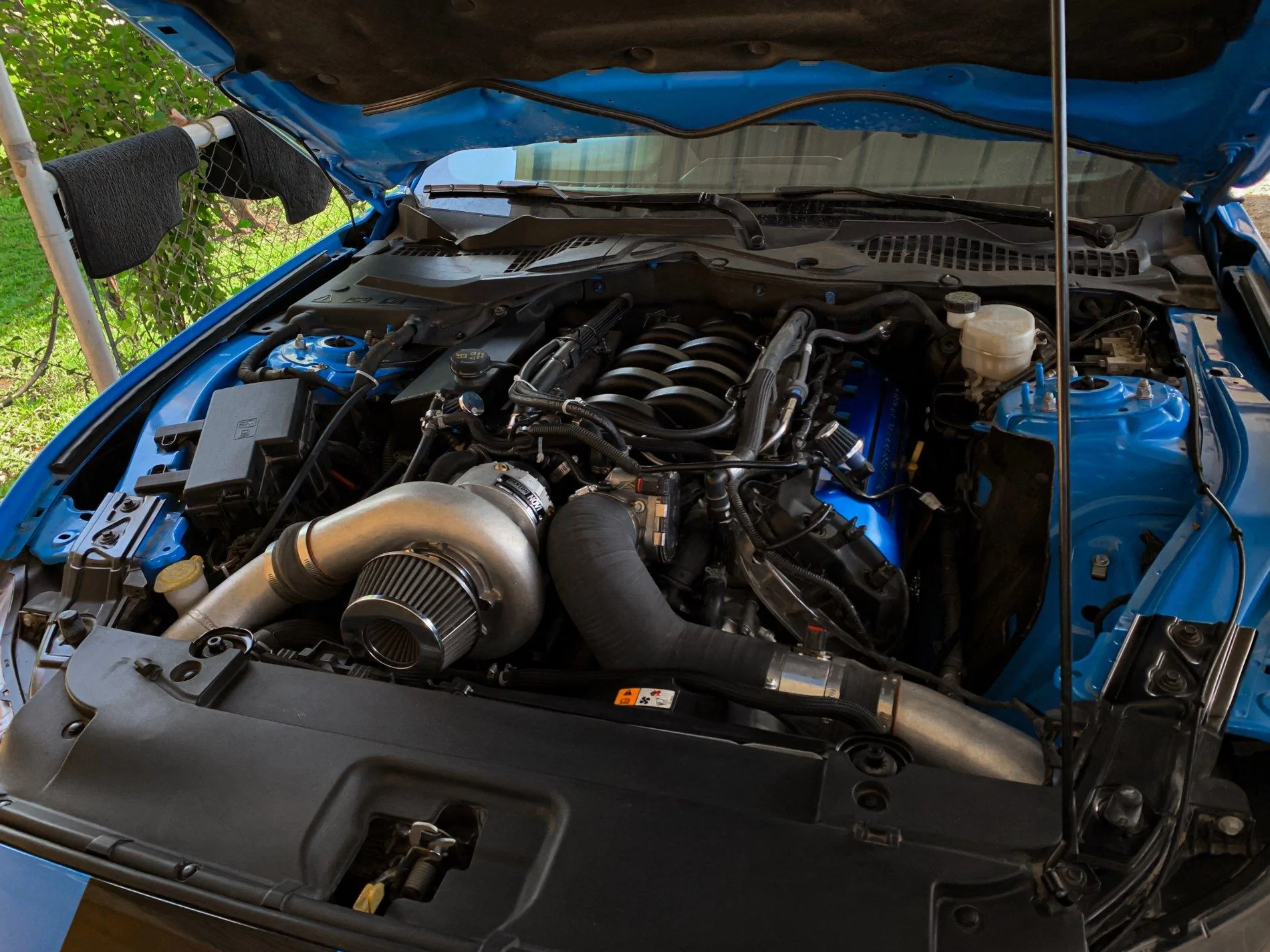

Opening this thread back up. Any issues with not using a filter on the vortech? I just took it off n made a turbo gaurd for it...

Yea, sucking shit in and damaging your blower. Not a good idea for normal driving, imo.

I could see dust being a factor for sure.
Aesthetically, almost looks better without the filter

Ran mine almost exclusively on a guard for 3 years no issues. If you live where there’s lots of dust run a filter for daily use . But it won’t hurt if you leave it on there a few days

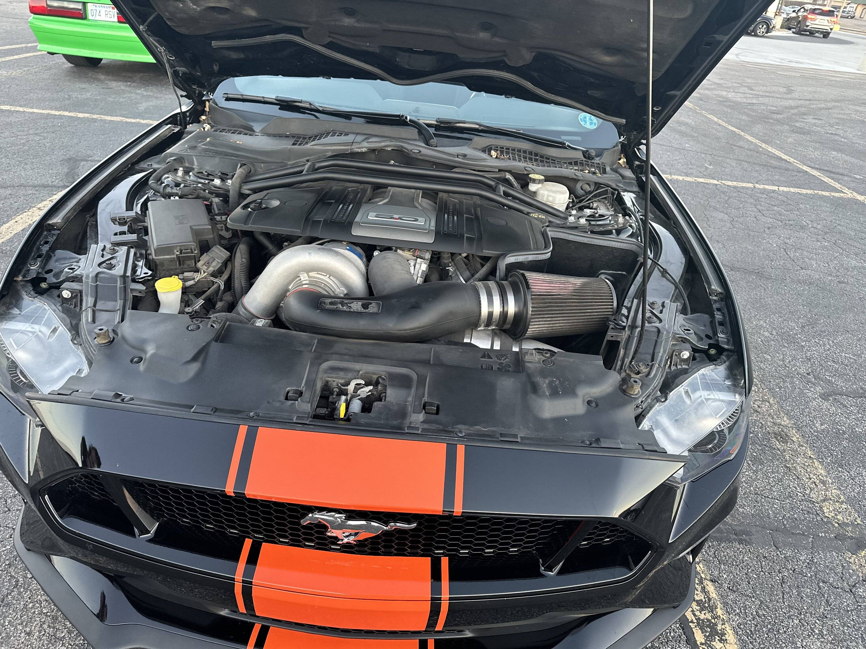

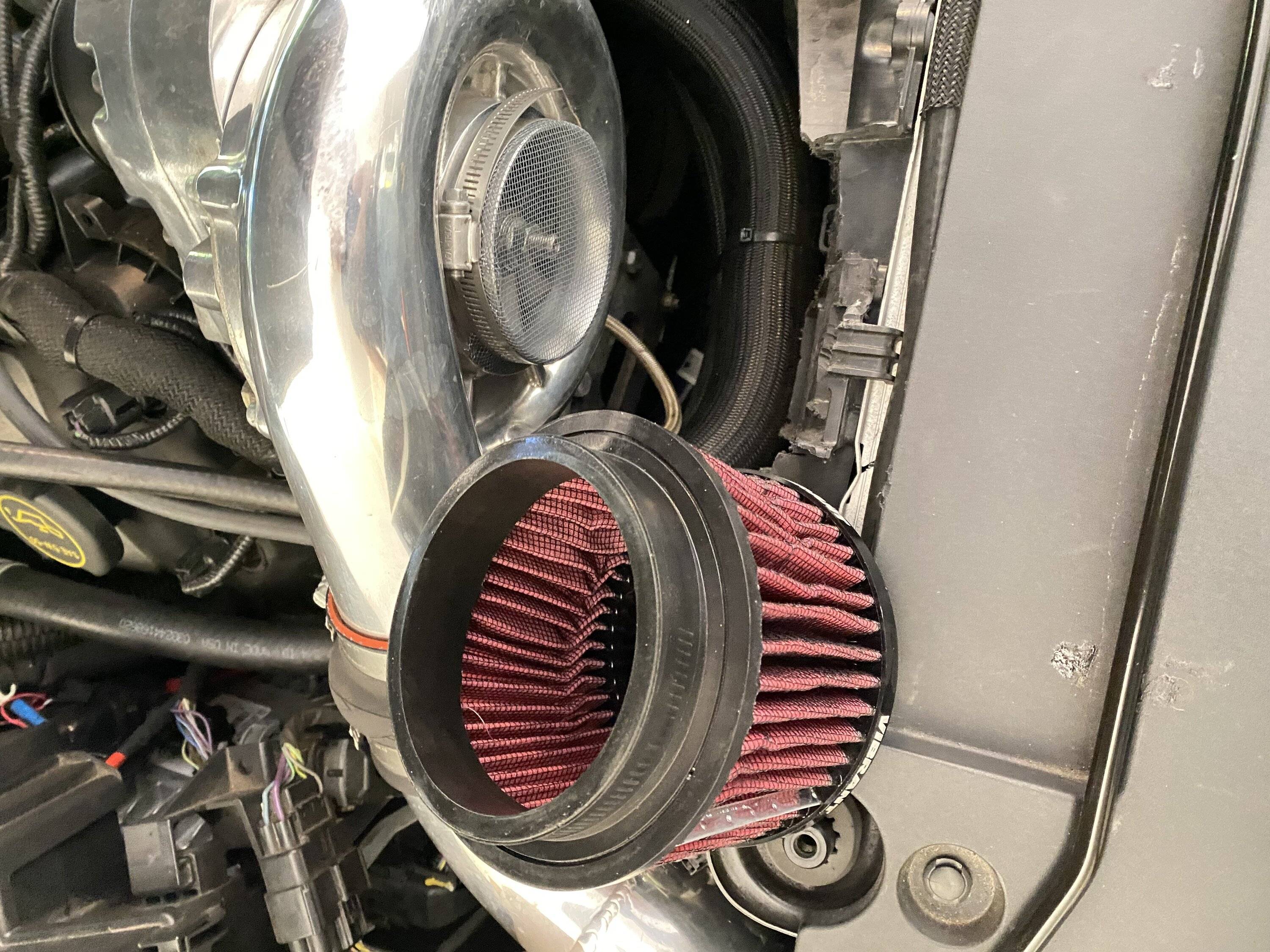

I’m looking at all these set ups cause I was curious about the turbo guard. But at looking at everyone’s set up mine looks totally different. I have a jlt filter installed where the turbo guard would go. I just figured it was my cai. I had mine installed at Shelby killer performance. Would it be better if I removed the filter and just use the short one or just a guard?

It does but it only has about 3k miles on it. In about another 1k I’m going to clean and oil it. But can you see how my setup looks totally different than the OP. Would I get more hp if I removed it and went the way the op did?

You have a point. I don’t daily drive it but I do drive it quite a bit. But I don’t have any desire to ruin my engine. Those things are expensive. Plus I have construction going on all over my city. But I’m not willing to sacrifice my ac either. I’m just going to add some headers and after I get my drive and half shafts done I’m gonna go e85 after I get a triple pump. I’m trying to get 850-950 and that should do it.
