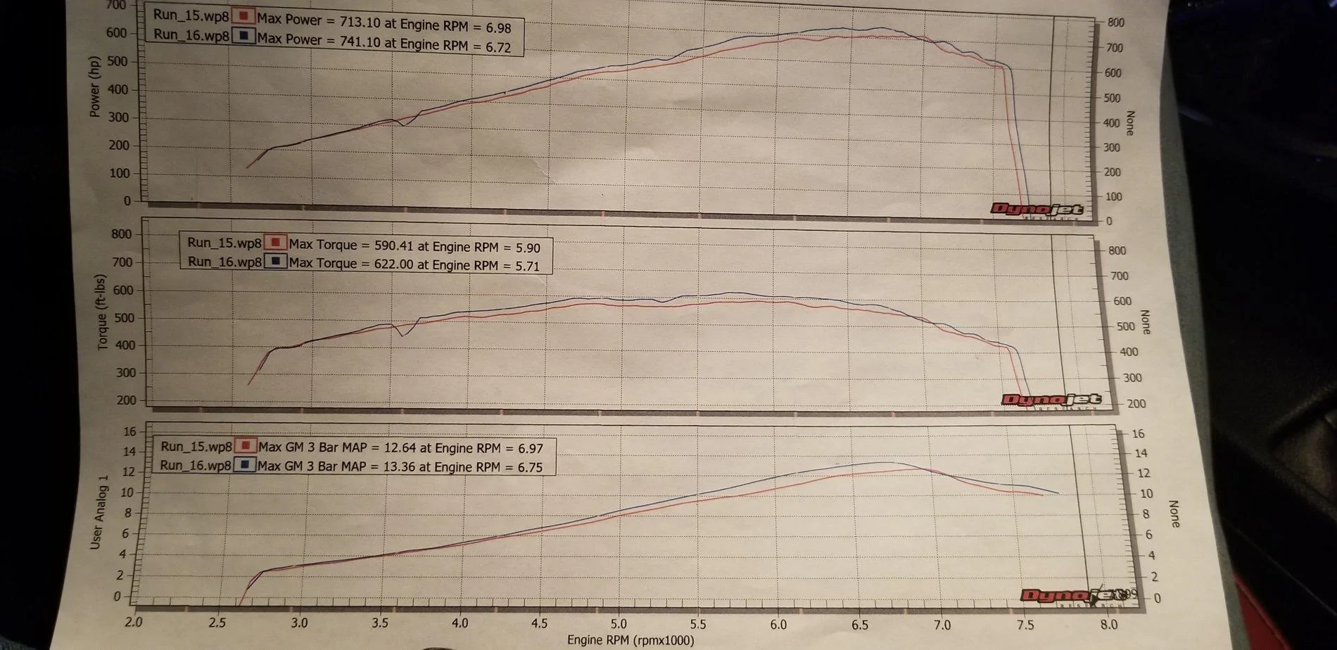

What do you guys think? Boost is still dropping off at high rpm. I adjust the boost controller. It helped but still dropping. Thinking about getting rid of this wasgate system all together. It's not holding the boost. 741 hp had a a gallon of 110 fuel with the cold air pipe off. 713hp is 93 with the cold air pipe on
