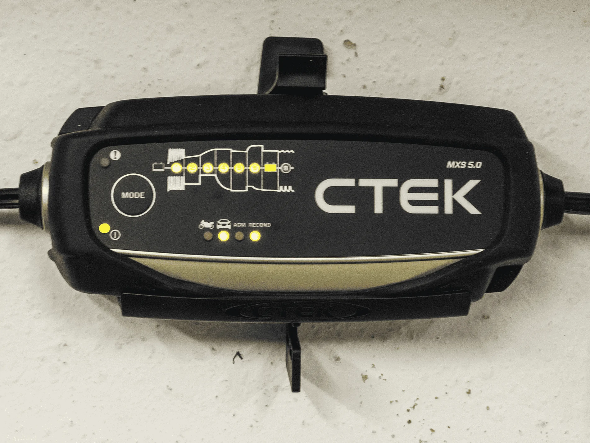

Question. I have the battery charging now. Can I run tune while charging?
positive cable is disconnected for charging purposes. Thanks.
-J
Nevermind. Figured it out

Leave the positive cable hooked up to the battery. Attach the chargers positive cable to the battery cable and the negative cable to a chassis ground, the one on the drivers side shock tower will work.
