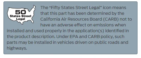

Thug,
I was looking at the Ford tune, The only thing that scares me is it is legal in California... LoL...
