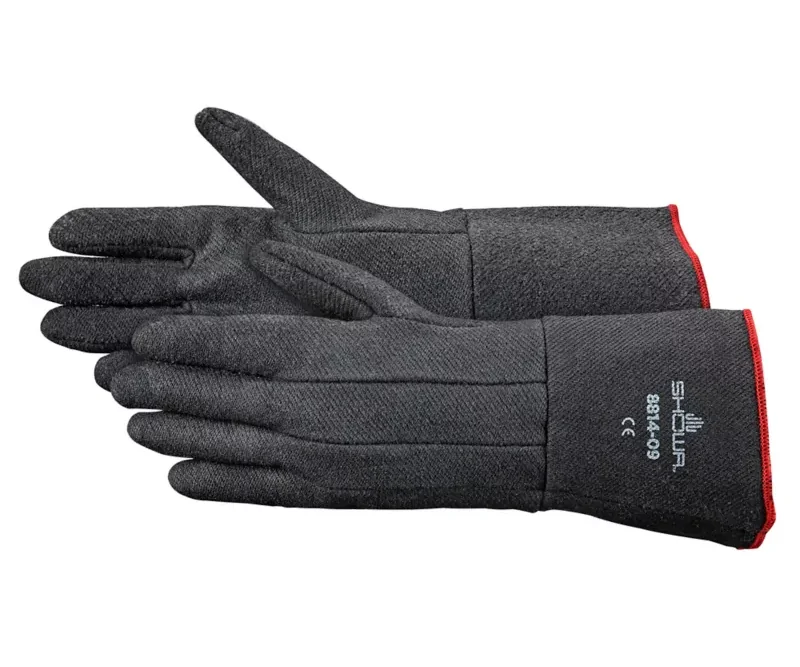

The hardest part doing the 10R80 is getting it up to 208 degrees so the fluid expansion is correct for the level check. I added a PPE deep sump pan to the F150 which has a drain plug, so that make it a lot easier to drain it(and cleaner/less messy) as well. It also helps to get a pair of gloves for grills so you don't burn your wrist/arm when checking the level as the fill port is right there next to the cat on the auto. Pan gasket is reusable, so be careful when you remove the pan to swap out the filter to not damage the gasket. Me and my buddy have done ours on the trucks and it isn't that bad. Same for the diff-

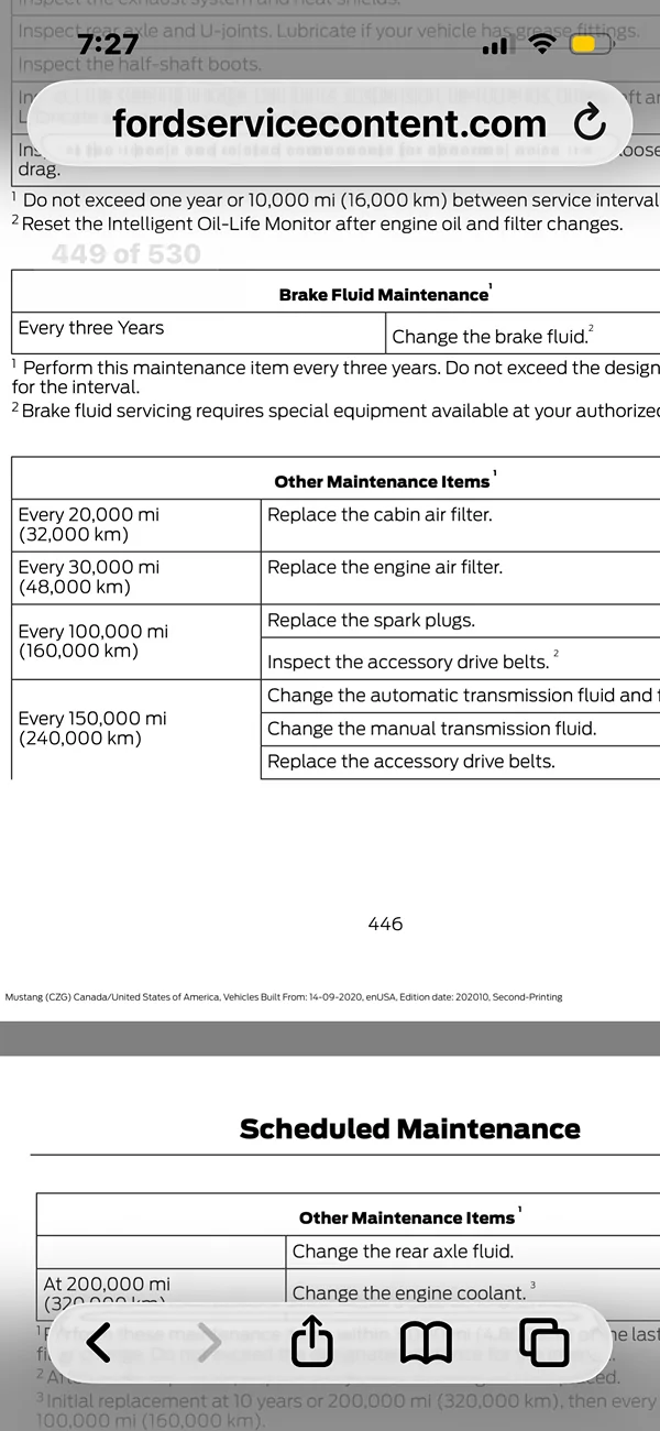

I’m at 80k on my daily 10R80 21GT and have been thinking about changing the trans fluid even though there’s no problems. Then I looked at the maintenance schedule in the owners manual and it’s says change at a 150k…I’ll probably wait till I get to a 100k.
For transmission fluid, I always go by the rule of half of whatever manufacturer says, so instead of 150K miles I would do 75K miles or so. If you drive the car hard, or track it, then I would do it even more often.

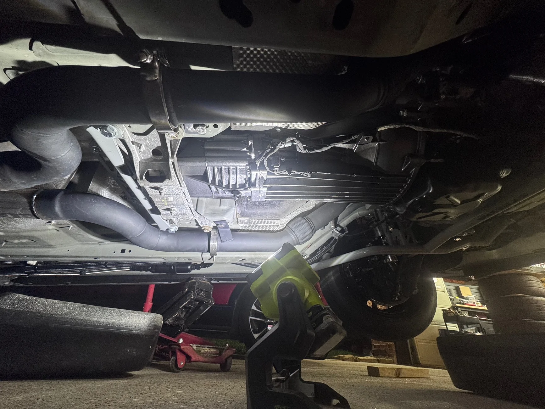

I did mine, getting it level wasn’t the end of the world. But what drove me through the roof was my pump. The one I had the hose was too big to get in very far so too much was spilling out. Then I buy a different one at Autozone, the tube was perfect, but halfway through the bottle the pump portion fell to pieces. So I ran back to Autozone and they only had the same pump and thought maybe it’s a fluke and I got a bad one. So bought the same thing and ran home.
Put the cheap pump on and started again, 3 pumps in and it falls apart…… Took the spring out of the pump and manually worked it and it worked as it should, just not as designed.
I told my wife, I’ve never in my life had so many problems changing trans fluid. She said why didnt you pay someone else to do it…. If I can do it myself, I’m going to do it and do it right.
