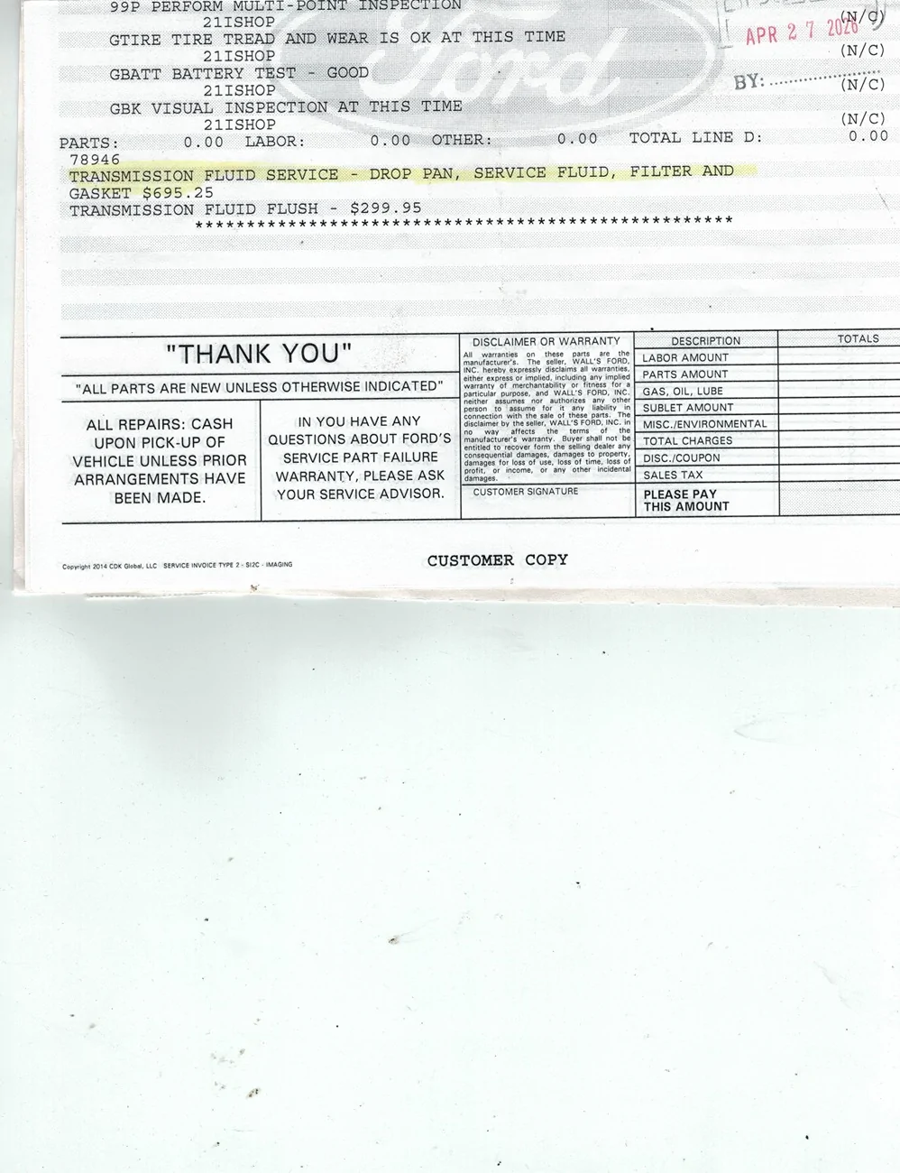

I was recently at the dealer for an oil change and inquired about getting the transmission serviced. They quoted me $695 to drop the pan and change the fluid, filter and gasket @ 2 hours labor and $300 to flush. Theres a performance shop not far from me that does my alignments, so I'll get a quote from too.
Ridiculous! It's quick and simple to drop the pan and install a new filter, especially if you have access to a lift instead of lying on your back and spilling oil on yourself. The gasket is a controlled compression design that's reusable so they've baked in a ton of profit plus the flush is outrageous since most of the fluid is already drained and has to be replaced, anyway. (The residual oil in the torque converter and cooler circuit is fine if this is just a routing maintenance oil/filter change.) The biggest challenges for doing it yourself is not making a mess draining the oil from the loosened pan and getting the car level and accessing the fill port to tweak the proper level at operating temperature. If you're not equipped or comfortable doing it yourself, find an independent shop that won't rip you off, maybe even purchase your own authentic Ford/Motorcraft filter and eight quarts of Mercon ULV (stick with OEM branding) and pay a fair price for them to do the labor?
