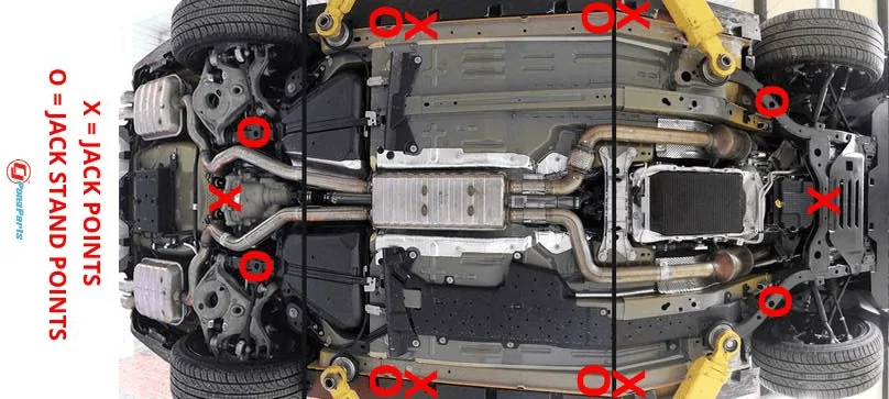

Are there really solid jacking points on these things/ Should I worry about body lip damage etc anything like that?
I'm not going to have a lift as I'm renting a condo for the next year, year and a half so will have to be stands and jack's unfortunately for now. . .

A set of race ramps make changing the oil super easy. Ii bought a set, they are not cheap, but speed the process up.

Look into getting some jacking rails, makes life easier, IMO.

These are awesome Steeda Chassis Jacking Rail Ultra-Lite.
I roll up on ramps as well (8") before jacking the car up. My driveway is new. I found these DRICORE Subfloor Membrane Panels work great under the jack and stands to protect from sinking in.
Plywood would work fine. I bought these as a gap between the garage floor to park on while storing for the winter.
