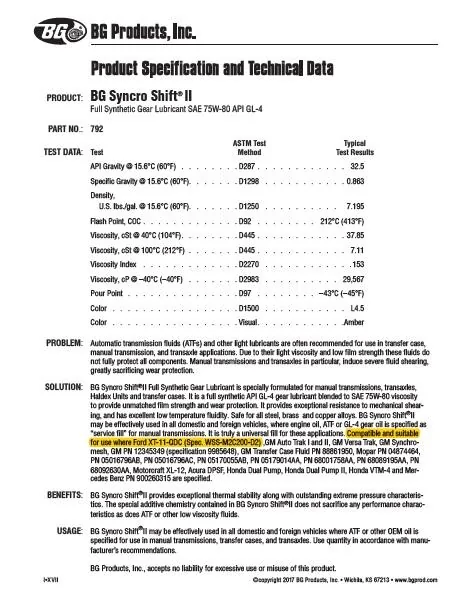

No problem. I emailed op mustang last night too and got back a good response. Here it is.
Good Morning Kevin,
Tremec used to qualify the transmissions on a Manual Transmission oil (GM Syncromesh). Since they have become an OEM supplier they qualify all the transmissions on ATF for cost and efficiency. ATF is a poor choice of oil in a transmission with gears because it offers minimal shear protection..
Syncro Shift is designed to replace ATF's and many other fluids used in modern transmissions. We have attached the BG Spec sheet on BG Syncro Shift II. Customers have been using it in the GT350 since the car was released. Typically it will it operate cooler for longer track sessions and also helps remove gear nibble.
JAJ
Apr 9, 2016
2,232
1,987
Vancouver BC
2016 GT350 Track Pack
The old Borg Warner T5 manual transmission from the 90's was built to use ATF, and when Tremec bought the manual trans division from Borg Warner, they kept on using ATF as the lube fill for Tremec transmissions. That's the origin of the "ATF in a manual" story. That doesn't mean that manual trans fluids don't work in Tremec transmissions, it just means that you can use an ATF (that's generally a lot cheaper than an MTF) and your transmission will work properly.
From looking at the BG data sheet, it looks like an MTF that's intended to go in gearboxes spec'd for ATF's. Royal Purple Synchromax is the same - an MTF for ATF gearboxes.
