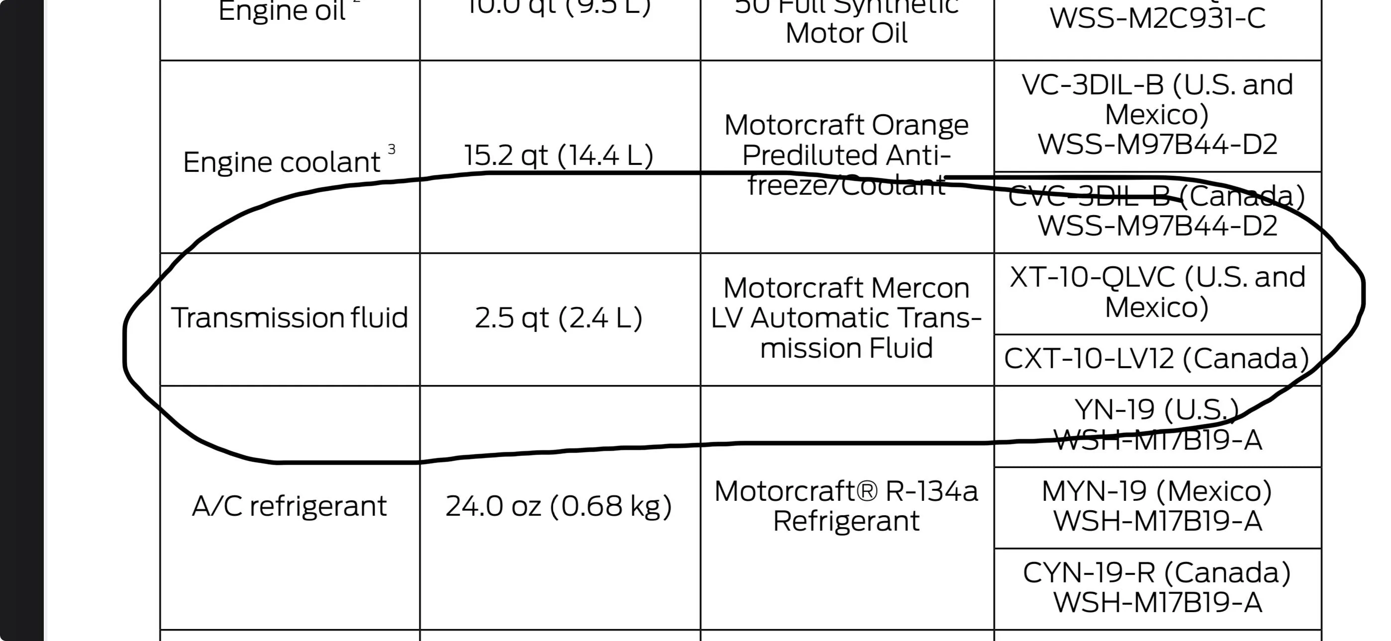

Where are you getting that? The manual calls for MERCON LV. Is that not an ATF?
Mercon LV is for the automatic trans cars. You must have just read the wrong section.
I believe in the past LV was used for everything, but now it's a DCTF fluid for the manuals.

Then I’m forced to ask how one may interpret this properly from the owners manual…
Must be a really old manual if it specs motorcraft orange coolant, haha. What year is your car exactly? And where did you find this manual? As I said, LV was used in the past, so now I'm really curious

It’s a ā€˜17, and this is directly from the 350 supplement. Did the tranny fluid change in later years?
