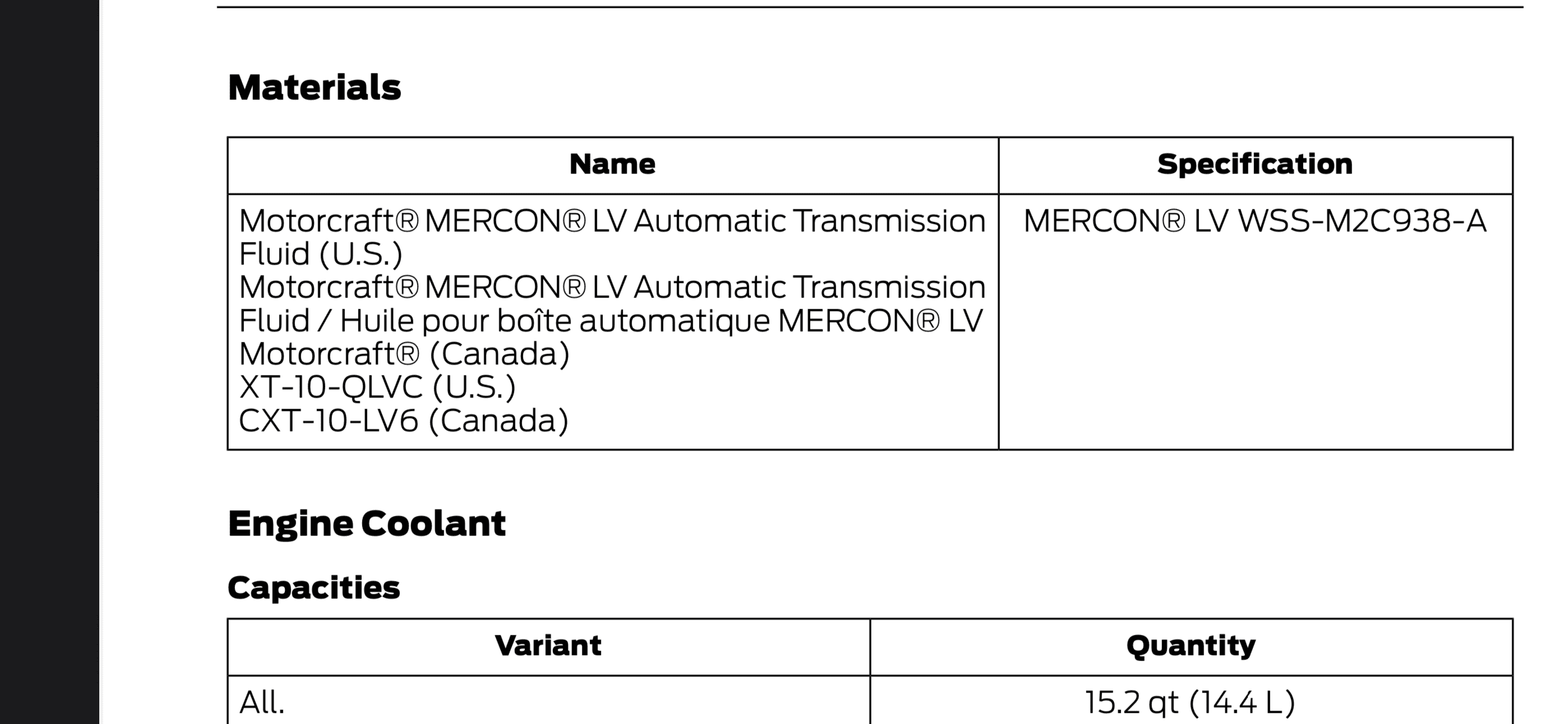

Disregard…found the page from the ‘20 350 supplement. Tranny fluid is unchanged.

It’s a ‘17, and this is directly from the 350 supplement. Did the tranny fluid change in later years?
Oh no wonder, this is a GT350 we're talking about lol. Sorry, not my best day (didn't even notice this was in this section, I'm dumb). You are correct with that spec for the Tremec.

Mercon LV is for the automatic trans cars. You must have just read the wrong section.
I believe in the past LV was used for everything, but now it's a DCTF fluid for the manuals.
Mercon LV is also the spec for the 3160 tremec. This is why I went with the redline fluid because it has a slightly higher viscosity. Mercon LV is like water

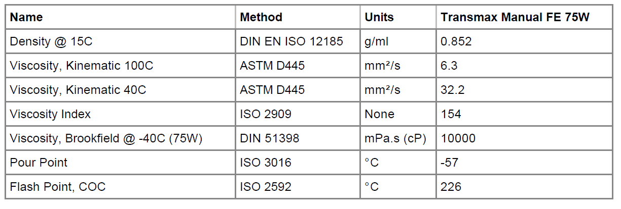

Ended up finding the spec sheet for XT-11 but it only gives cSt at 40°. Guess you can compare that number as well to other fluids, I just liked using 100°.
Here's the datasheet for the Castrol fluid that meets the WSS M2C200 D2 spec:
The datasheet's introductory paragraph includes this phrase:
"It is approved for use where Ford WSSM2C200-D2 is specified"
The table above has more detail in it than the Ford WSS spec but where the Ford spec has numbers, they're the same as the ones in this chart.
