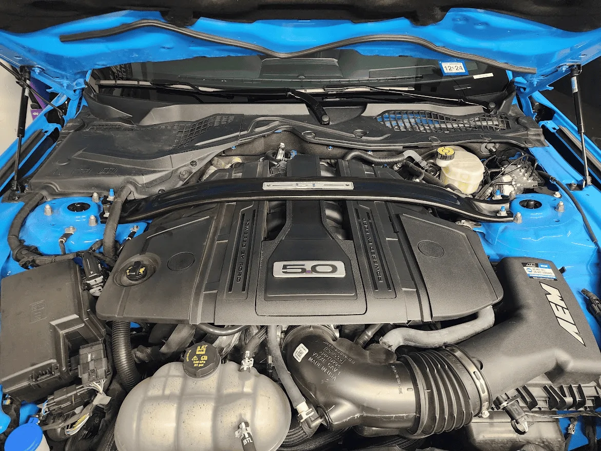

There's a vendor selling lightly used take-off GT strut braces for 50 bucks on Ebay. Has a ton of them. Evidently a supercharger installer pulls them off (top mount superchargers don't leave room for the bar). I got my 50 dollar one mostly for looks. I don't have the K (cowl) brace, because my car is a base GT and I just didn't want to pay $250 for a piece of metal that probably does nothing and is invisible (hidden under plastic cowl). So, I got the cheap (lightly) used brace. I did have to order some nylon spacers on Amazon to get the driver's side of the brace to set properly level due to me not having the K/cowl brace.... If you want more info let me know. I just did this a couple of weeks ago.
Edit: I'll just add the info.... You need this for $50 + 25 shipping:
https://www.ebay.com/itm/196385227146

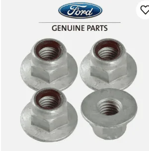

Next, you need two (not 4, your car will have two of them) nuts that look like this... You can get them from your local Ford dealer for like 67 cents each. Do not order them online... they are out of their mind. You could also go to a good hardware store (not Home Depot), but if you want the exact ones, Ford dealer has them. Part #
W712334-S440 (don't pay eBay rip-off artist prices, go to your parts counter)
Then, I got these Nylon spacers. I think I ended up using the thinnest one. Either way, something convenient to keep in your toolbox. https://www.amazon.com/gp/product/B099HLBT3X/ref=ppx_yo_dt_b_search_asin_title?ie=UTF8&psc=1
Final product:
