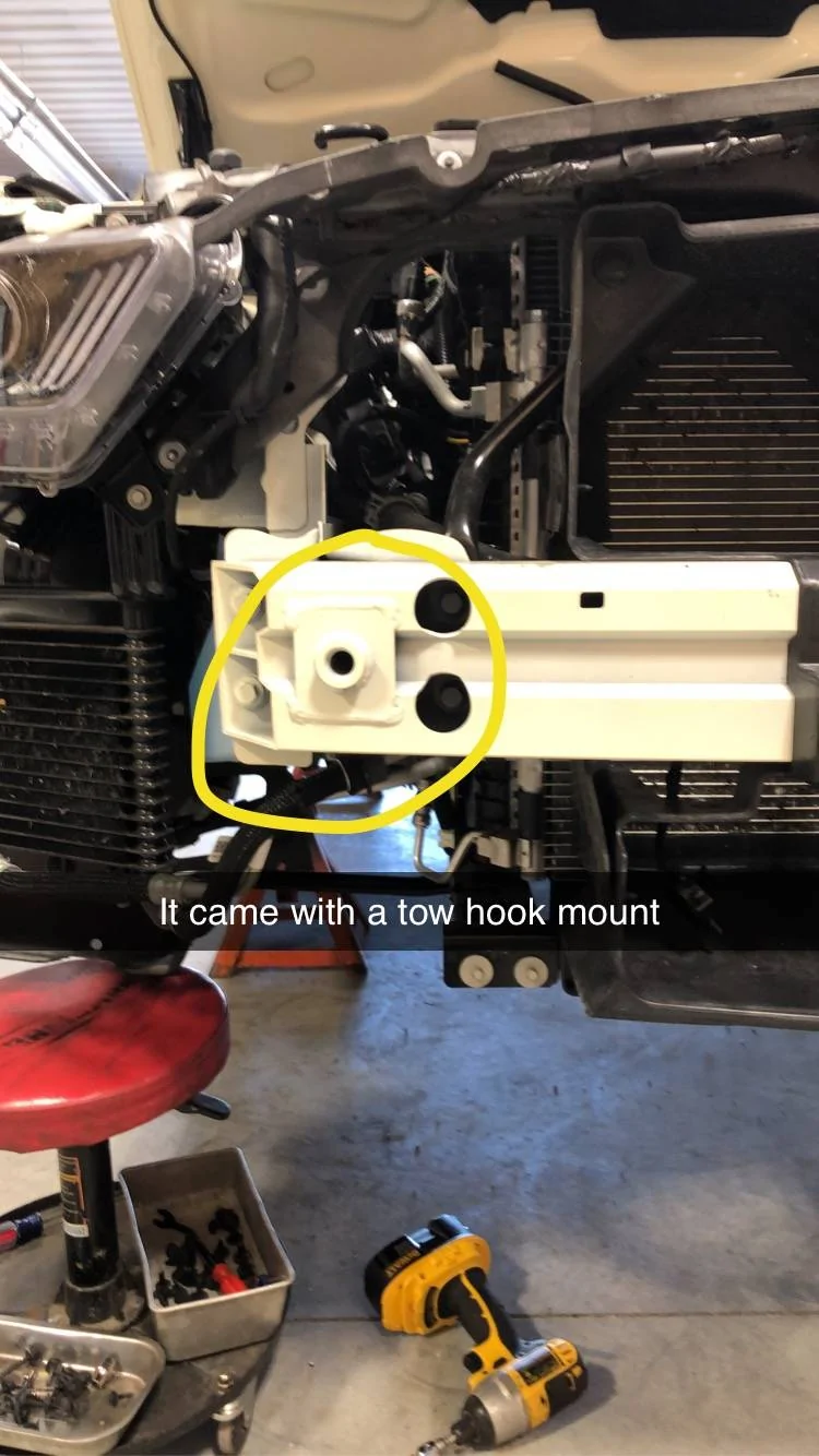

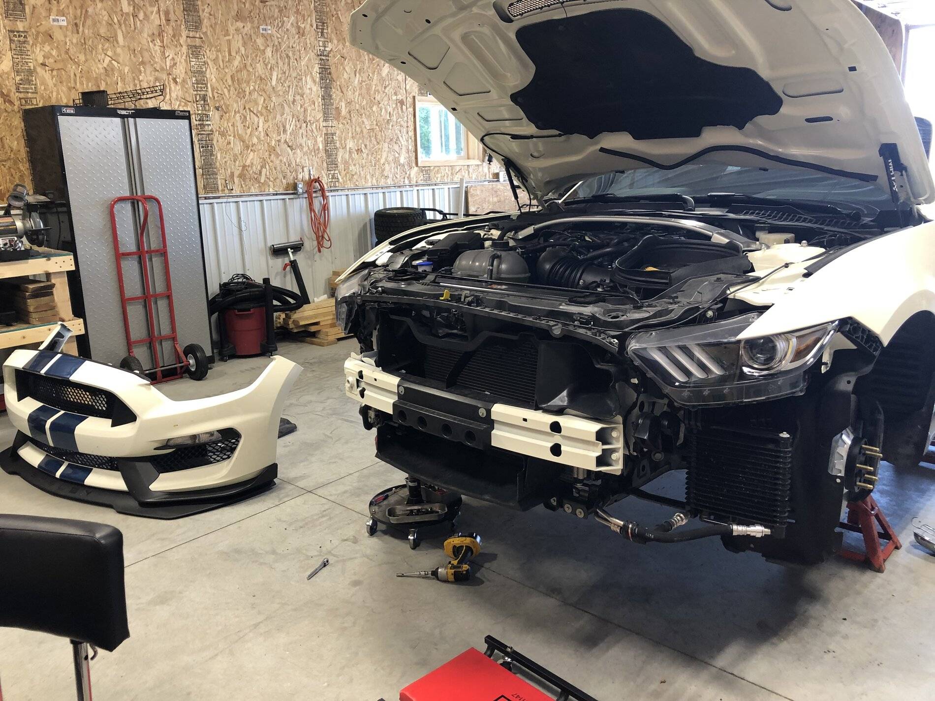

I installed the ZL1 hook on mine last weekend, 2020, it had the same mount. Wish I could utilize that, but just installing the ZL1 hook over changing out the front facia is cheaper. Really the GT350 a track built car should have came with front and rear mounts from the factory.
Did you remove the front bumper?
