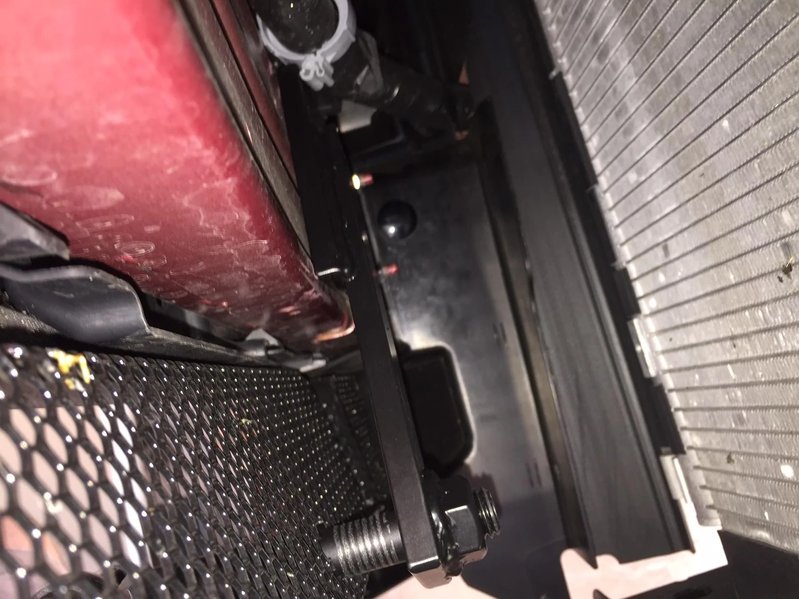

Ford performance tow hooks are the best.
They are centered, bolt securely. The down fall, more involved to install.

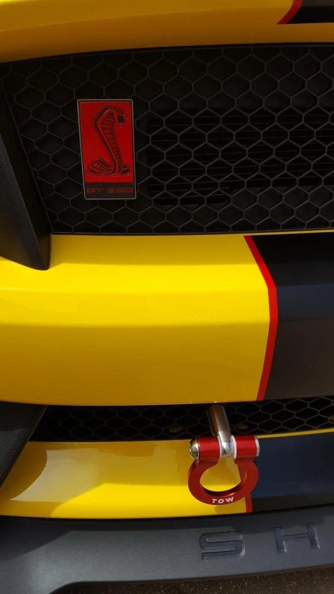

Install of the ZL1 Addons tow hook from under the belly pan isn’t hard. I’ve done it twice now and definitely was less time consuming once I knew what to do.
In regard to durability I had a local buddy of mine need his car towed off the track. His 350 was pulled up onto the flatbed with no damage to the front grill or any issues with the hook. He was skeptical about its functionality also, until he had to use it.
