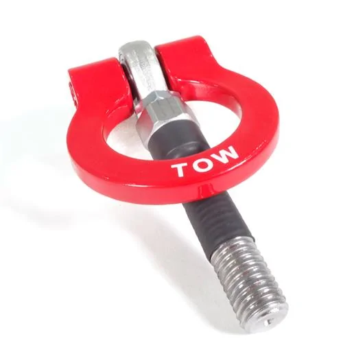

I just can't believe how many people put trust in two-four 8mm screws. A bumper crash beam is not made to be pulled on. You can believe all the vendors all you want, but the strength of a 8mm bolt is not enough to rely on. It's your car.
The zl1 hook looks pretty, and that's about all it's for. Looks. You show me a car that's getting pulled by that hook by Goober and not breaking or causing damage and I'll buy you lunch.
No way in hell would I use that to tow my car up my trailer either.
A yank on that one corner will tweak the subframe horn and cause a diamond pull to the chassis. I would take a center pullhook any day.

Well, I installed the ZL1Addons Tow Hook today, since my dealer did the oil cooler lines recall yesterday and I had already removed the front splitter and belly pan. While the instructions are correct that this tow hook CAN be installed with just the front splitter and belly pan removed, let me just say that it was a COMPLETE pain in the a$$, and I would STRONGLY recommend removing the entire front fascia if you're inclined to install this piece yourself.
First, the instructions are worthless. I am not convinced that the ZL1Addons folks have actually done this install from underneath a GT350 (at least, not a Track Pack car.) Tips if you do decide (against my advice) to do this from underneath:
- Get some thin nylon rope to pull and hold the core support out of the way while you sandwich the tow hook receiver plate between the core support and the crash bar beam.
- Remove NOT ONLY the air temp sensor from its mount, but ALSO remove the small plastic wire holder from its mount about three inches up the wire pair (otherwise it will be in the way of the receiver plate).
- The large wire loom will also be in the way of the top of the receiver plate until you figure out the correct position the plate has to be in to be forced under it. This is what took me the longest to figure out, and the instructions don't even mention it. To be honest, I'm still not entirely sure how I managed to get the receiver plate in place behind the wire loom, although I was bleeding and cursing loudly at the time, so it may have been just pure adrenaline.
The tow hook itself: Seems fairly sturdy, but I don't really like how there is no positive stop for it; you just screw it in until the lip touches the honeycomb grille. If you keep going, you can see the grill deform inward, and it would eventually break if screwed in the tow hook too far. I will most likely cut off part of a threaded bolt and make a "set screw" out of it to create a positive stop for the tow hook and prevent damage to the honeycomb grille from screwing in the tow hook too far.

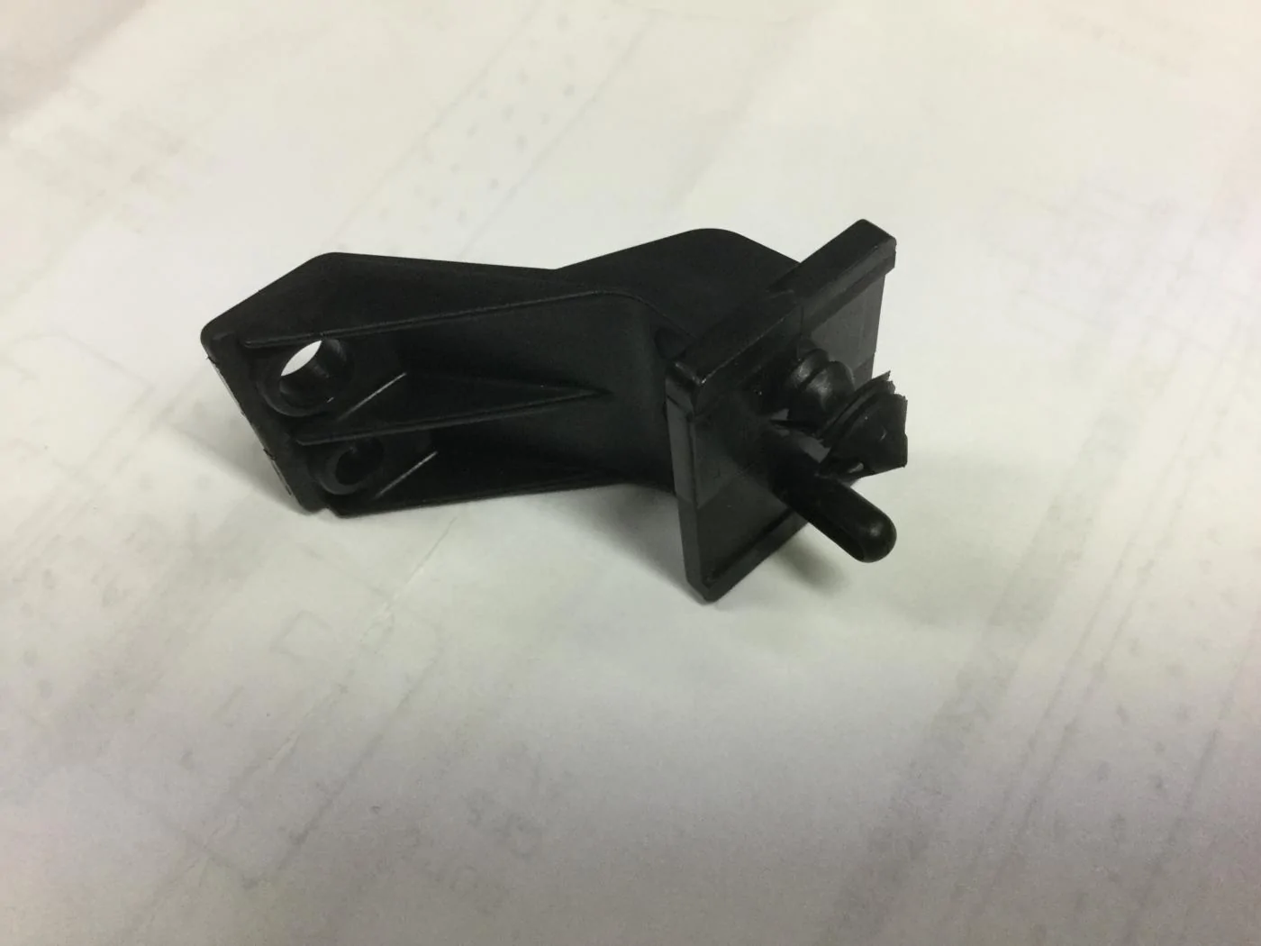

I agree. The ZL1 guys must not like GT350 owners as their instructions are essentially useless -- down right confusing. But once you see that needs to be done, its not too difficult to install.
As to the temp sensor, just remove it from the mounting bracket, remove the mounting bracket (picture), and reinstall the sensor where the bracket itself initially was located.

Proof load of an 8.8 class M8x1.0 bolt is 22700N. That comes out to about 5100Lbs. One bolt could lift the car off the ground with a healthy margin. 2-4 is more than enough for pulling onto a trailer. I do agree with your concern of the crash beam it is attached to when some random guy yanks on it to tow you out of a gravel pit however. How careful they will be when taking slack out of the cable will be a crap shoot.

There must be two different two hooks, then... Apparently which one they send you is a crap shoot. On the one I received, there is absolutely no way it will screw in all the way without hitting the honeycomb grille. See the picture below... The dark gray part of the tow hook impacts the grille before the shiny, threaded portion is fully screwed in. Is this what yours looks like, or is yours threaded farther up the shaft?
Edit: There are definitely two different versions... Here is the picture of the one on the LMR website, and it is definitely not the one I received. I'm going to call ZL1Addons and ask if I can swap mine out (that is, if the threading is identical... No way I'm going to remove the mounting receiver just to fix this issue).
