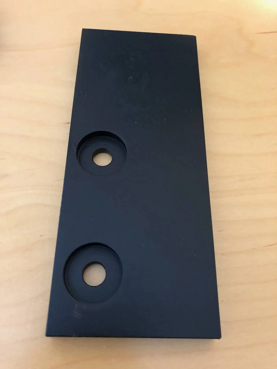

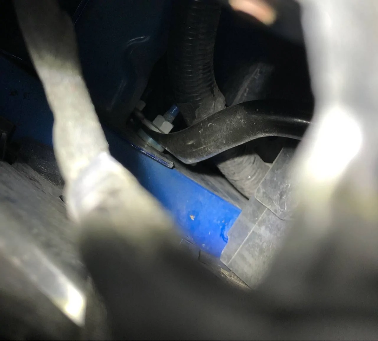

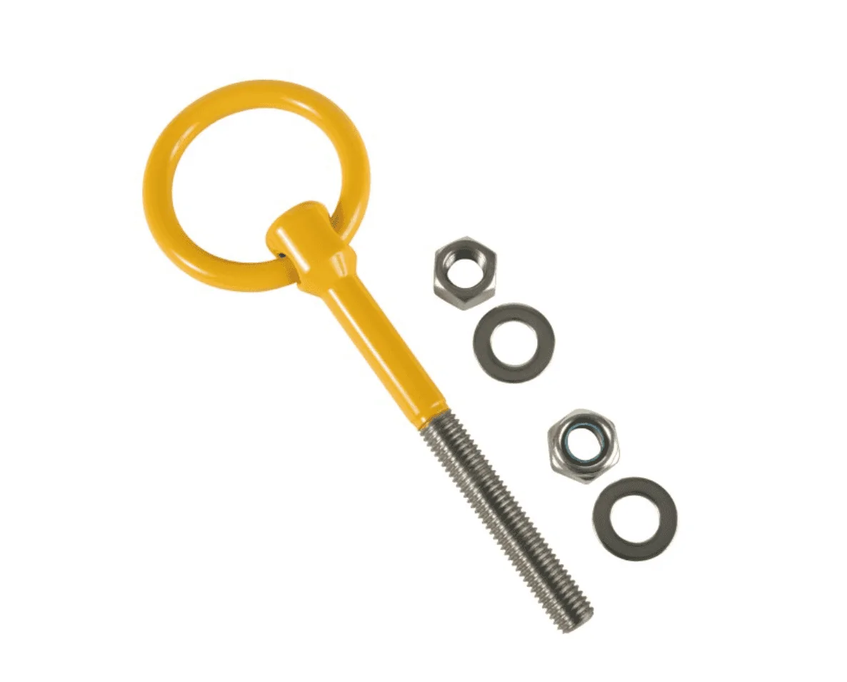

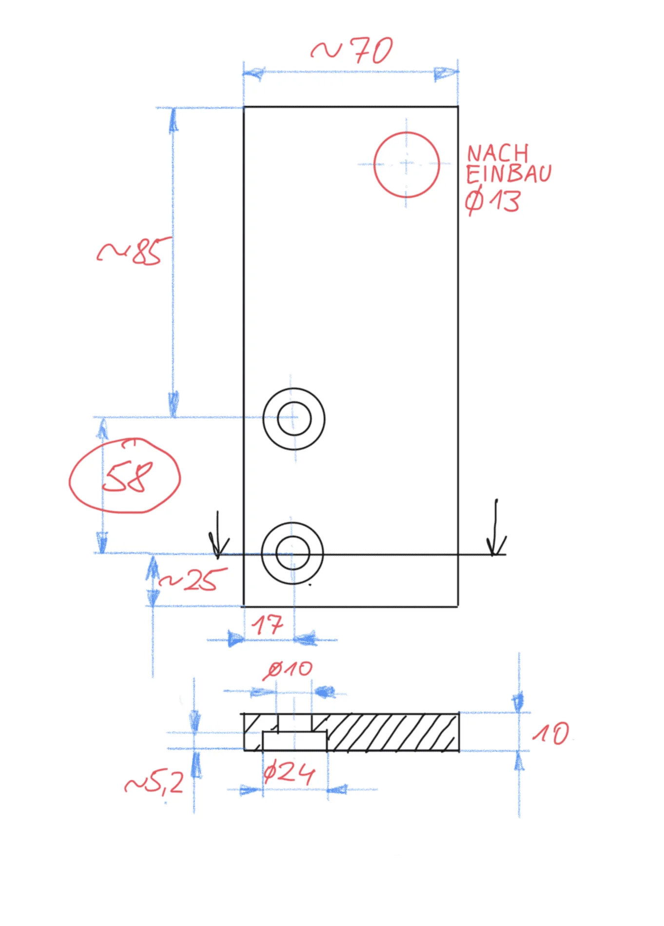

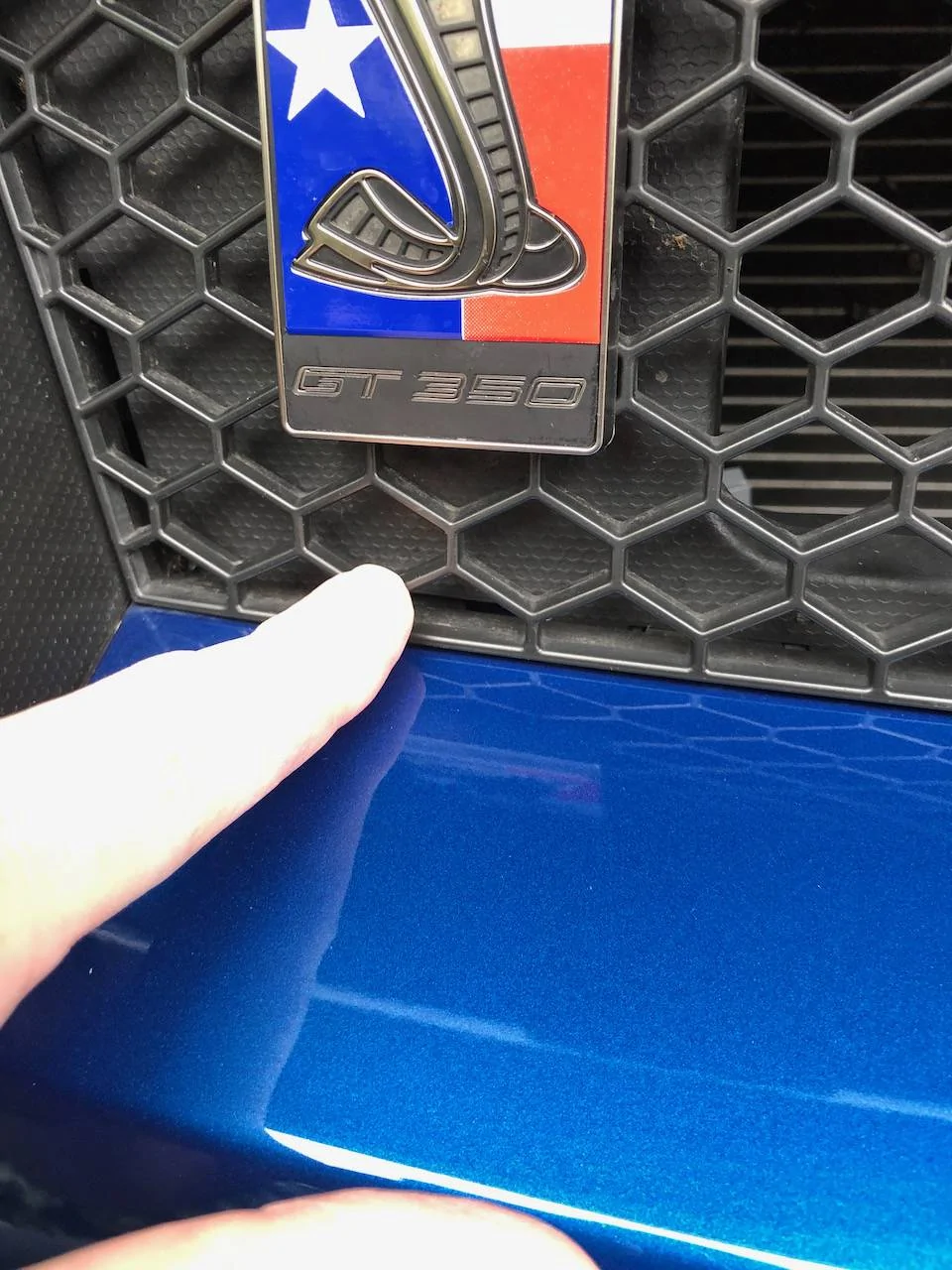

I bought an OMP tow hook with 50mm ring diameter and a 12mm thread. That hook will be removable thru the grill right below the snake logo by a self retaining all-metal nut welded behind the receiver.
The receiver itself is finished. Now I'll need to find the right position to drill a hole thru one grill opening and to weld the nut on that receiver. I tested the all metal nuts and it will be self retaining many times, at least until I have to remove the tow hook e.g. by officer's demand.
Could have gone also with a modified ZL1 solution in the lower grill but this upward position is more convenient to mount and produces less bending force towards the crash bar mount.

Not sure why you stated the ZL1 wasn’t removeable. The brackets stay in place both front and rear on my ZL1 setup and the tow hook itself isn’t on the car usually. I tested both front and rear and it’s plenty stout. I wouldn’t want to cut the grill opening where your proposing personally, but it should work fine there. I didn’t want to cut the rear bumper cover for rear mount but it is at least behind the license place. the ZL1 stuff is top notch, but you do pay for that.

Yes, the zl1 can be removed (unscrewed) from its receptacle. Its not optimal, but i think drilling your grill is less optimal than what you are going to do.
