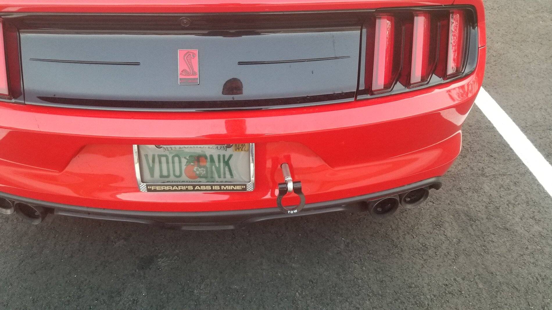

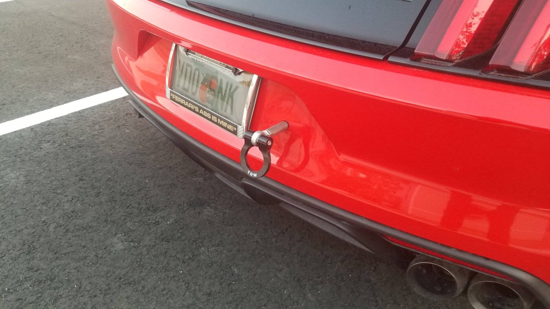

I just had mine installed and the best option is take rear facia off. My installer did the rollbar and hook at the same time. He stated it was a pain to remove but made it easier to install. My rear hook is not centered but offset, so I do not have to take my plate off to use the hook.

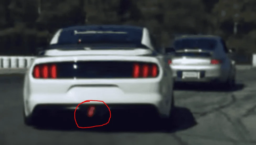

Does anyone know which tow hook this is? it looks like a strap but I'm curious to know the mounting point.
16Kobra
May 3, 2016
1,685
1,126
2019 GT350R
Not sure of the brand, but I believe that is the hook that eliminates the back up light.

Ford Performance Tow Hook that is installed where the back up light goes. I fab'edthe oem back up light housing to inclose the back of the hook and installed some LED lights on the hook. The LED's are brighter then the oem bulb.
I think it looks great. Can I pay for you to come to GA and install it? LOL. Any other pictures or videos, I'm digging the look.

Had to get the car out of the trailer, so took pic's of how my rear hook is mounted.
