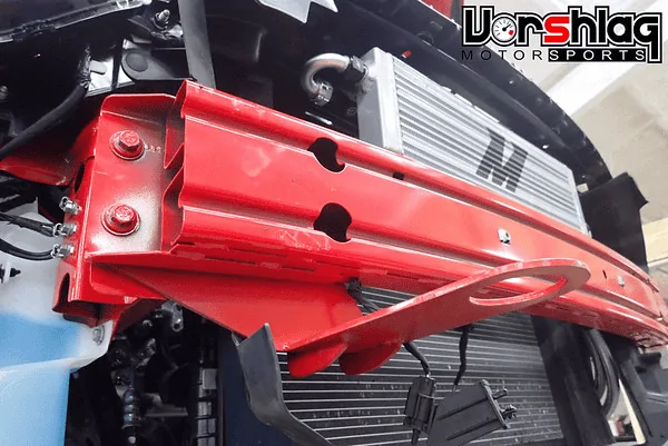

Please note that the std off center ZL1 can be installed without removing the front bumper cover, (so they say).the Ford Performance has to have the bumper cover and crashbar removed and thecrashbar drilled. The Vorshlag needs the bumper cover removed and a small slit cutout of the lower grill, which is not too bad. The hook bolts to the passenger sid crash bar bolts. If you want simple and be able to remove the hook when not in use then go with the ZL 1.
Can confirm the offset bracket can be installed without removal of the front bumper. Just the undertray has to come off.

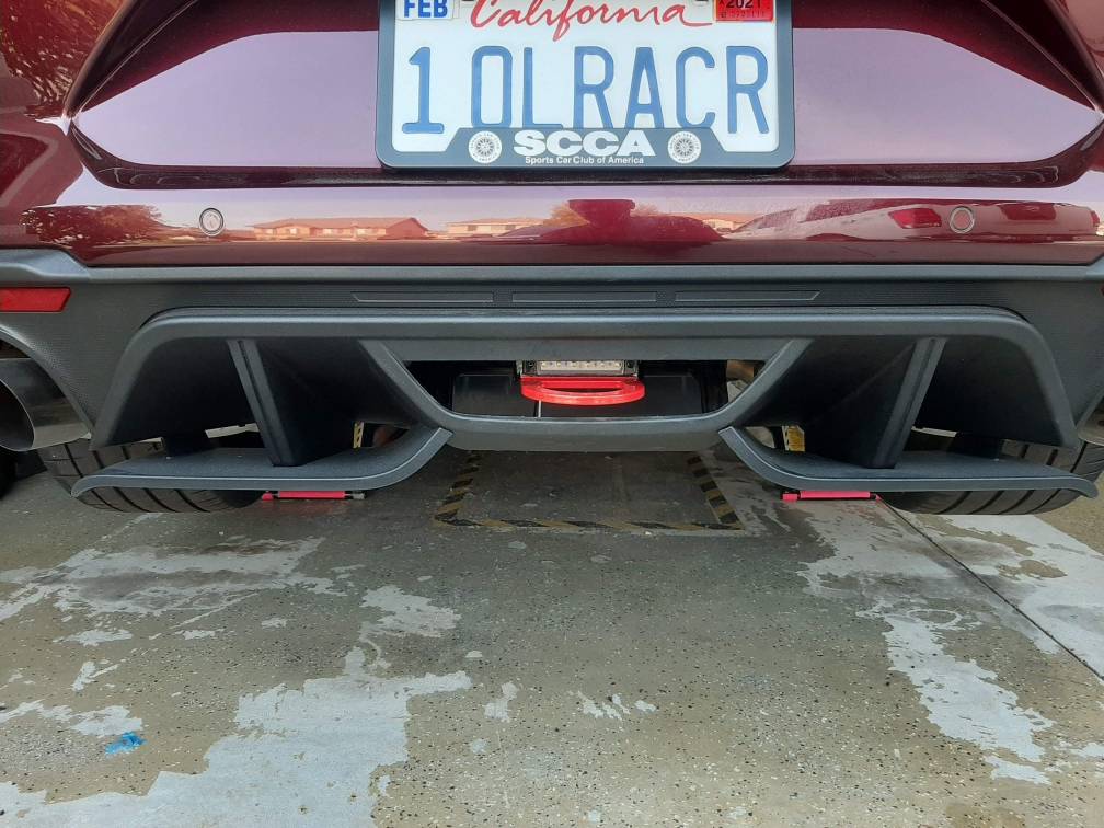

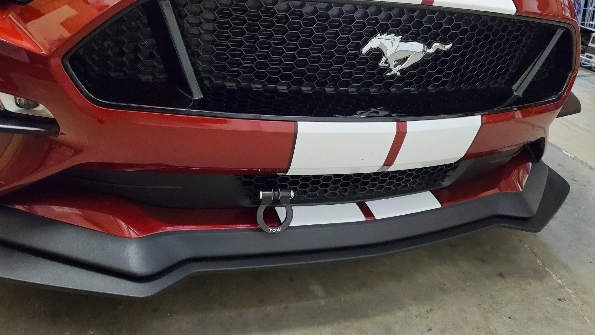

I dont think the F.P. hooks are very well liked here because up front you will need to cut a small slit in the lower grill and on the rear you need to remove your back up light. But here are a couple of pics of mine installed.
