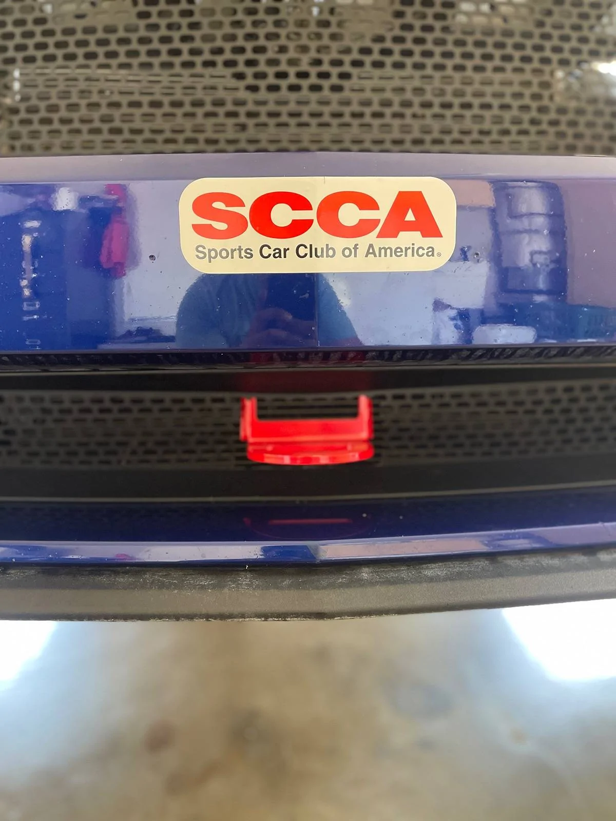

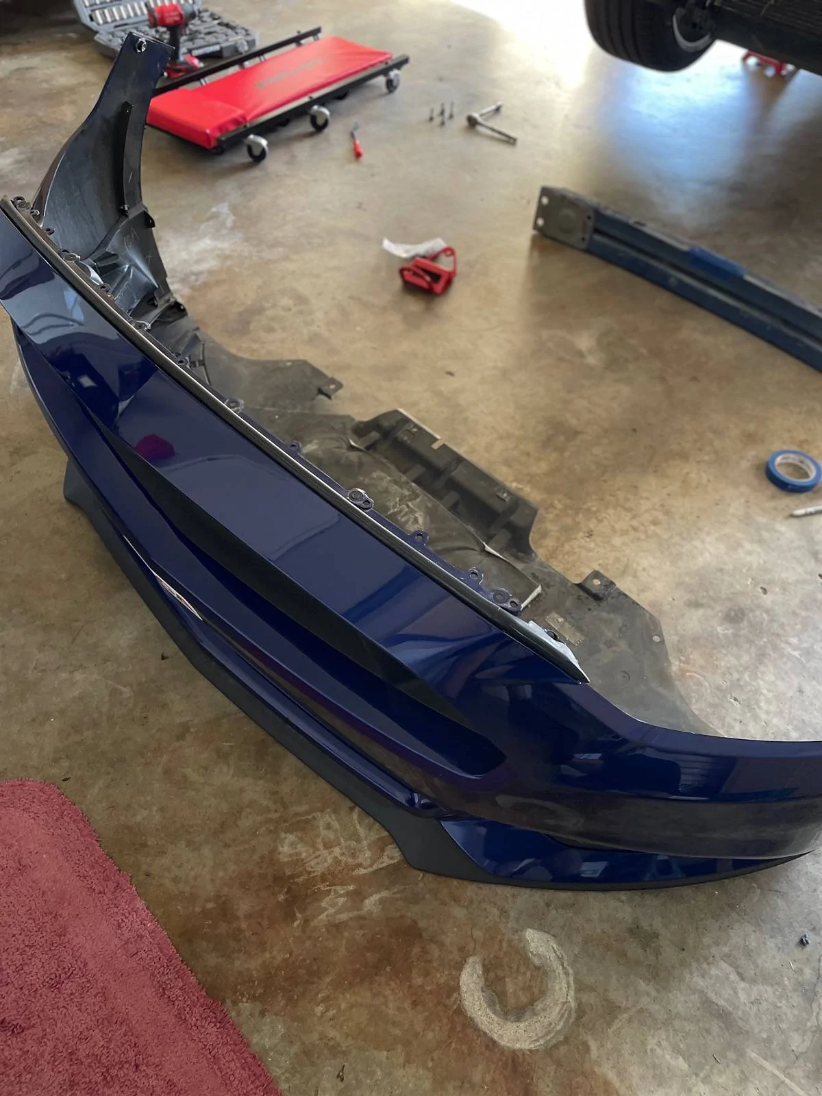

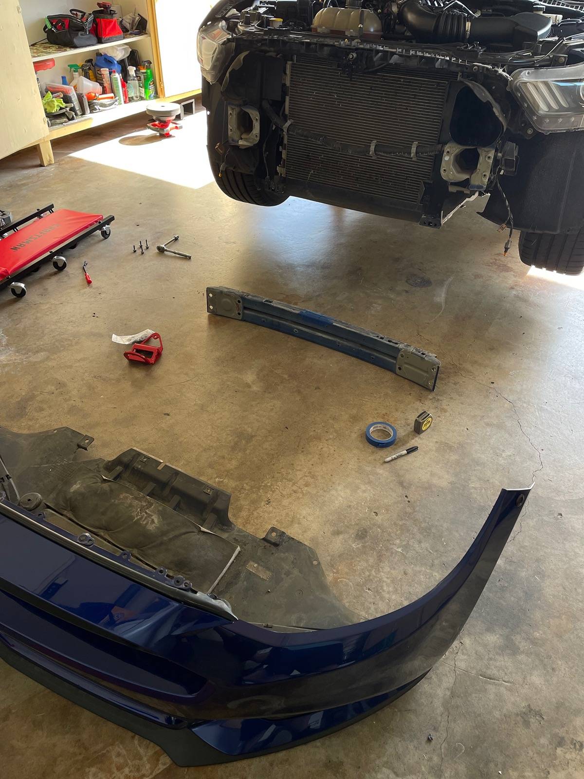

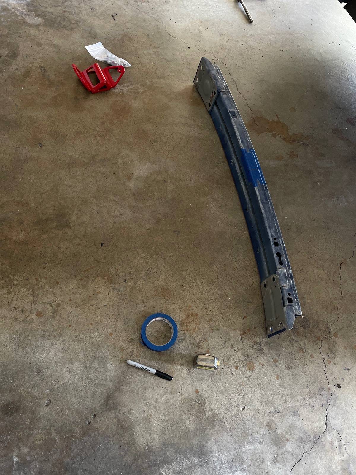

Removed the front bumper.
Removed the crash bar.
Marked center line on crash bar BOTTOM. Took me 2 hours to drill through the crash bar in 3 spots...very solid metal, testament to ford crash bar safety (chuckle). I had very old drill bits...so I suggest high quality metal ones or a drill press to make this easy.
Trimming grille...this took me three tries to get right, finally just had to cut most of it out in th emiddle to make it decently nice. Ignore my ugly face behind the phone.

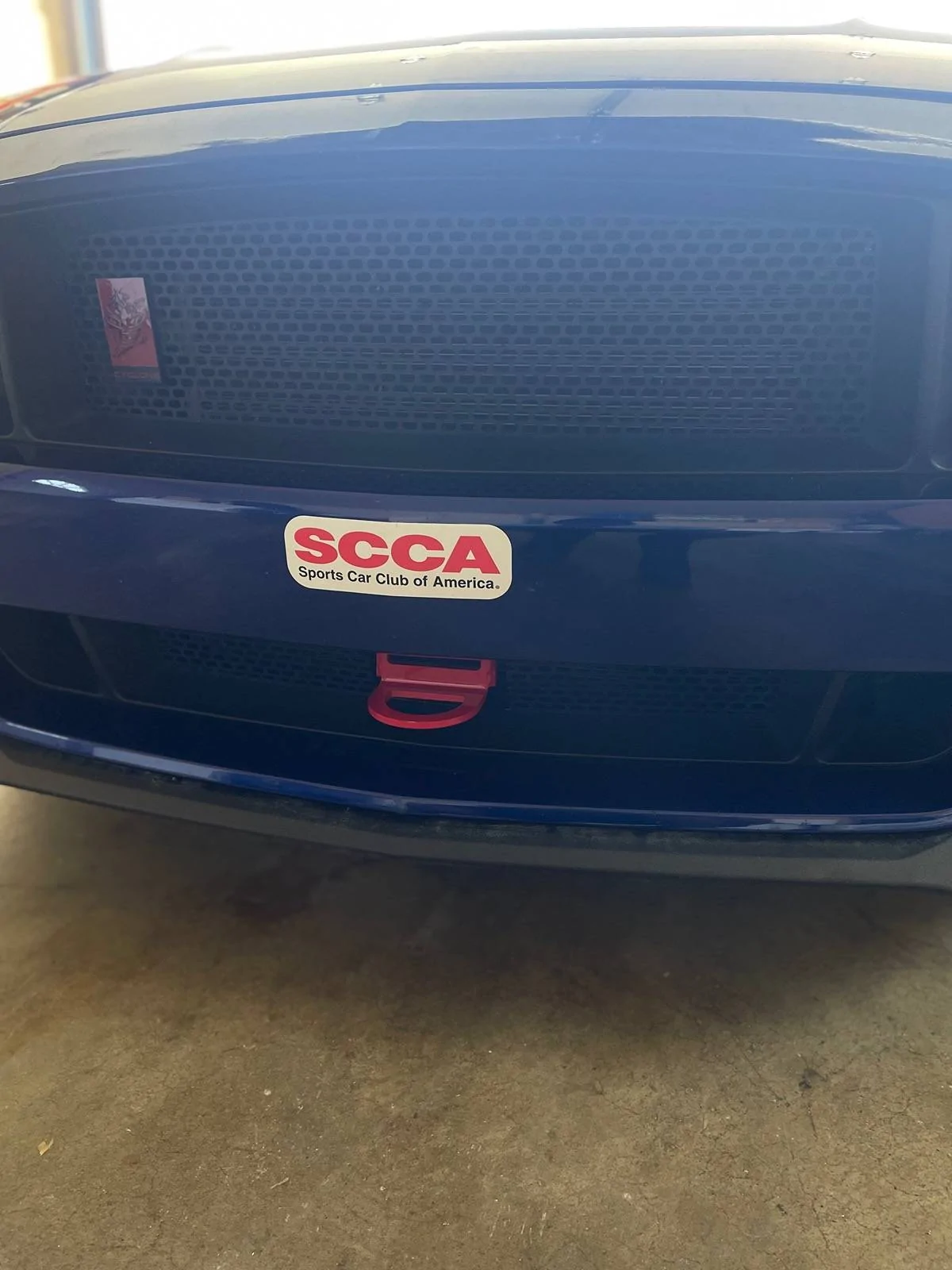

Finished product.

@CobaltFilly great job on the install!
Thank you! Love how it turned out, matches my very small miniscule red accents I have all around the car. Kind of sells the "racecar" look (and function lmao).

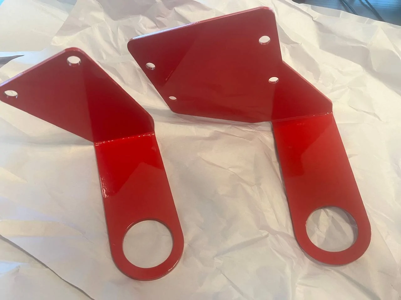

I went with Vorshlag front and rear tow hooks. The rear installs without any cutting or modifications. The front does require cutting a slot in the lower plastic grill. I haven’t installed the front yet (should be able to get to it this weekend).

I like this! Were there any issues with breaking tabs on the number during removal and installation? How thick is the tow hook? Do you feel it would hold up to repeated use without bending?

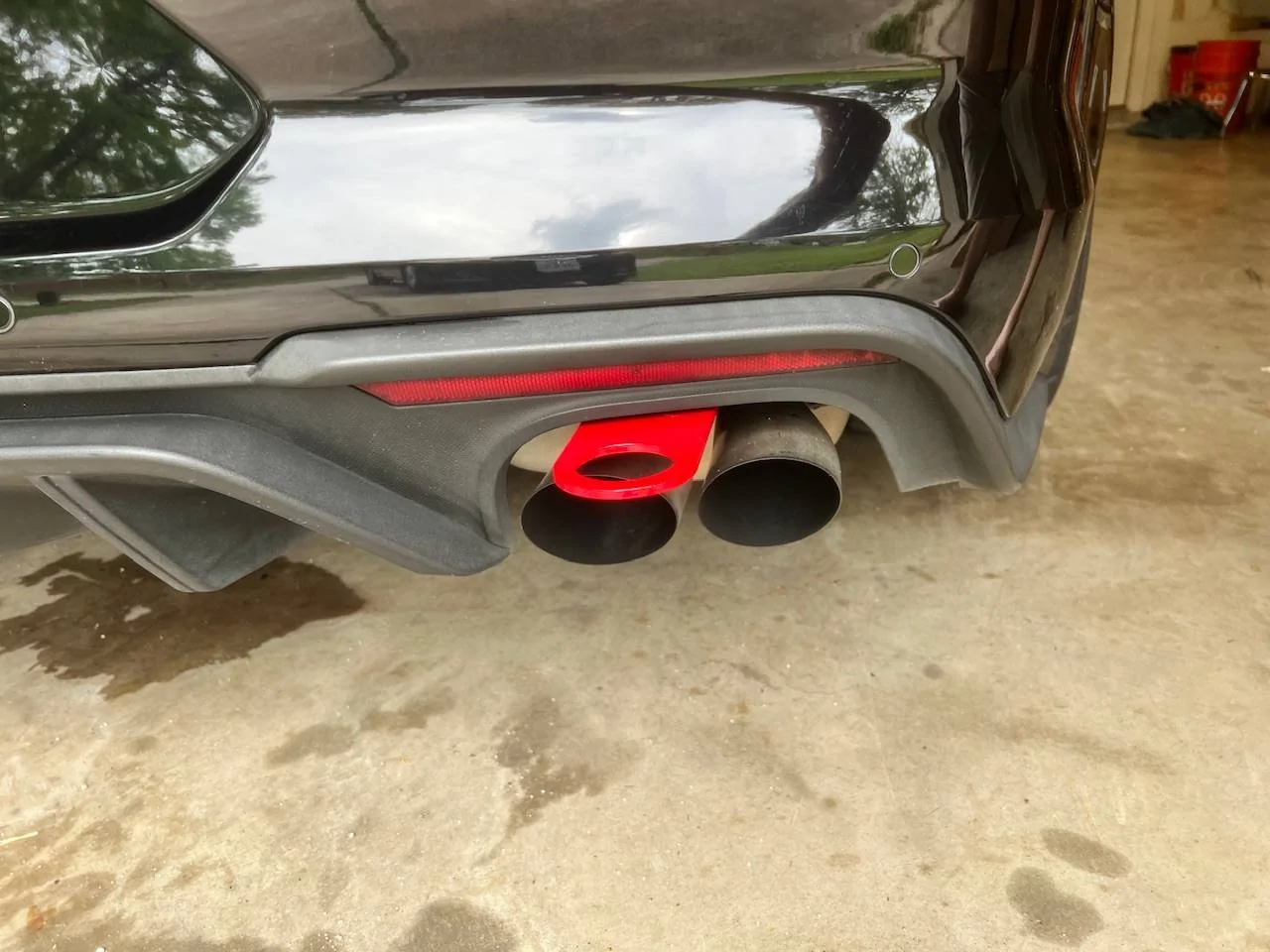

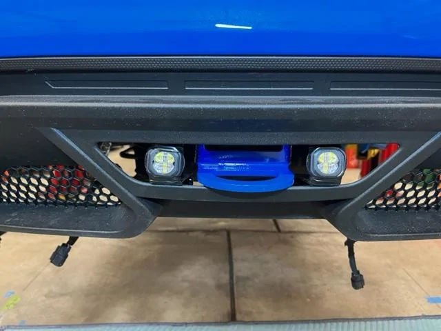

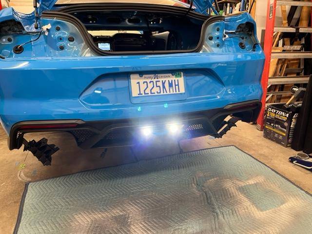

Rear mounted Ford Performance tow hook with Bemaro brackets housing ECCO ED9040 RED/WHITE LED lights. The lights are common on police/municipal vehicles and can be wired and programmed for multiple functions.
