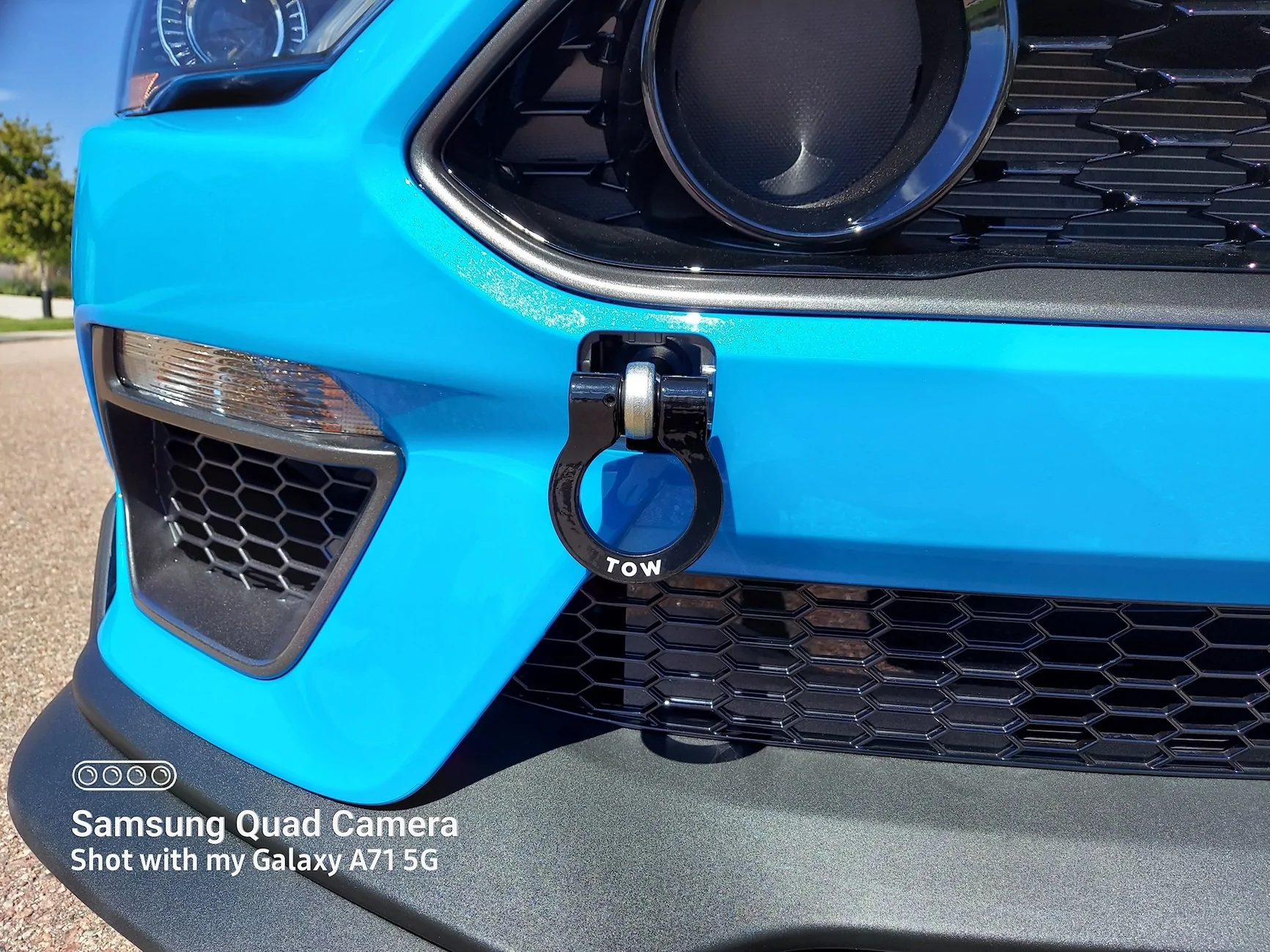

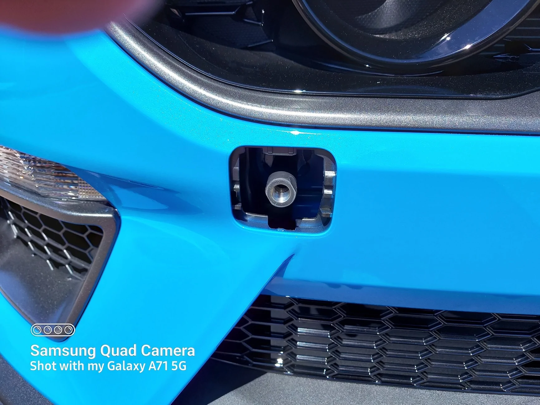

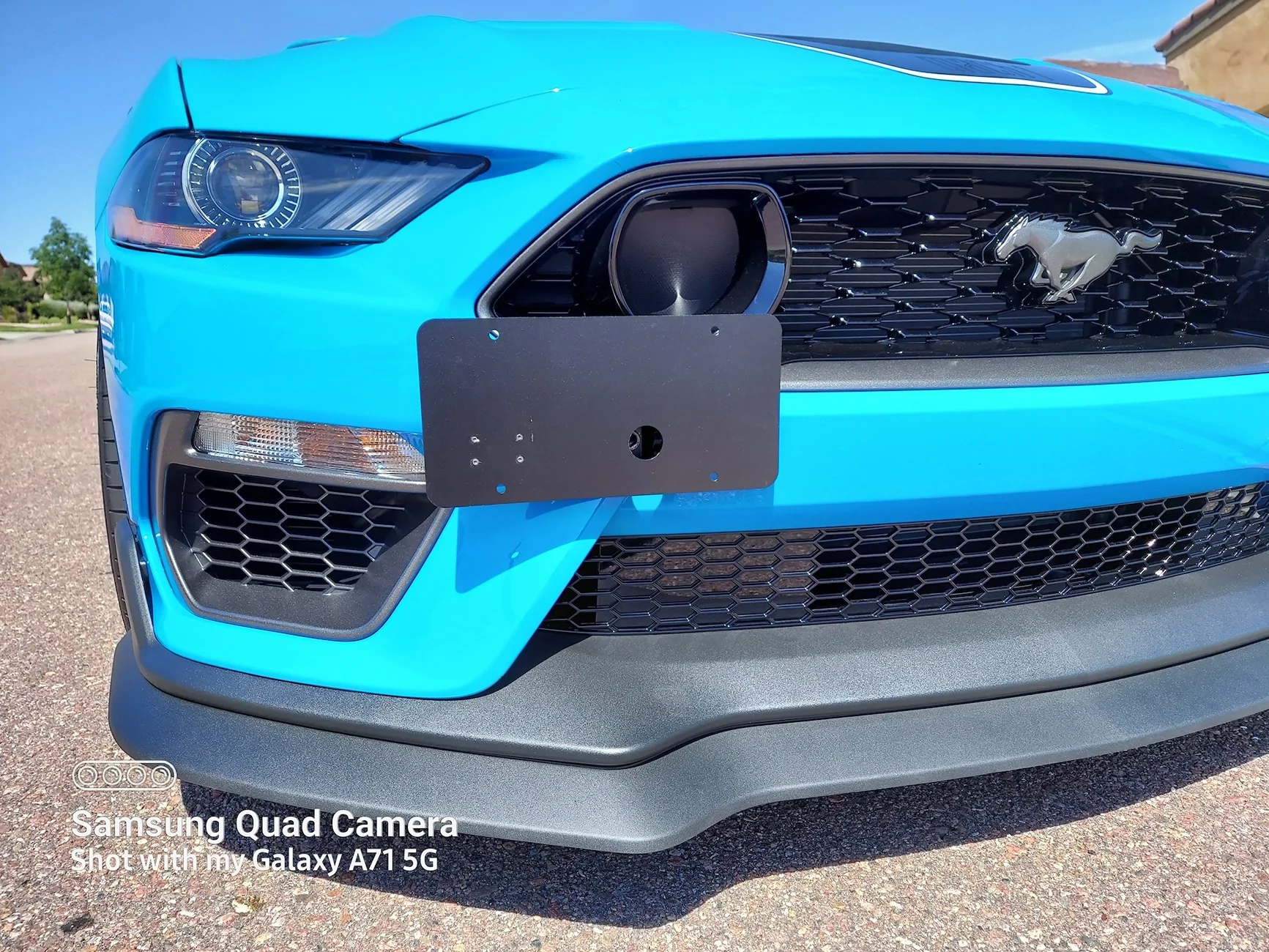

Mach 1s came with a tow hook port. I never studied the thread size though. My solution is attached.

Taking the factory tow hook from my Welcome Kit (not for sale) :giggle: and checking that with a bolt gauge in the garage, it measures as an M16, reverse thread rod.

i thought they had to have brackets bolted on the car on your cars
That is a discussion covering many a thread.
Many of us prefer not to drill into the front bumper. But most states in the US require a front plate mounted on the vehicle. For those areas that do require them, some police are lenient. Others are not. People living in any area have a general feel for what police and inspectors will tolerate and what they won't.
While my state requires a front plate, I place it on the dash. In my county, the police will not pull a person over for lack of a plate. But if being cited for something else, they might add that to a ticket. If the conversation between the police and the person is going well, they might not even notice.
While I do not use it, I like having the ability to place the plate using the hook versus drilling. There are no-drill solutions, but most of these will not work with the still lower lip of the Mach 1 HP splitter. Aesthetically, I like having the plate off to the side. Something different than the traditional center mount.

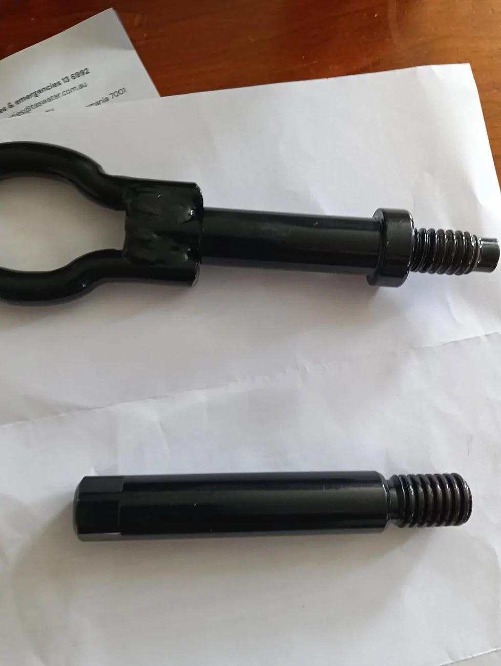

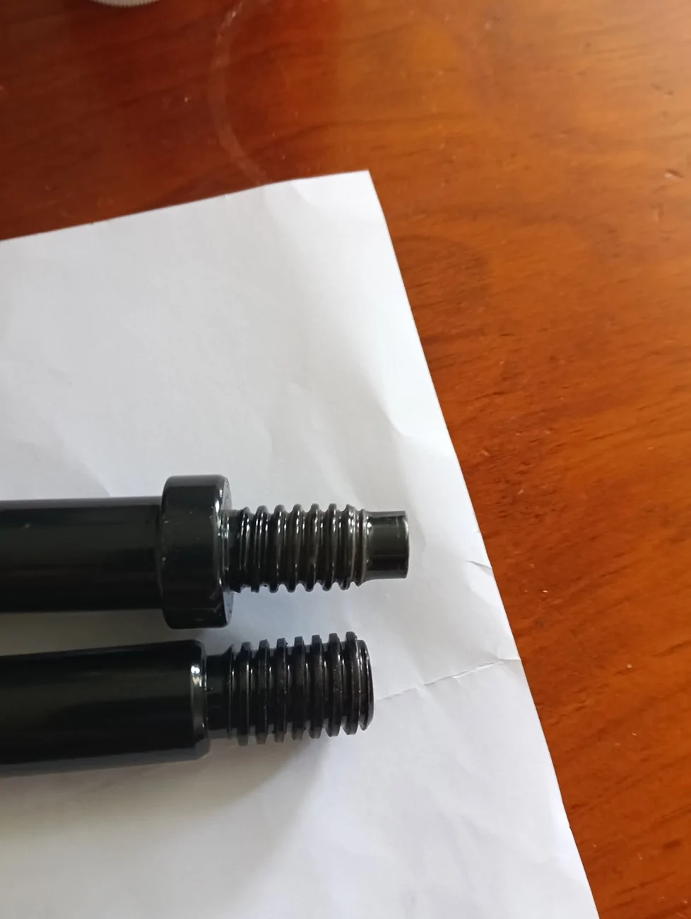

as an aside i measured the od of thread of our tow hook with calipers its around 15.8 mm lh thread measuring that kit the thread is 17.7 im wondering if its year specific the size difference

As to the size, the measurement of 15.8mm is in-line with mine this morning. The only explanation I can give if your measuring one at 17.7 is that is an aftermarket piece, maybe as part of a rear hook installation? [Edit, see below. AUS spec rods and hooks differ in size.] Many tracks require front and rear hooks or straps.

thankyou the one in kit i put link up above is a larger size than our GT,S thread
if i can work out the correct size from a seller i will put it in the Aussie section on here to help others wishing to mount their front plate in similar fashion
pics show our tow hook and shaft ? that comes in kit
in fairness ebay add says suit GT 24/25

attempting to machine the thread off USA one then run a lh dye onto it right size for Aussie and i presume UK >> cars
may help guys out looking to use the one i posted

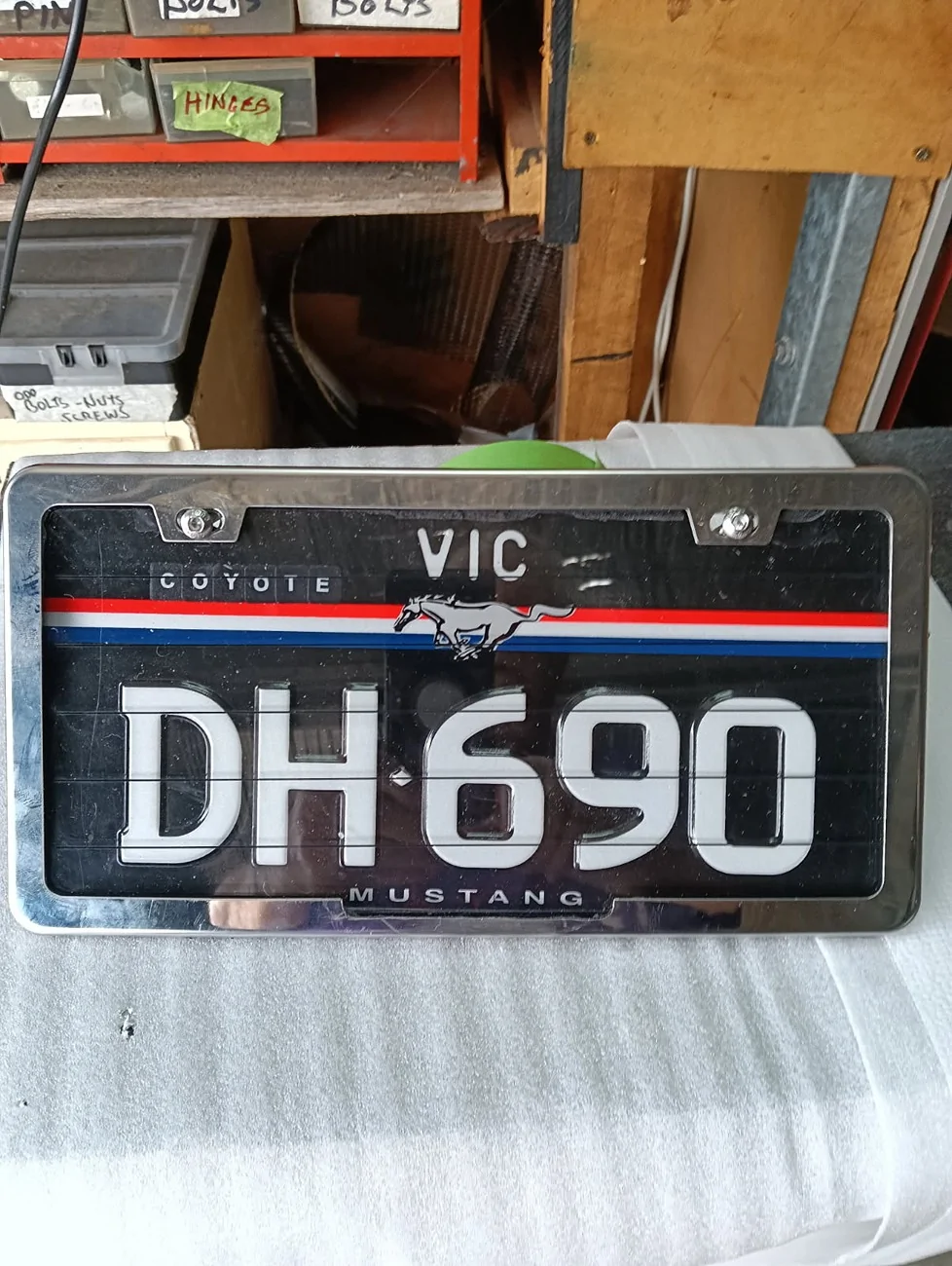

pic below is our Aussie plates as they come from VIC ROADS
has horse and mustang wording on them
i wanted the :lined"perspex cover plus chrome surround so i had to cut the stainless at bottom and heavily modify the perspex
i have to finish them off and polish stainless yet they are just mocked up unfinished
