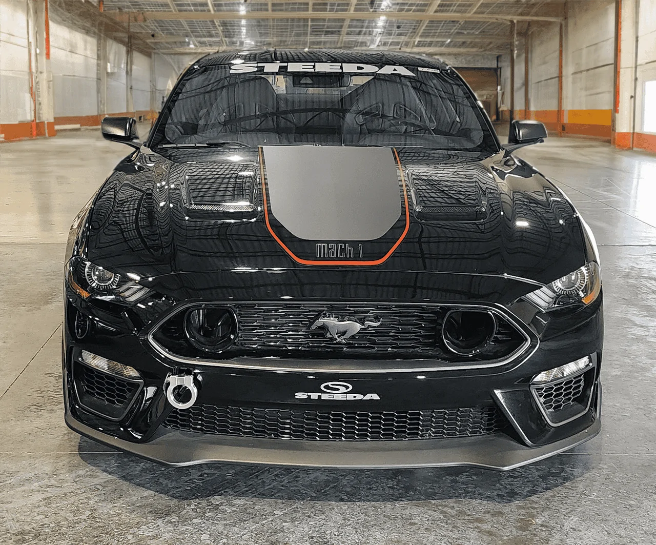

Hey Ron - get another the factory cover - MR3Z 17E811 A - and it only comes black, unpainted. No color match from Ford ? Removing the OG cover takes patience as it’s attached with an hook style anchor that needs some fiddling to remove. I installed the ZL1 main shaft with the LH threads, took some exact measurements & drilled the 1/2” hole with a step bit In the plain black cover. I later opened the hole to 9/16” to accommodate a sleeve to give it a finished look. Used blue loctite to assemble the hook eye with jam nut. I’m keeping my OG blue cover unmolested. Only wanky issue is ZL1 uses a RH thread for tow eye/jam nut making it a cumbersome procedure to tighten it all up. If they would have used a LH thread, it would be straight forward. Hope this helps.
