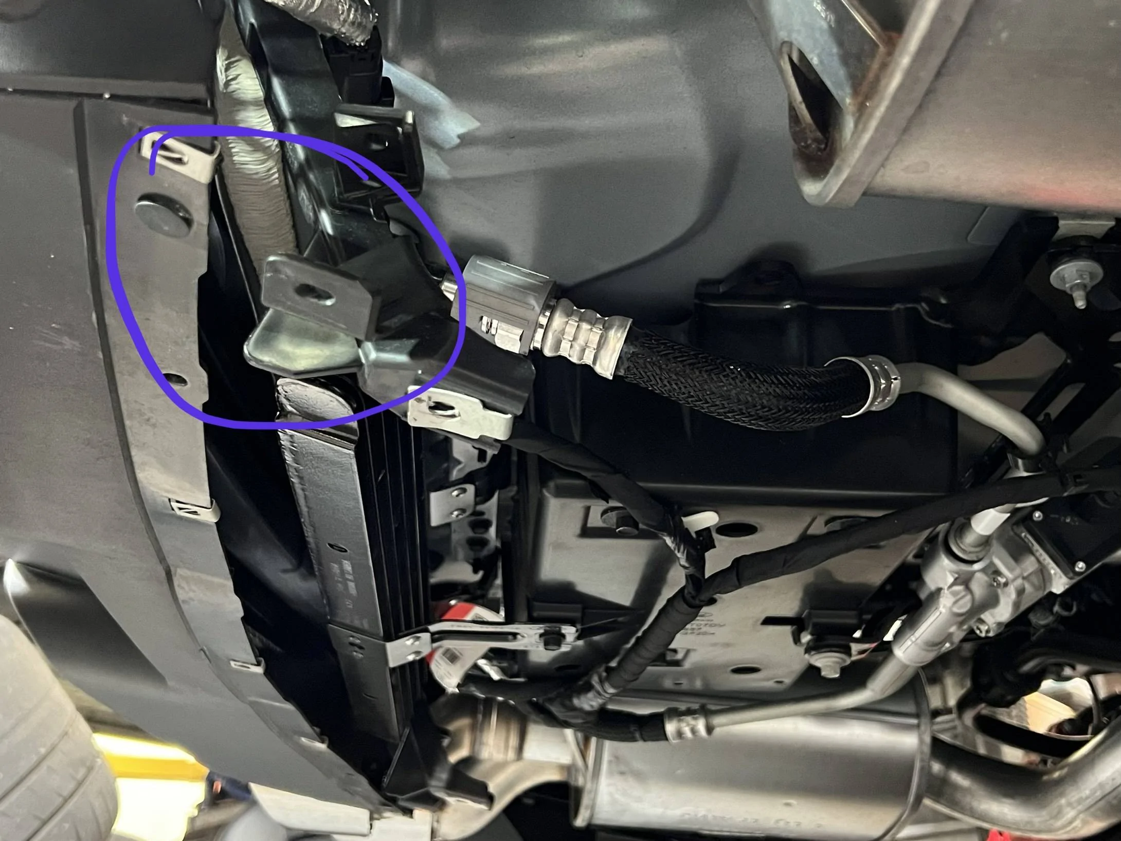

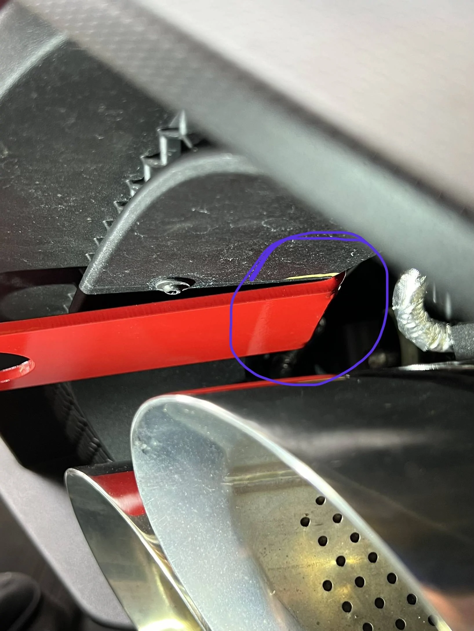

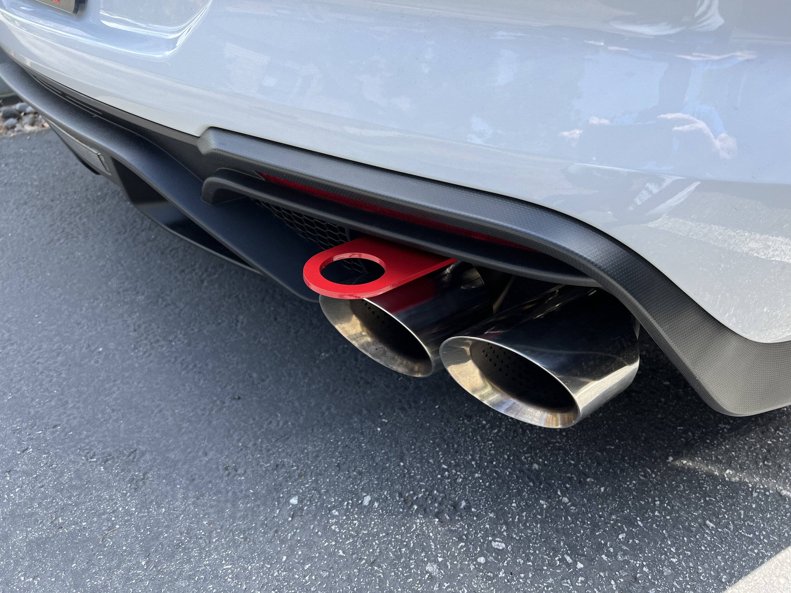

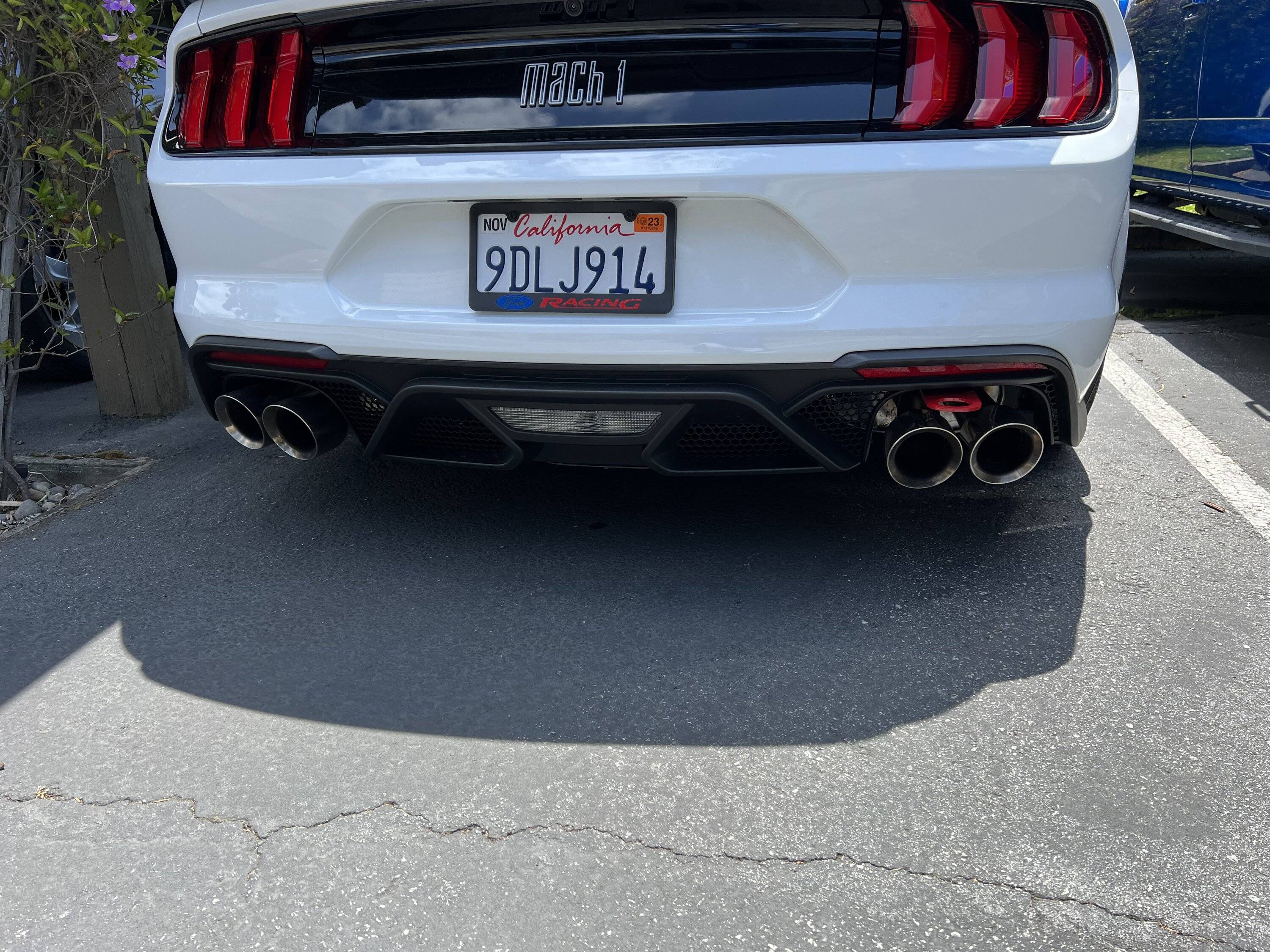

Finally got the hook installed. To answer the question does it fit on a Mach 1, yes. But, you will need to do a little trimming on the underside rear of the valance. (It’s actually a separate little piece that removes from the main part of the valance.) Other than that, fits perfect, sits level, doesn’t rattle, and is actually almost not noticeable unless you’re looking for it.
I chose this particular hook cause I didn’t want to do any trimming, but it’s in an area you can’t see.
Full disclosure, I had it installed at a local performance shop because they were doing an oil change, setting track alignment specs, changing brake fluid, and doing SS lines and pins, and installing Steeda jacking rails. I don’t believe there were any other stumbling blocks.
