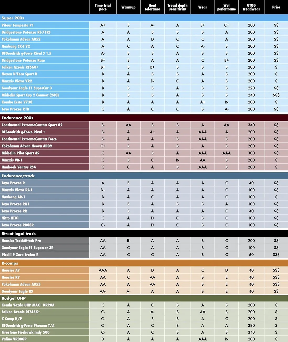

This is the latest version of the chart from their site I believe.
I haven't seen this version but their previous one was pretty spot on. You could certainly use this as a guide.

Here ya go, fresh off the press.
