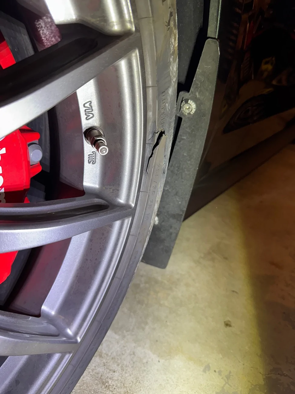

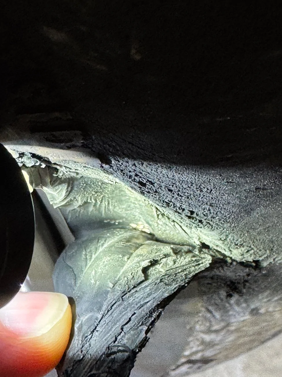

I was going to wait until the spring to buy tires but this happened. Not even sure how I did it, which is mildly disturbing. I’m assuming it was a very low curb or else I’d have a lot of wheel damage

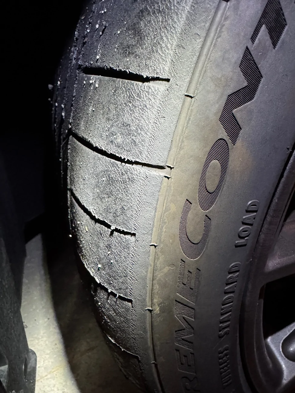

I am not fast. My current ECS have 7 days on them and look like this. The W is still intact.
