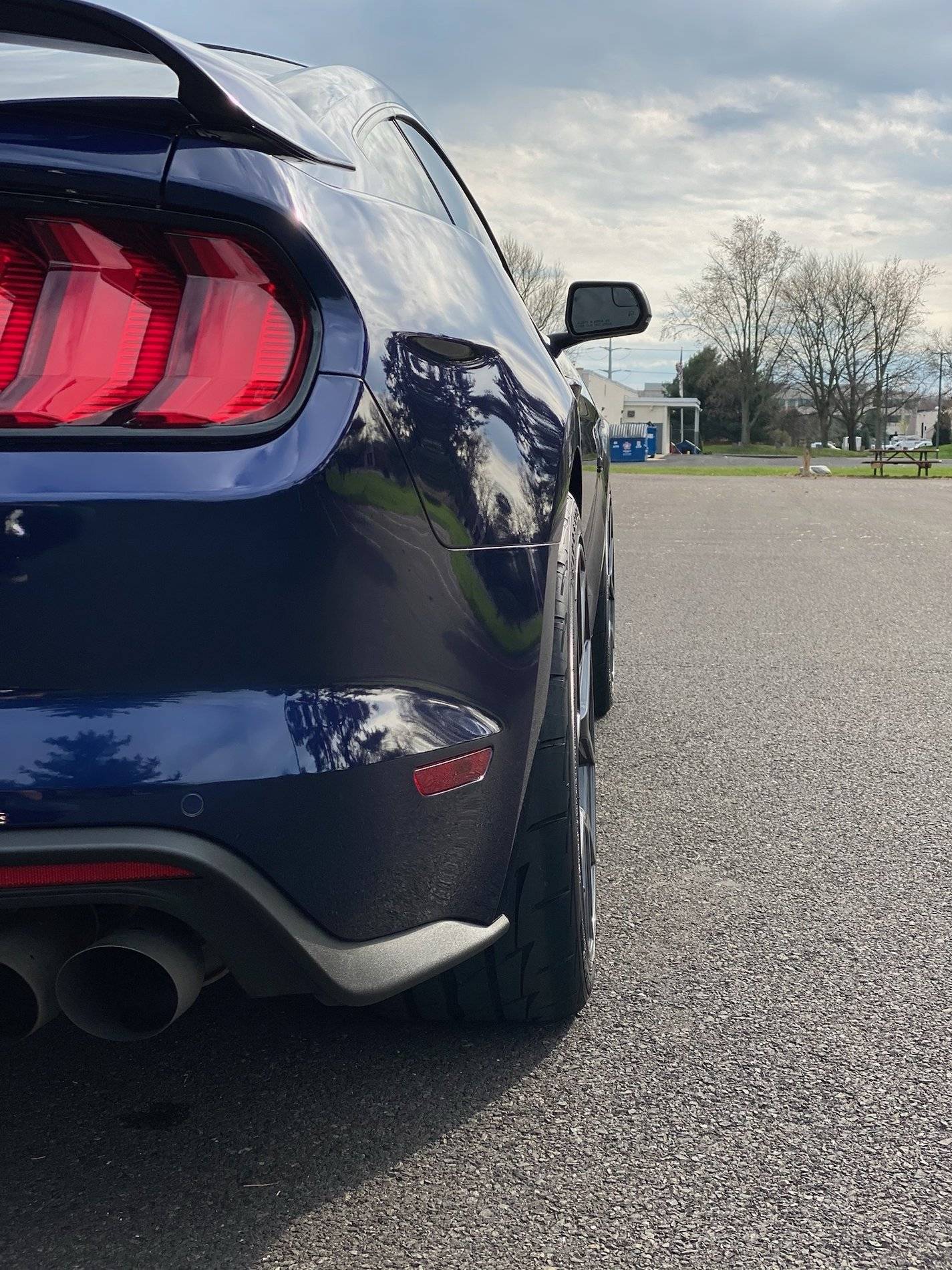

+1 for 285 square

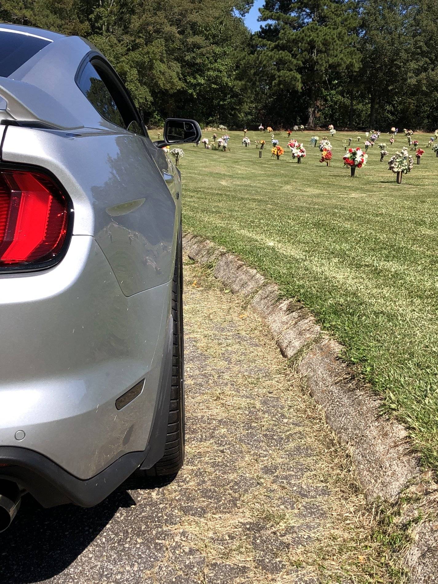

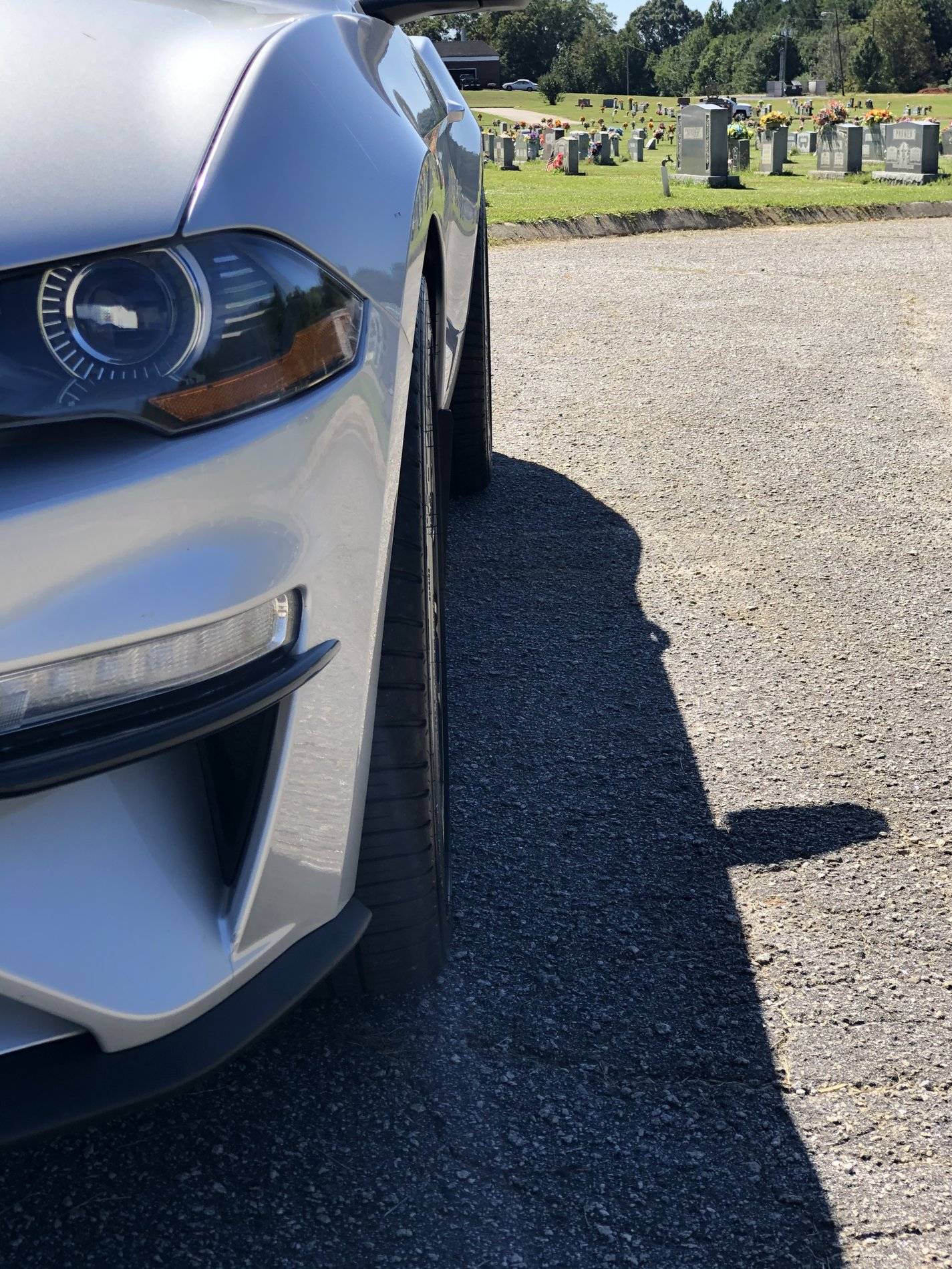

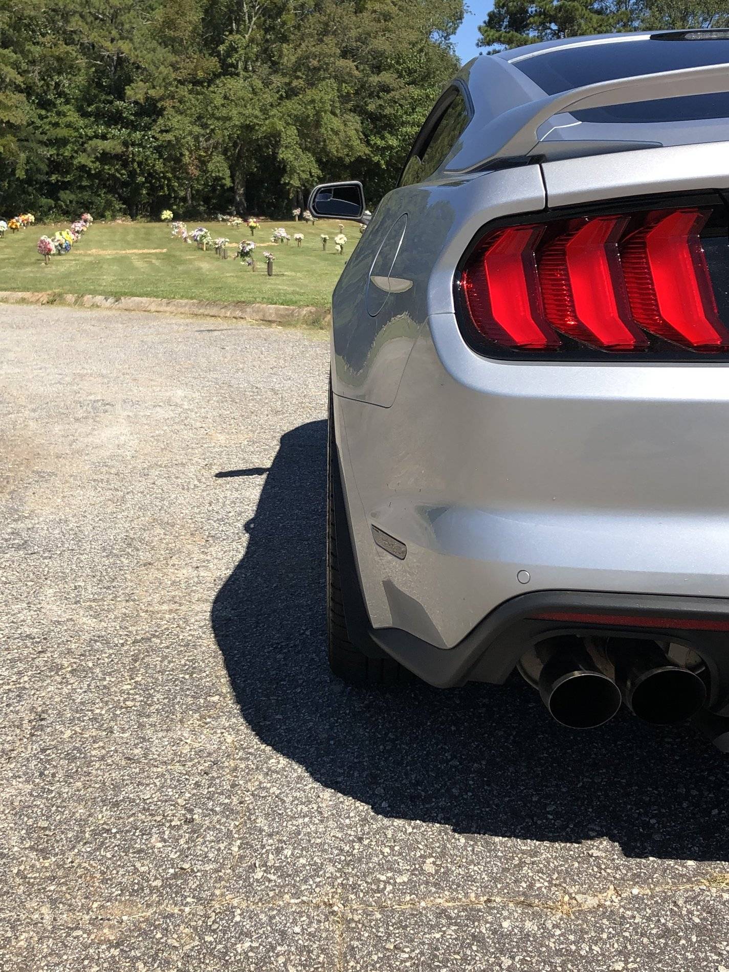

I have 19.5 with 275/40ZR19 squared and it handles and looks good. Same rear size tires and wheels on the back of a PP1 on all 4 corners.

No spacers. They are RTR wheels from American Muscle. I’ll take a picture tomorrow during the day light.

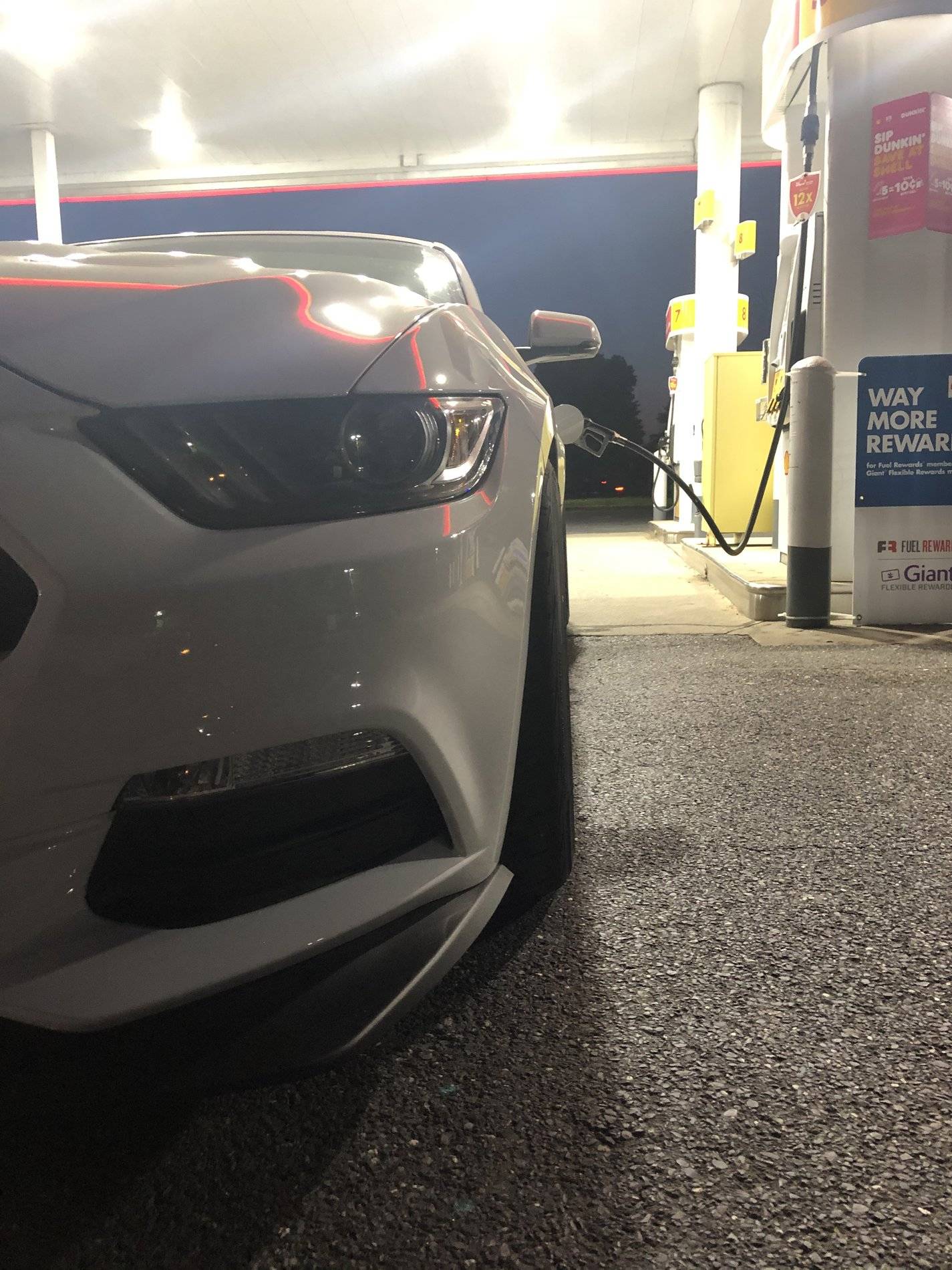

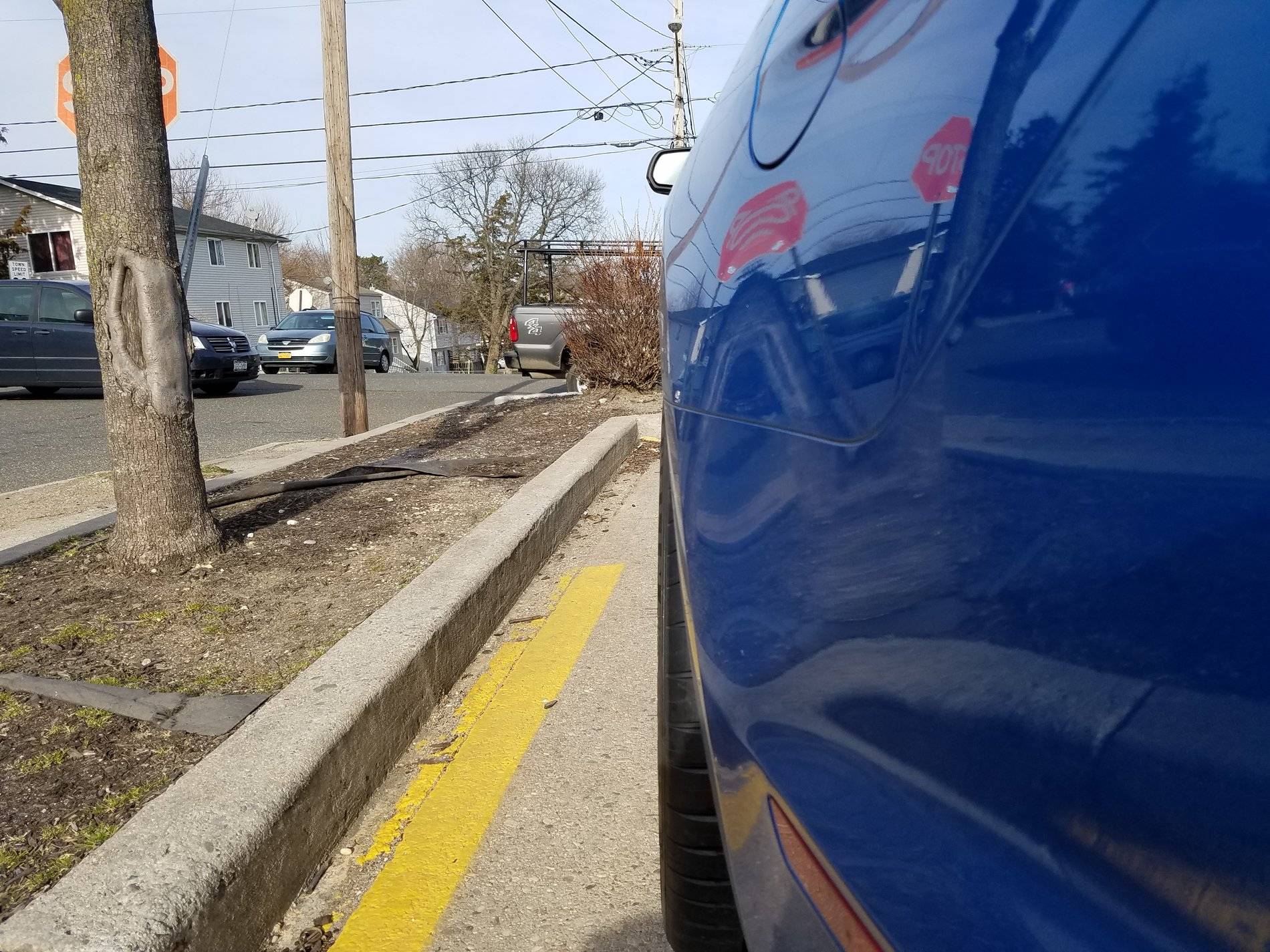

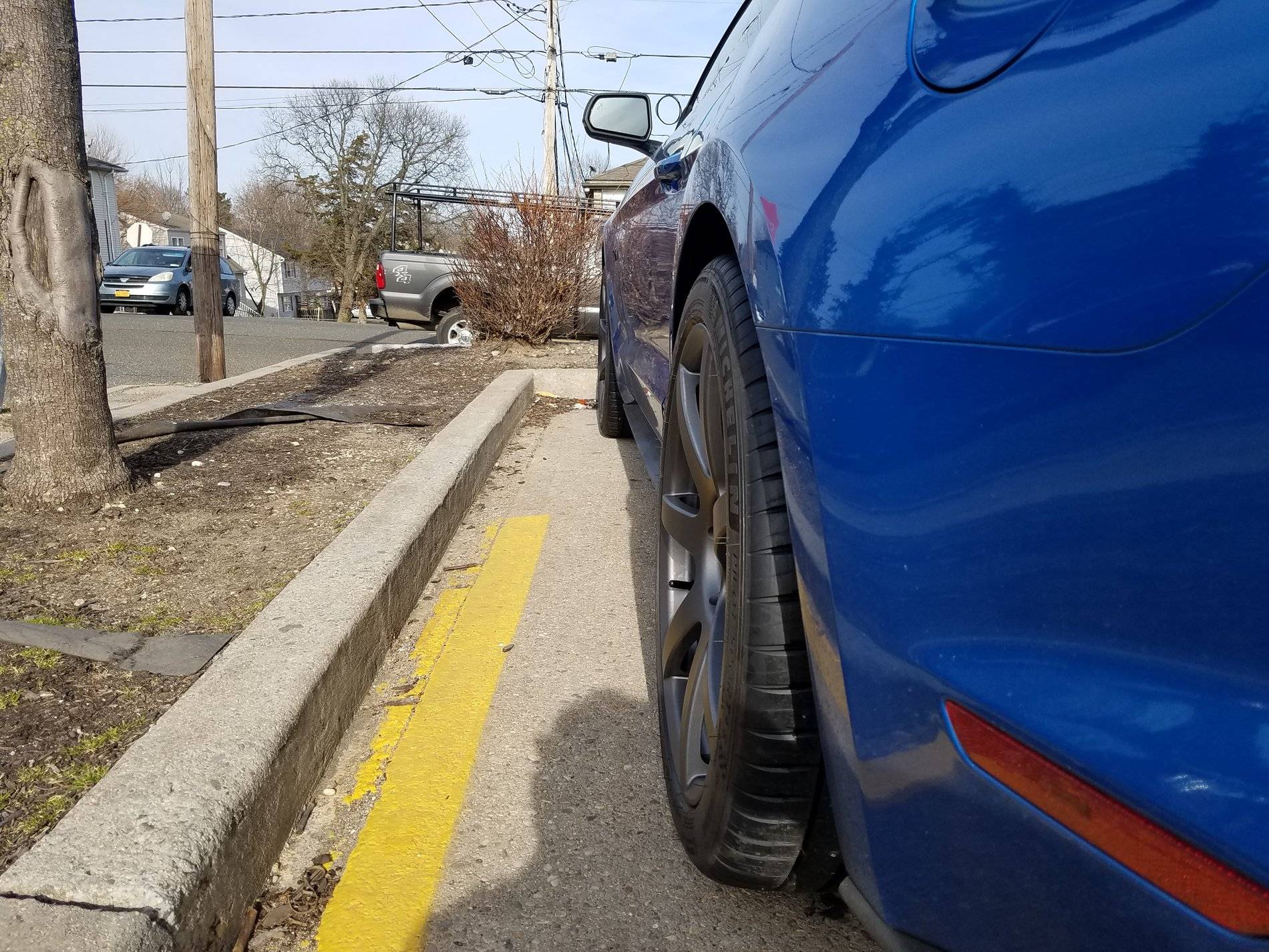

This is my 285 square setup:
Not "hellaflush", but not hella tucked either.

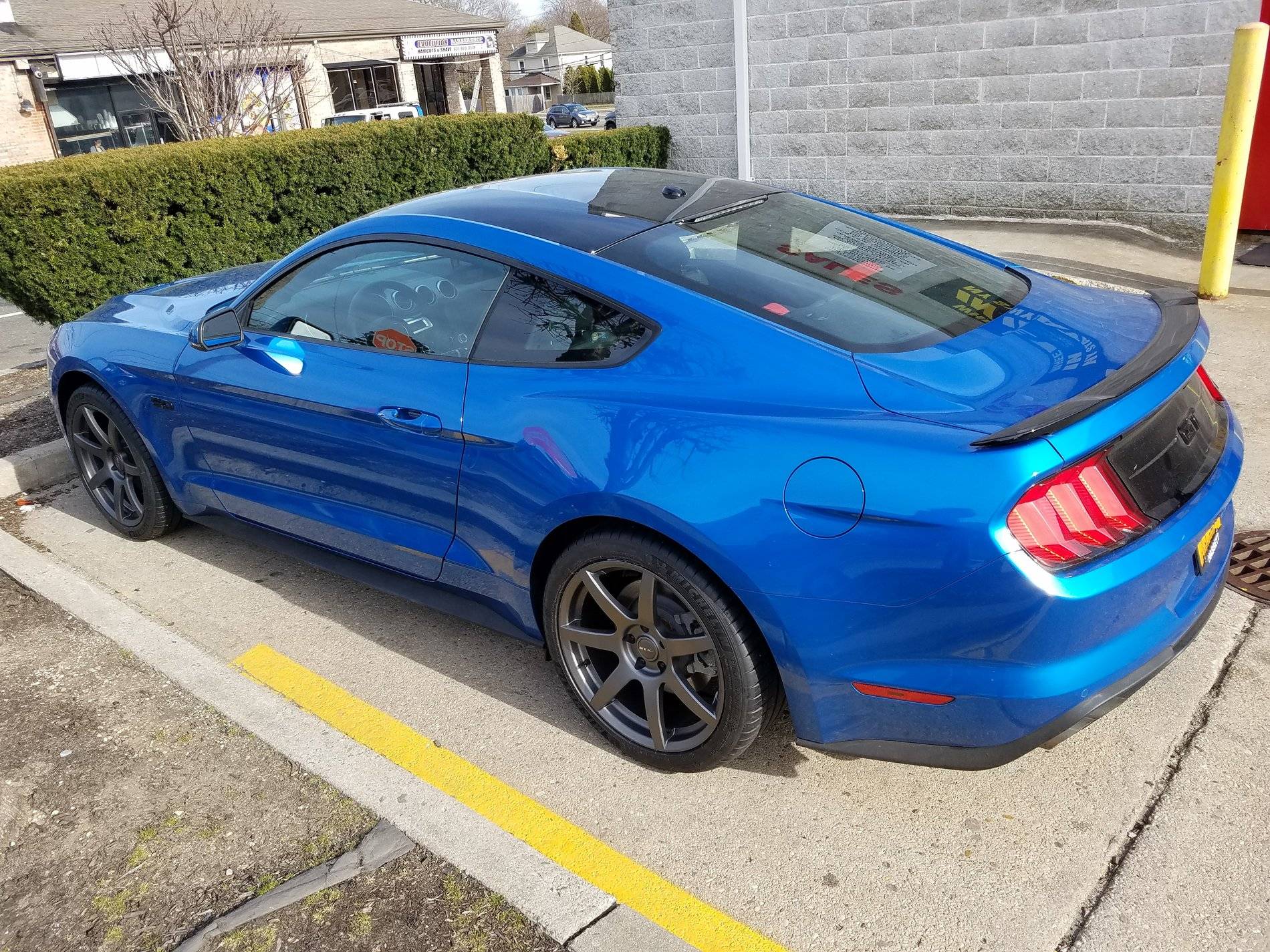

19x10 here. +35 275/40/19

Not as wide as other people’s set up but it’s good for my driving style and squared for rotations.

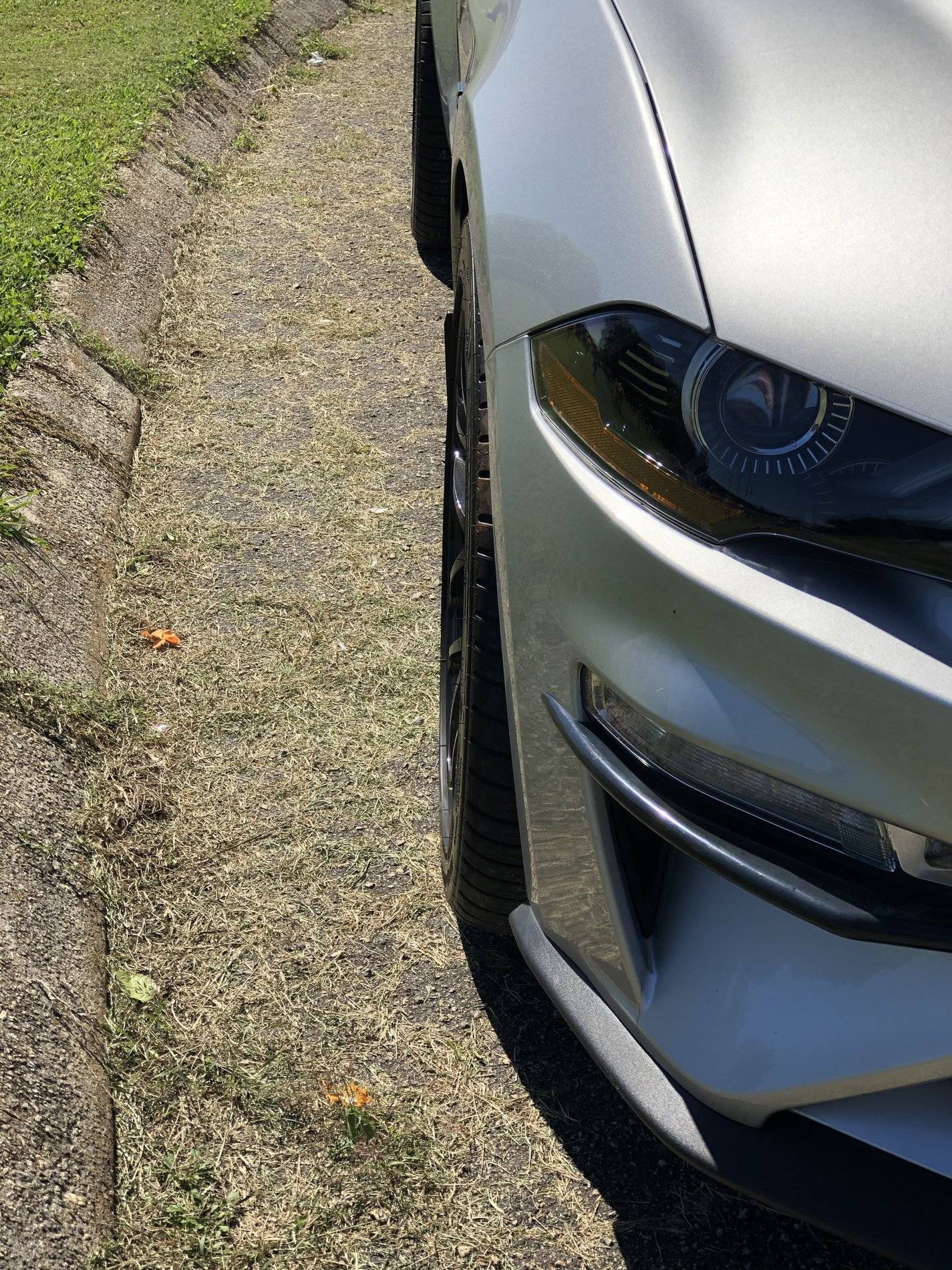

Below is my car with 285’s on 19x11 +52 and a 20mm spacer. The clearance is so close to the strut, you couldn’t go any wider. I’m currently running -1.7* camber up front. If I had 305’s, I’d need at least a 25mm spacer which has been done many a times on this site. A 19x11 +52 with a 25mm spacer gets you an affective offset of +27. Enter Apex’s non rotatable square set up
