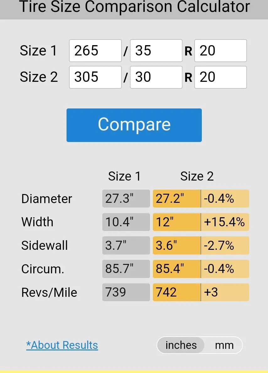

For those wheel sizes, this looks like your best choice for keeping the overall diameter close to stock in both front and rear.
Edit: With +35 offset 305s will poke a little in the rear. I'm running 285 on 10-inch width at +35 and it's flush.
