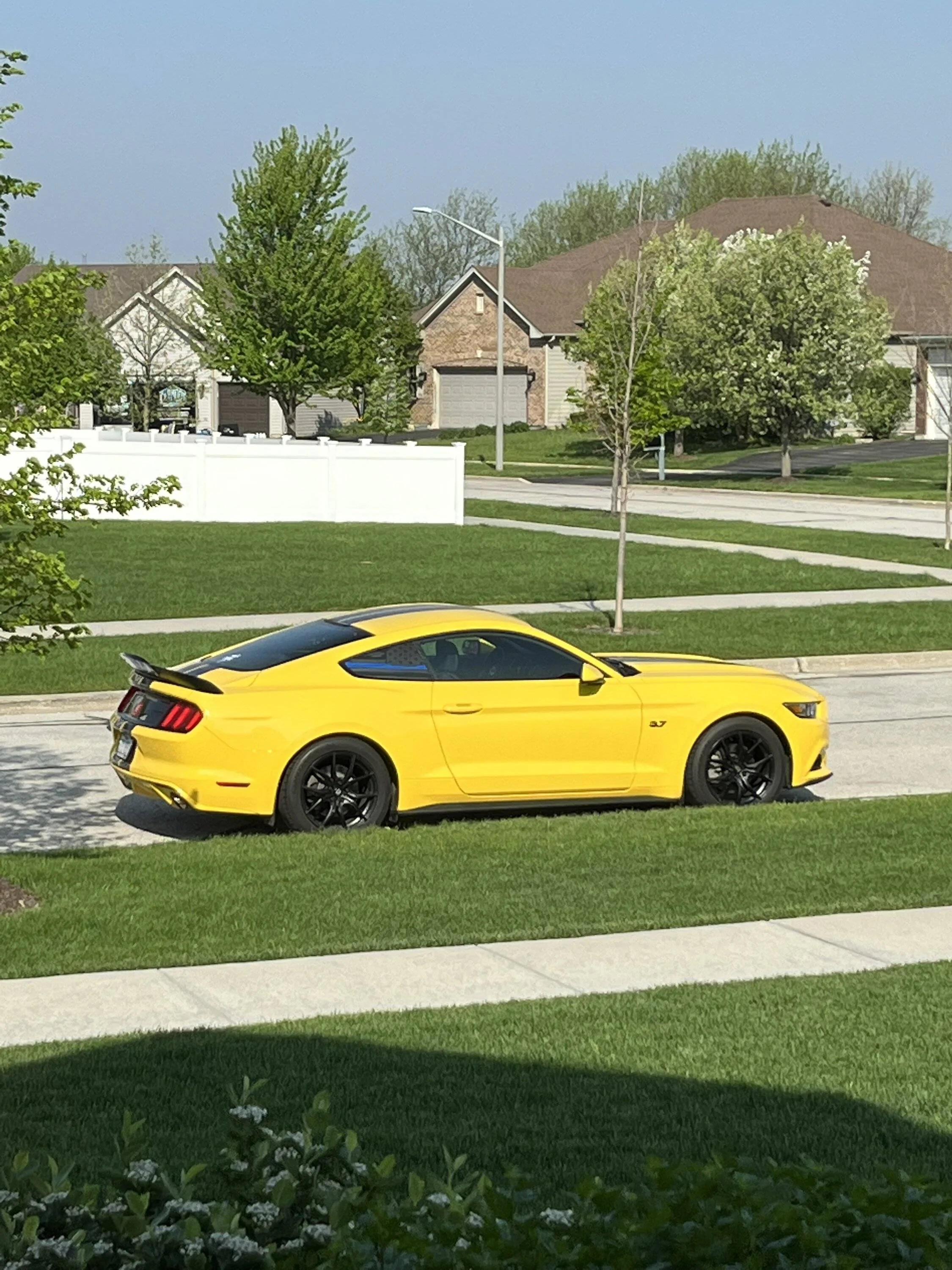

Just bought my wife a 2017 GT/CS Convertible. It has just over 4K miles on it and still has the OEM Pirelli's on it. No cupping....no flat spots....problems etc. Rides nice but, the tires are date coded 03/11/16. She drives maybe 5K miles a year as we both are retired. Replace or just roll with them? TY
LOVE the new ride! I just bought a competition orange GT/CS manual convertible a few months ago with low miles as well. You are going to enjoy that yellow one for sure!
As a general rule it is usually 6 years for tires but if not driven much or hard, you could extend them out to 10 years as long as there is no cracking, dry rotting, or issues holding pressure. You should be fine for the near future OP. 🍻

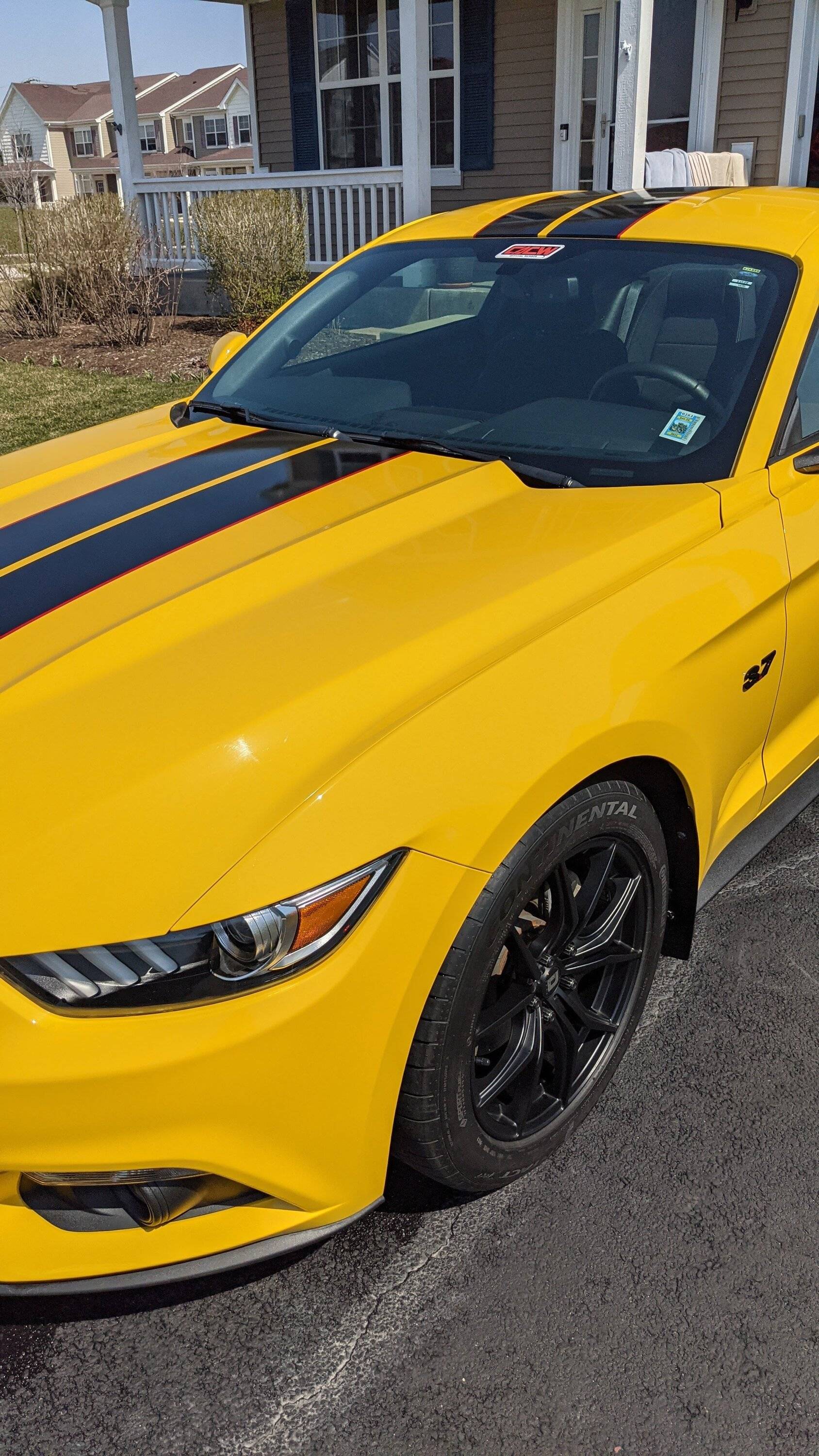

Thanks all! I'm not a big fan of Pirelli's and the OEM tires supplied by them to Ford are cost based built to get the car thru the 12/12,000 bumper to bumper. They look fine to my eyes as far as structure and I did speak with the original owner...lol (REMEMBER TO ERASE Sync INFO WHEN YOU SELL A CAR!!!) The car was bought by a collector and was stored inside of his heated and air conditioned Wherehouse. Never has seen rain etc...... Nice guy that ended up trading it for some $100K Mopar.
I think when I have it apart to re-hang the fender and ppaint the calipers, I'll get new tires........Ladies LUV new shoes!!!!

Car is gorgeous. I loved Triple Yellow when I had mine. It was an attention grabber for sure
