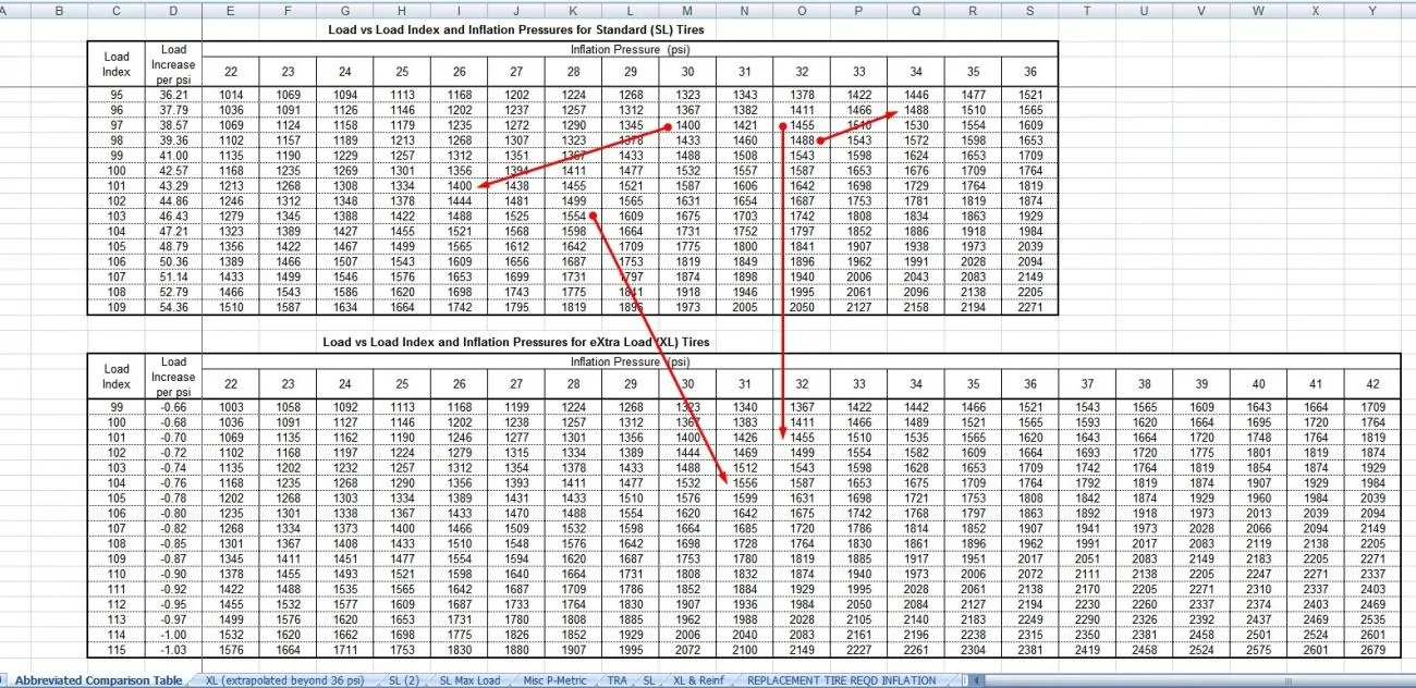

Even that only covers you for the actual load (this would probably be gross vehicle weight and axle loads on the psi placard) vs rated load @ spec psi, with some sort of factor to account for load transfers due to acceleration/braking/cornering.
Don't worry about rated load @ hot psi. It's going to be higher than the rated load @ cold psi, and the psi rise from normal driving is considered when the cold psi on the placard is posted.
Here's what parts of the SL and XL tables look like. The red lines are showing how you'd adjust inflation pressure when changing to tires with different Load Indexes or from SL to XL.
There may be understeer/oversteer handling balance considerations for the OE tires and inflation pressure causing them to be inflated to a slightly different value from what a table lookup based solely on GVW, front and rear axle weights, and that unknown safety factor would give.
