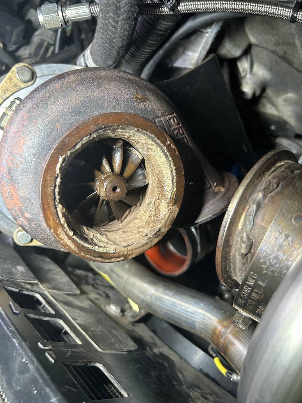

Had mine fail on dyno during tuning. From what my tuner and precision said that coyote engine produce alot of oil pressure putting stress on JB

looks like a top mount system, is that correct? Just curious as I have seen a few of the top mount with issues not so much with the bottom mount ..... yet haha. That exhaust exit looks insane
