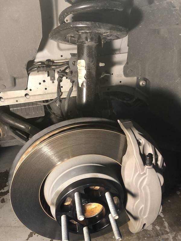

On Sunday, I spent a little time on the car, testing how the 11" SVE GT-7 wheels are going to fit next to the strut with the 25mm spacer that is needed to use the same wheel front and rear. This lets me rotate the tires front to rear and get a little more life out of an expensive 305/30-19 tire. It was a pretty simple operation - up on jack stands, pull a wheel, pop the spacer on, and measure the gap between the wheel lip and the strut. Pics:
The GT350R wheel studs are plenty long for the extra 25mm spacer...
Spacer and 11” Wheel Fitment -01 by clair_davis, on Flickr
Hub-centric spacer from Optimum Performance installed:
Spacer and 11” Wheel Fitment -02 by clair_davis, on Flickr
Spacer and 11” Wheel Fitment -03 by clair_davis, on Flickr
Plenty of clearance:
Spacer and 11” Wheel Fitment -04 by clair_davis, on Flickr
How much clearance? 11.69mm... enough that I'm going to order a 20mm spacer and see if that one will also work as well, tucking the tire and wheel under the fender a little bit better.
Spacer and 11” Wheel Fitment -05 by clair_davis, on Flickr
At full droop and the suspension unloaded, the wheel is about 3/4 of an inch outside the fender.
Spacer and 11” Wheel Fitment -07 by clair_davis, on Flickr
It will draw up under the fender a bunch with the full weight on the car, but it will still need a chunk more negative camber. This not only pulls the top of the tire in a bit more, but also gives more lateral grip when cornering, a win-win. I'll document that operation when I get the parts lined up.

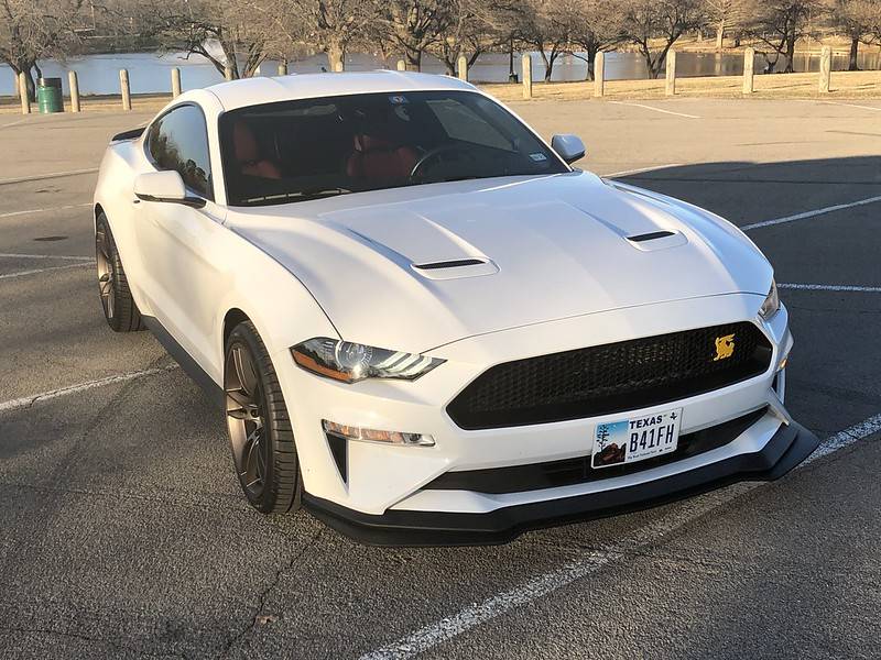

Confirmed today that the 20mm spacers leave a fat 1/4" clearance to the strut, so I'm going to start out with those when I get the 305 project going.

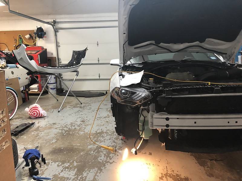

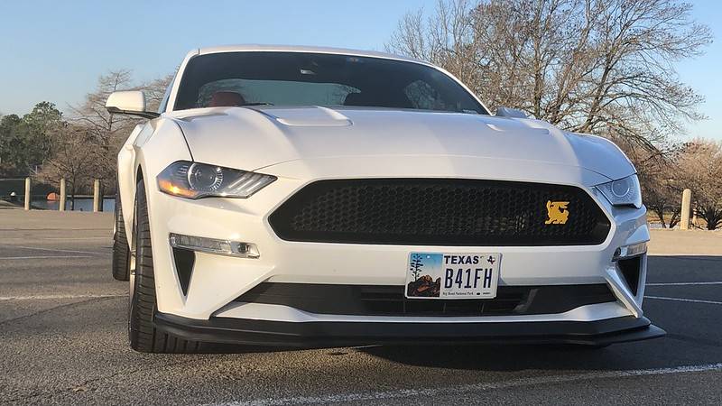

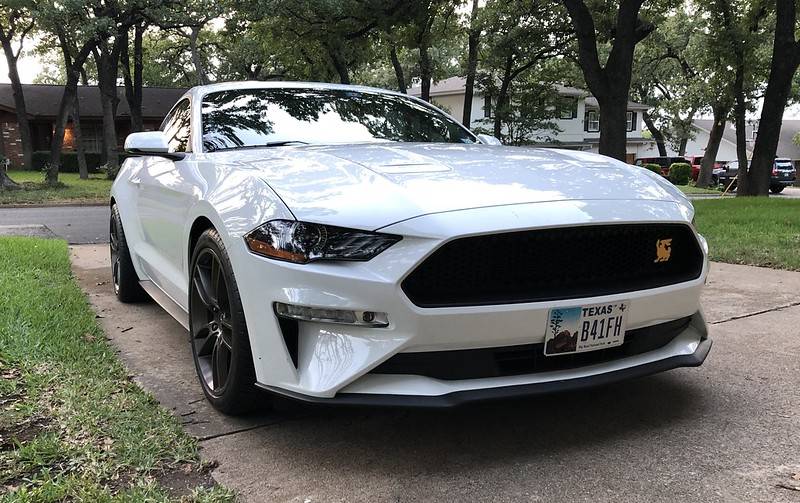

I had the front wheels off to swap out my grille - a project that has been waiting for months - and to install the PP2 splitter that I picked up a couple weeks ago. Having the nose off the car was going to help both projects, so off it came.
Grille and Splitter Install -01 by clair_davis, on Flickr

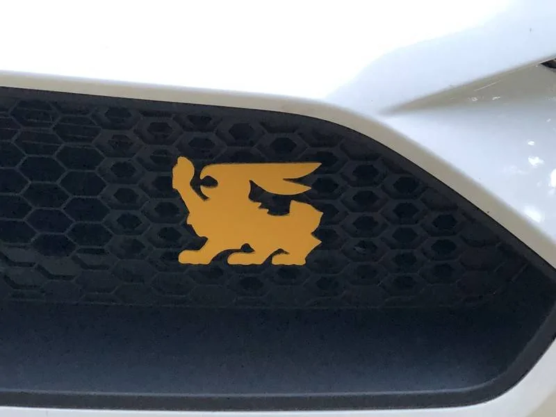

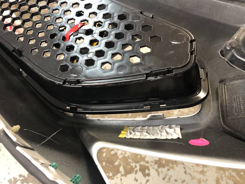

The grille is the Bullitt-style plain unit found on eBay for $130 or so, and the goal was to get rid of the pony in the center. I bought the grille over a year ago, and had some special badges made by a local shop I found on Etsy. These are a slightly tweaked version of the Terlingua Racing Team jackrabbit The badges are cut from 14ga steel and powder coated, so simple and specific, but pretty obscure as well. Really like how they turned out. I did the trunk finish panel swap a while ago:
Terlingua Trunk by clair_davis, on Flickr
After popping the original grille out using some nylon trim tools and my thumbs, I dropped the new grille in place and snapped it down to the original tabs. Everything lined up well and proceeded as expected, but it took some real force to push the tabs through the holes in the grille.
Grille and Splitter Install -02 by clair_davis, on Flickr
Grille and Splitter Install -04 by clair_davis, on Flickr

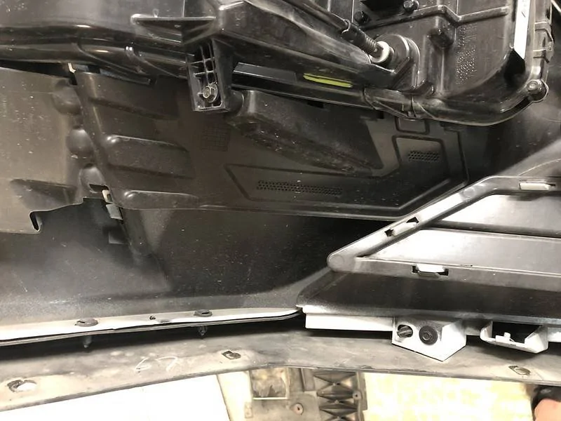

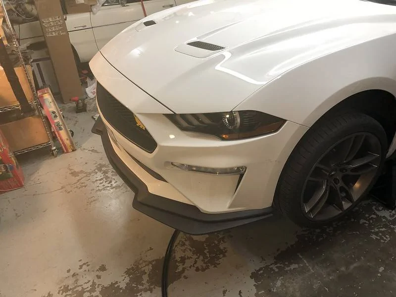

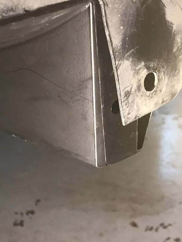

After the grill was taken care of, I started on the splitter by removing the stock lower air dam. The goal was to fit that to the PP2 splitter so I could mark where any holes had to be drilled, etc. Pretty straight forward removal, but there are a mix of trim clips and screws holding it in place:
Grille and Splitter Install -05 by clair_davis, on Flickr
Unfortunately, it appears that the EBPP and GTPP don't use the same lower air dam piece, or perhaps the PP2 lower air dam is unique. I'm not sure which it is right now, beyond that the EBPP does NOT fit. It's obvious once you look at a GTPP lower next to an EBPP - the GT has a flat surface on top that the EBPP does not, and the leading edge is just a different shape that doesn't match the PP2 splitter:
Grille and Splitter Install -07 by clair_davis, on Flickr
After that project took a dump, it was time to put everything back together again and be happy with the progress I made. Overall, I'm really happy to have my Terlingua Racing tribute complete, and at least have a path forward on the splitter project. Here's the finished grille:
Grille and Splitter Install -09 by clair_davis, on Flickr
Grille and Splitter Install -10 by clair_davis, on Flickr
Grille and Splitter Install -14 by clair_davis, on Flickr
Enough for now...

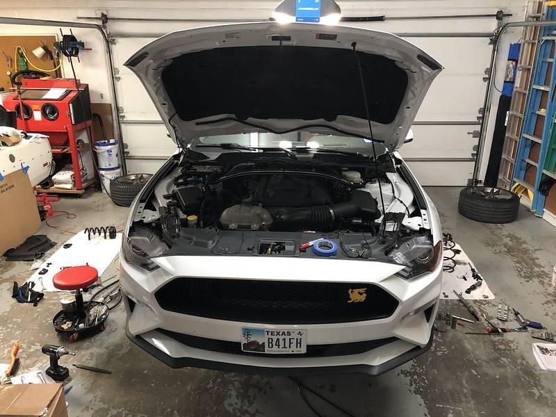

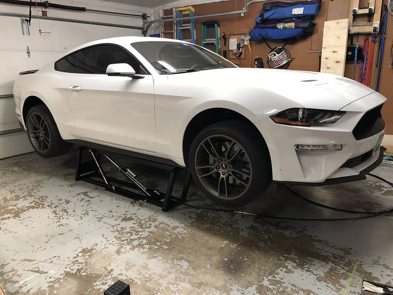

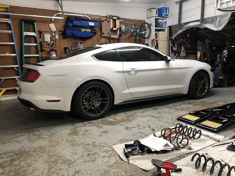

Springs are now installed - took a lot longer than I had hoped, but I have to be careful to not break my daily... even in COVID times. As tragic as breaking my car might be, it's not as bad as forcing my wife to leave her car outside overnight... twice... It all worked out well in the end - no broken parts beyond a clip for a sensor wire on the pass side strut. Details of the task:
Job 1, getting the into working space with the new Quickjack:
GT350R Spring Upgrade by clair_davis, on Flickr

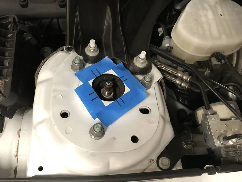

Before I tore anything apart, I marked the location of the strut in the tower so I could get as close as I could to the stock alignment.
Then the fun began:

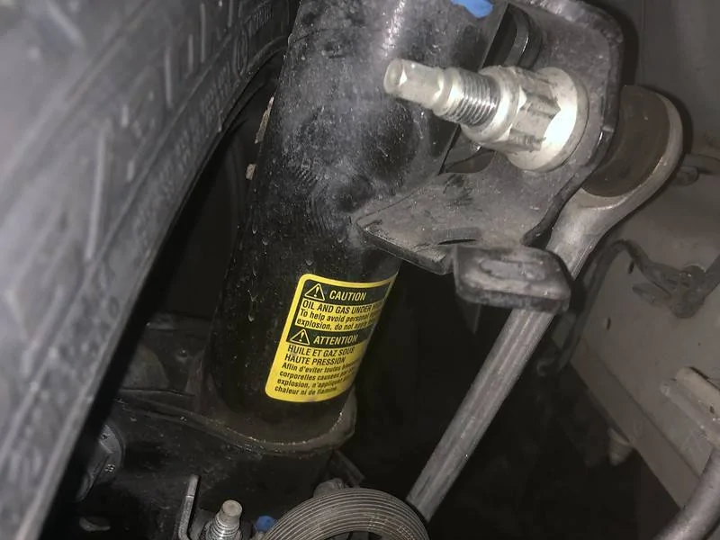

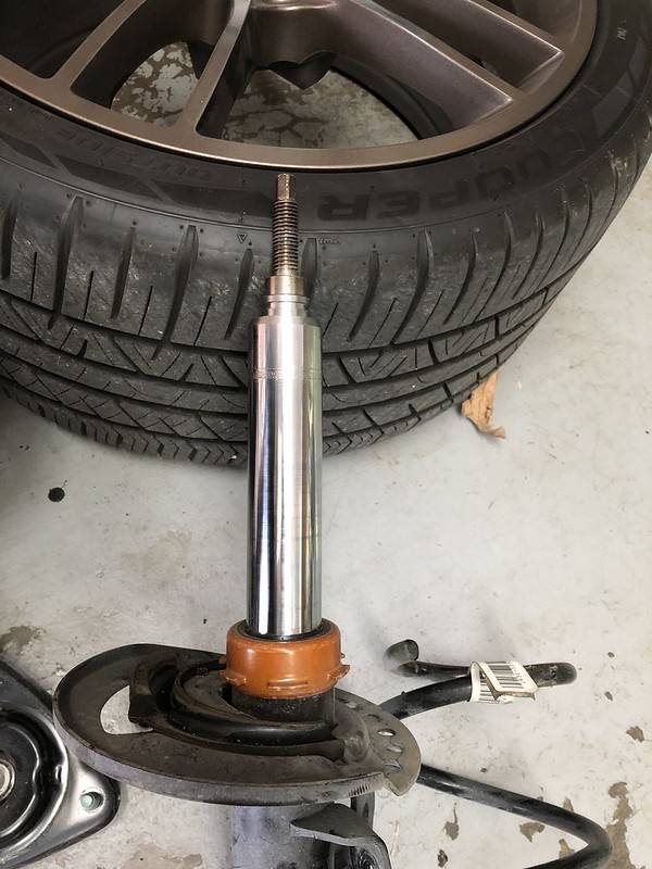

The Magneride struts are really unusual under the dust boot:

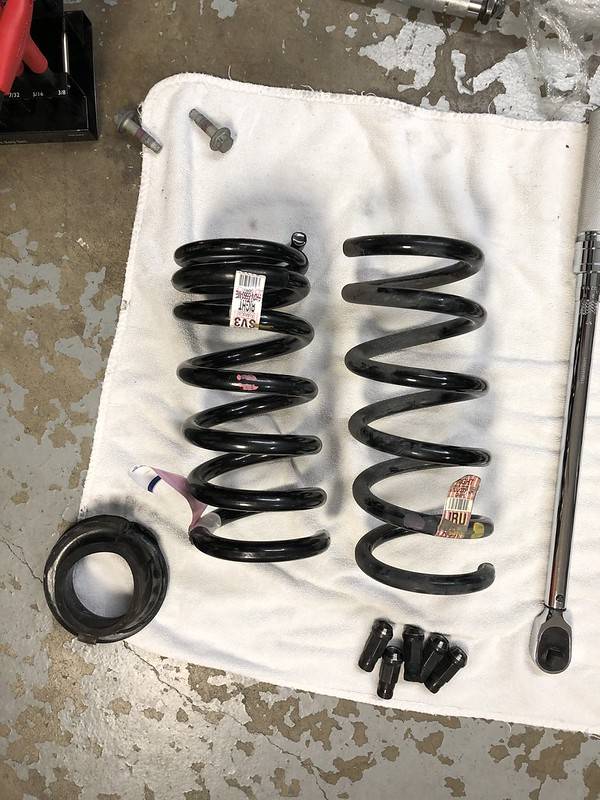

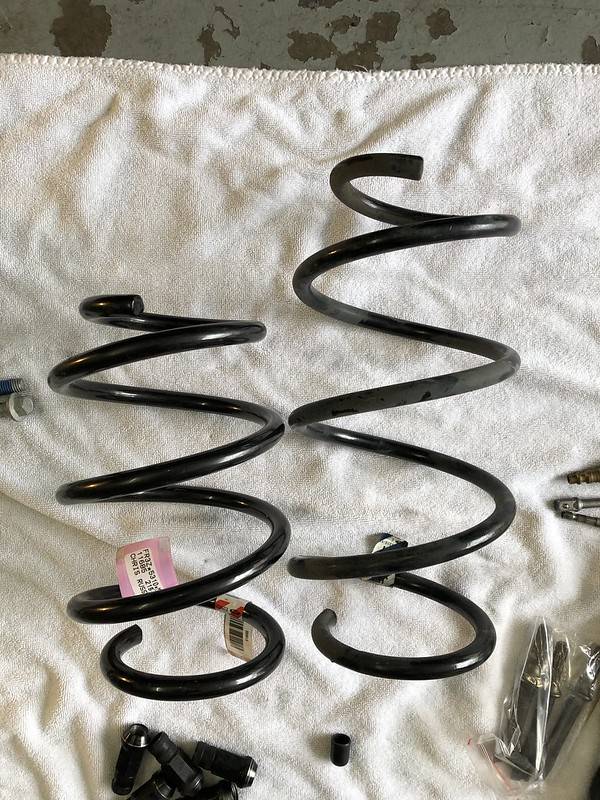

The front Shelby springs are significantly shorter than the EBPP+MR springs:

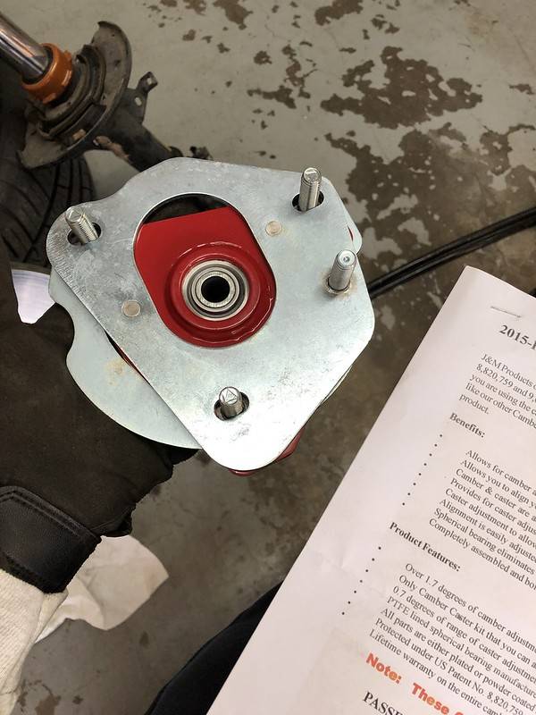

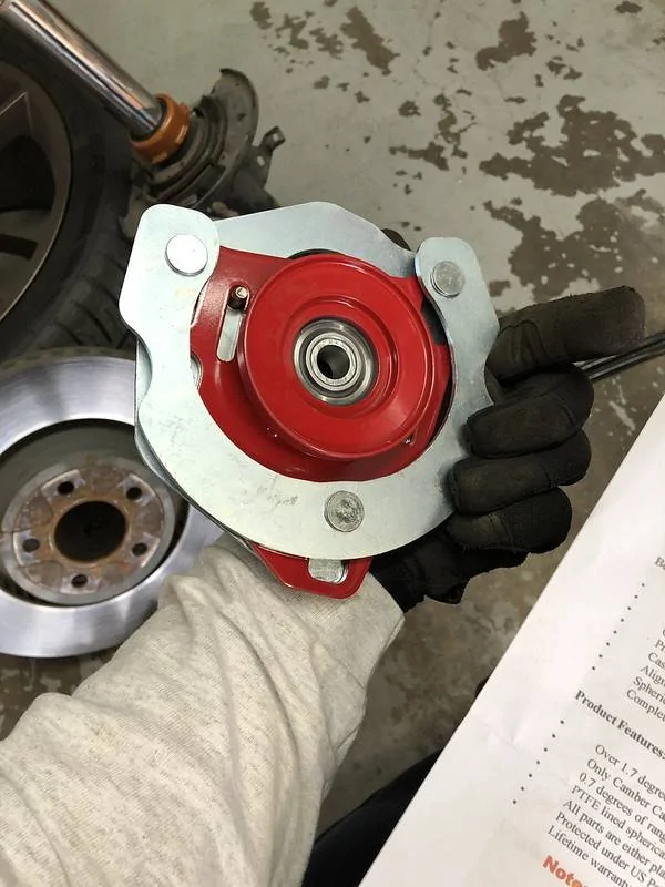

The J&M caster/camber plates were really nice and were an easy install:
In the back, the Shelby springs were again much shorter than stock - and a lot thicker, too:
I was hoping to use a spring compressor to get the stock rear springs but there wasn't enough space to make the compressor work. Ended up dropping half the rear cradle anyway, but it wasn't a big deal.
After I got everything buttoned back up, I dropped her back down on the ground expecting a tiny drop from the Shelby springs - a half inch would have been OK to help keep the PP2 splitter off of the driveway incline. I drove her around the block to settle things down, and then measure the drop. It definitely looked pretty mild:
When I measured the drop, I had to do a double-take on the measurements. Zero drop. As in exactly the same in front, and about 1/10" in back. Wow. This car weighs a few pounds MORE than a GT350R, so I figured the drop would be about the same as the R, but I didn't expect the stock EBPP+MR suspension to be the same as the R as well. I can live with that, but it does mean that the wheel well gap will be that much larger when the 305's go in.
The time I put into locating the strut in the tower paid off and the car felt exactly the same as before the swap. I still needed to get a proper alignment, since the extra camber up front is what I need for the 305 swap. I took the car to Lonestar Elite Automotive to take advantage of his new Hunter alignment equipment. Bonus, he's an S550 owner as well:

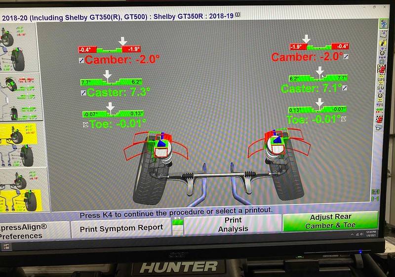

At the alignment shop by clair_davis, on Flickr

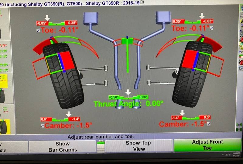

Results were spot on with the specs I gave him - real close to the GT350R track numbers:
2021-01-08_Alignment-Front by clair_davis, on Flickr
2021-01-08_Alignment-Rear by clair_davis, on Flickr
The new alignment feels lighter - it's easier to steer, even in Track mode. Not sure I understand that, but I like it. Need to put some more miles on it and learn the new feel.

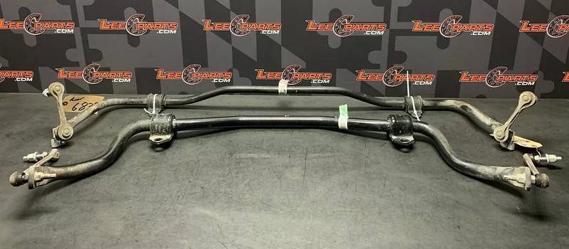

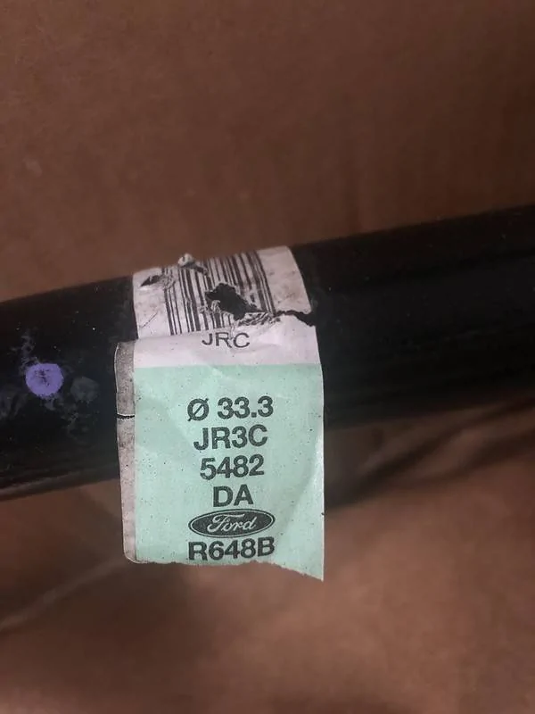

Sway bars arrived - 2020 PP2 from a salvage yard ePay store:
PP2 Sway Bars by clair_davis, on Flickr
Front PN JR3C-5482-DA:
Rear PN JR3C-5A772-DA:

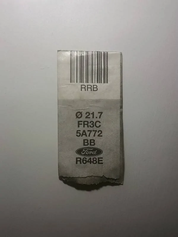

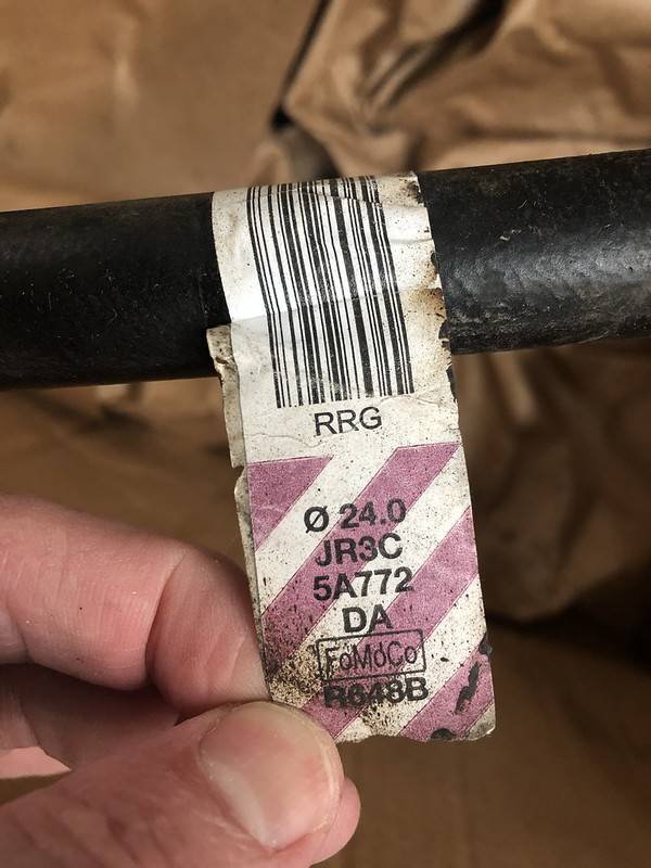

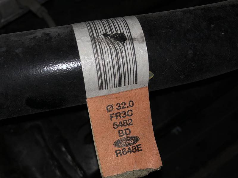

Getting ready for the sway bar swap this weekend, I checked the bars that were on the car from the factory. I was under the impression that the EBPP cars came with something similar if not exactly the same suspension as the GTPP (minus the Brembos) - but it's looking more like just the base GT suspension with 19x9 wheels. Pisser.
Front 32mm bar:
Ecoboost Performance Package Front Sway Bar PN by clair_davis, on Flickr
Rear 21.7mm bar - lucked out and found this tag in the driveway after it fell off the car:
Ecoboost Performance Package Rear Sway Bar PN by clair_davis, on Flickr

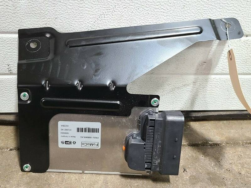

And for yet another wild card, I found a Magneride VDM from a 2018 GT350 for a good price - well below $100. Will it work? Don't know, but the risk was worth a few bucks. The GT350 has shocks/struts similar to the EBPP and GTPP units, not the reduced slots found in the GT350R. Hopefully this VDM will have a calibration a little more refined than the EBPP. For what it's worth, the EBPP calibration seems to work just fine, perhaps a little underdamped. We'll see.
2018_GT350_Magneride_VDM by clair_davis, on Flickr

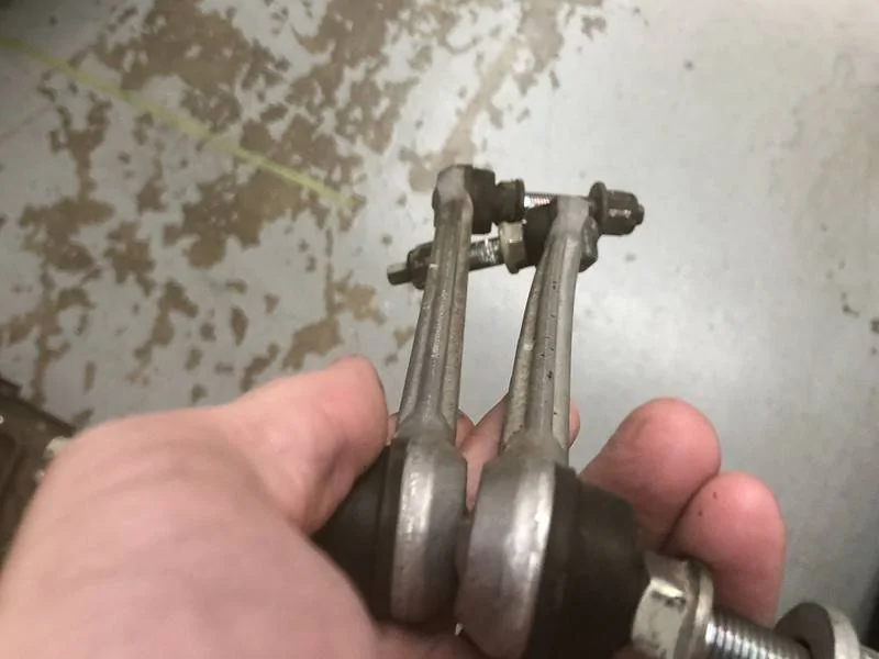

Interesting thing was that the front bar I got (ePay auction from a salvage company) had one bent end link and some nasty undercoating on the bar. I have heard that the factory end links are prone to bending, but wasn't sure how big a problem that might be. but the bend on this one was obvious:
Granted, this is from a wrecked car so who knows what happened. I kept my original links for now but will keep an eye on things.

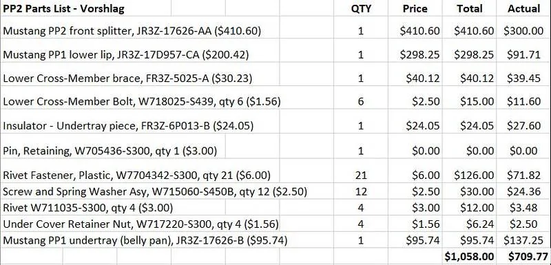

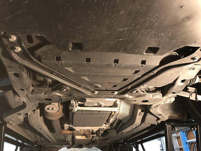

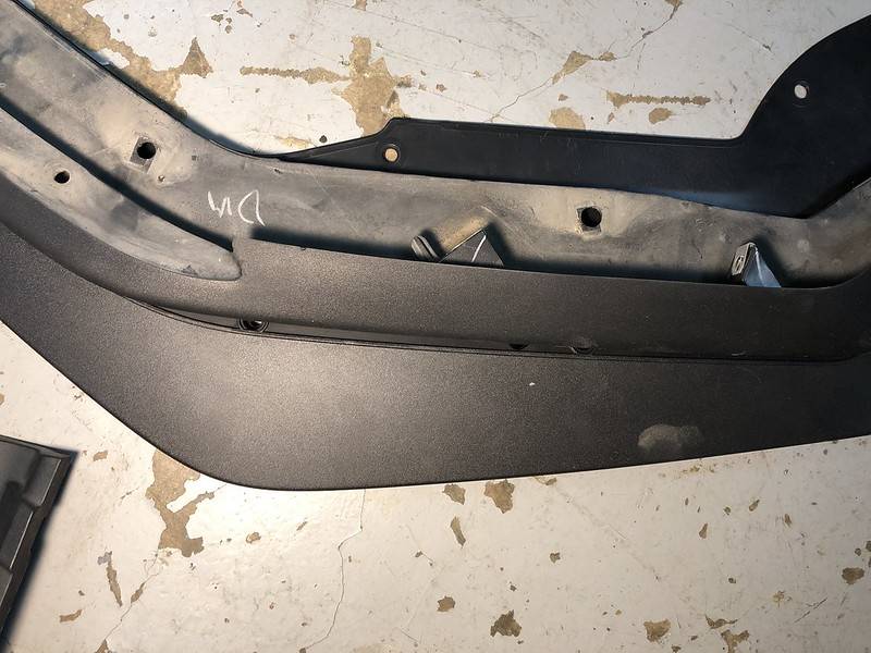

The PP2 splitter was something I have wanted to add to my car from day 1 - I remember going through the online builder and seeing the PP2 option and adding that to my EB build only to find the V8 mandatory... Pissed! Why wouldn't a handling package be available with any engine? Well, we know that went and that's what sent me on this mission.
The splitter was the visual icing on the cake for the PP2 redo, and it really only made sense after everything else was done. My driveway is pretty steep, and even the puny EB/Base GT splitter would drag if I wasn't careful. When the GT350R springs didn't lower the car at all, I had a chance of everything working OK.
This was NOT a cheap upgrade. The splitter alone lists for around $400, and a base GT or EB has a host of other parts to make the splitter work as well:
PP2_Splitter_Expenses by clair_davis, on Flickr
If you're starting with an EBPP, you don't need the Lower Crossmember Brace, Bolts, or Insulator - they're already on the car.
PP2 Splitter Install by clair_davis, on Flickr
If you're starting with a GTPP, you can also (obviously) skip the PP1 lower lip and undertray. That makes for a half-price project compared to starting with an EB, so a pretty big deal. The guys at Vorshlag did a good job of showing what you have to do to install the pieces:
https://www.vorshlag.com/forums/for...aero-body/58939-2018-mustang-gt-pp2-undertray

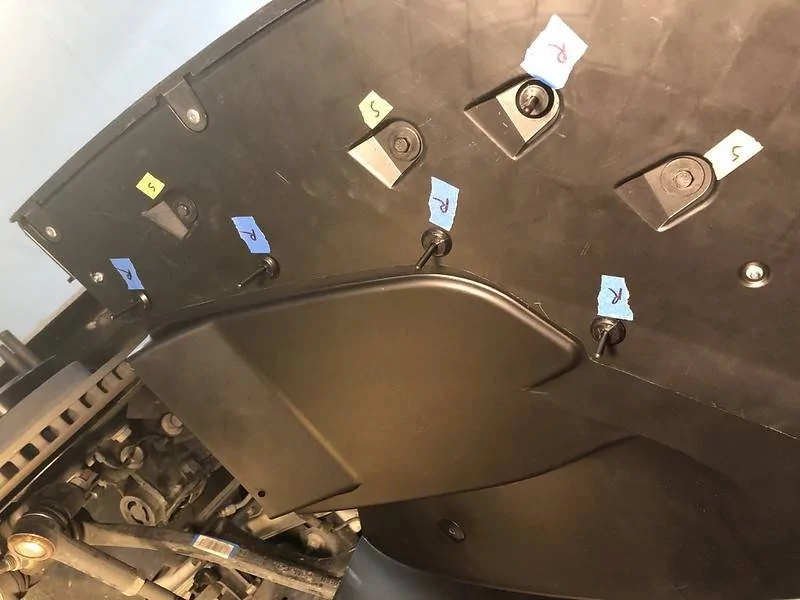

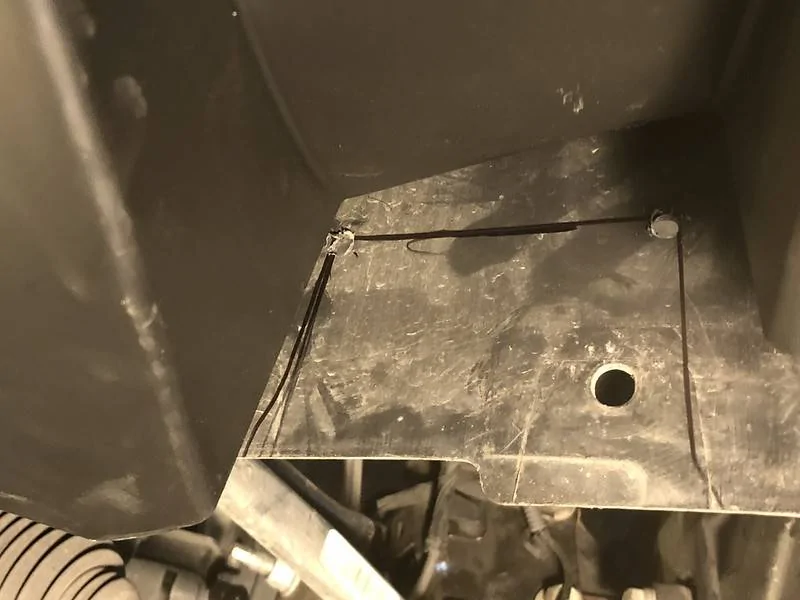

I found a couple things that differed in my experience that I'll outline here.

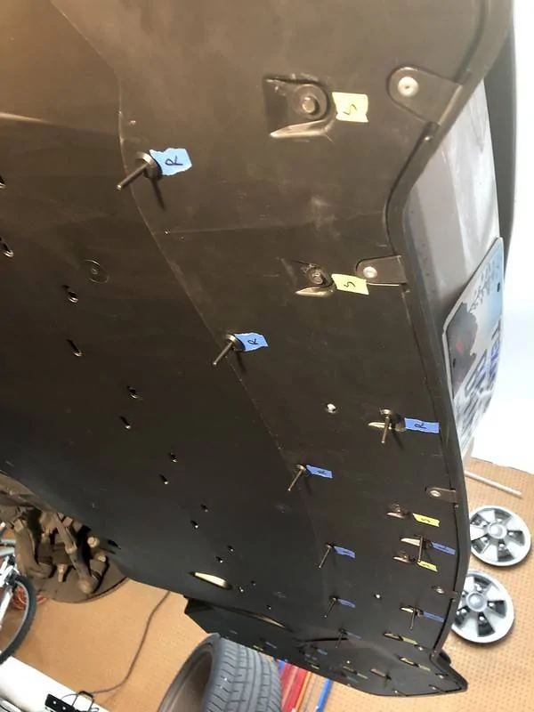

First, order of assembly matters. Install the PP1 lower lip / splitter, then the undertray, then the PP2 splitter. There are a crap-ton of fasteners and you just can't get to everything unless you do it in order. If your PP1 lower lip is like mine and doesn't have pre-drilled holes, you'll have to locate those and drill them. I used masking tape barely stuck down so that the locating pin on the PP2 splitter would leave a dark spot, and then drilled holes slightly larger than the pin.

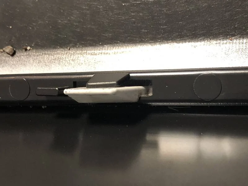

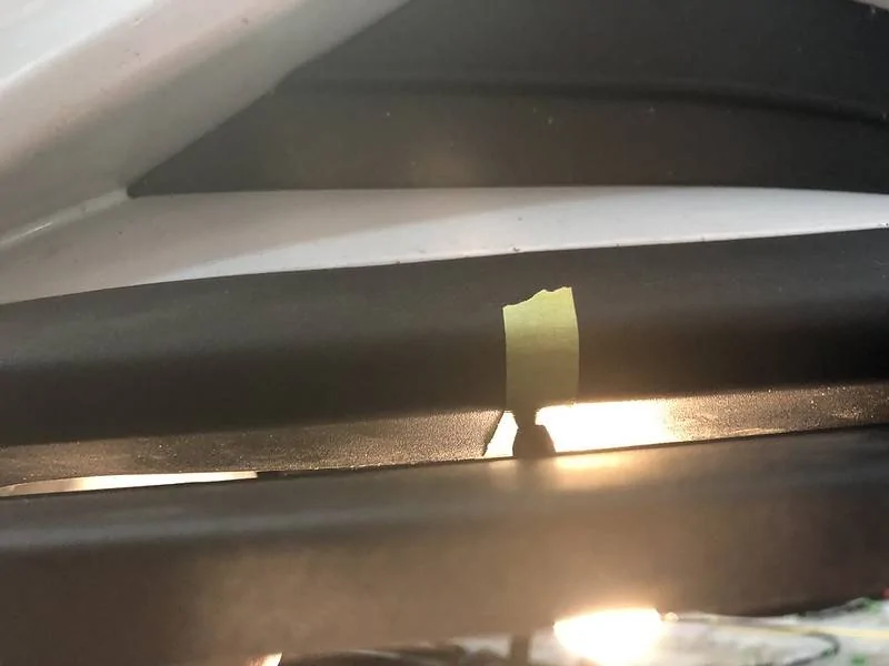

Speaking of fasteners, there are 21 (!) POM rivets required to install the PP2 splitter, and they require a special tool. The Ford parts seemed to be pieces of crap. They didn't expand right about 25% of the time, and some didn't grip at all. Ford lists those rivets at $6/EACH. I ended up redoing ALL of them and using slightly larger (6.3mm) rivets from Harbor Freight. Two variety packs with 40 rivets in this size is about $22, so no real heartburn.
Pro-Tip: to install this big, relatively floppy piece of plastic, you'll hang the ends inside the wheelwells as the instructions say, but then you need to support the middle. I used my height-adjustable rolling stool to hold up the center while I started all of the screws. Then push all of the rivets in place and do any adjusting necessary. Shouldn't be a problem getting all of the rivets in place at this point, and the slightly thicker HF rivets worked great.
I popped a couple down on on either side of the stool, then removed it and snapped everything else down. With the rivets tight, go back and snug all the screws down and you're just left with finishing up.
One benefit of the PP1 undertray is the large brake cooling channels that are molded in. You can see them here:
The problem on anything but a PP1 is that the fender liners block these channels. I cut notches in the liners so that the channels could push as much air up into the brakes as possible:
I had to relocate a push-clip hole to work on the PP1 undertray anyway, but no big deal.
Button up all the rest of the push clips, and voilĂ :
Finally had a break from the rain, so I washed the car and took a few pics of her FINAL - pretty sure anyway - visual form:
PP2 Splitter Installed- Clean by clair_davis, on Flickr
