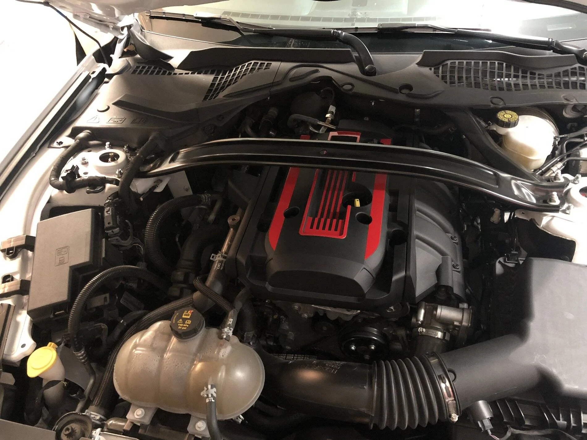

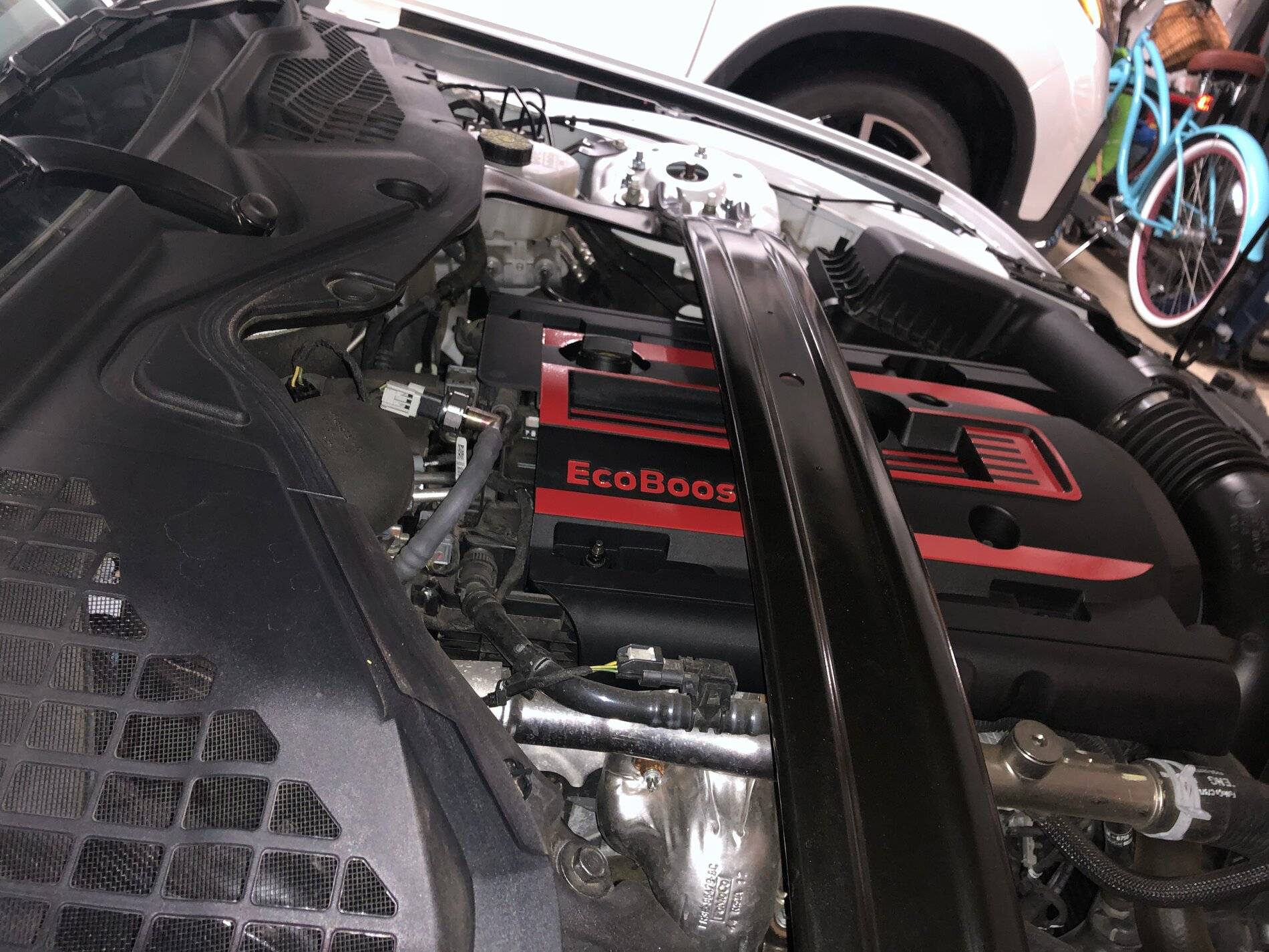

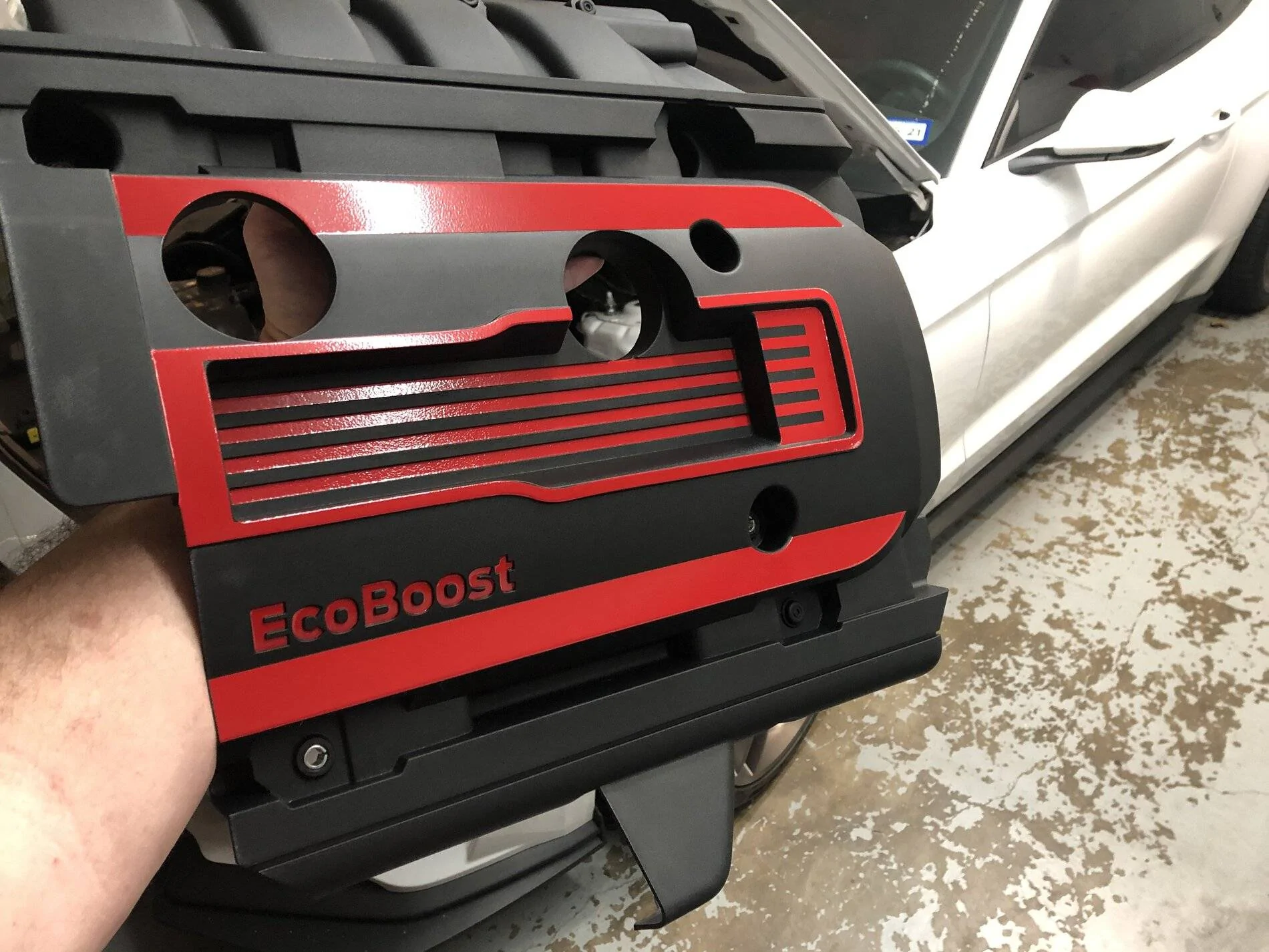

Tonight’s project: a little color under the hood courtesy of a decal kit from http://www.anchor-room.com/. It was like $20, so no harm done if it didn’t work out, but after about an hour I had great results. Watch their video for install tips and take your time.

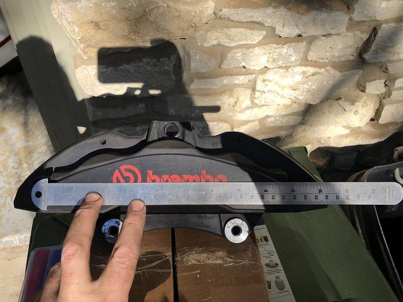

I found the GTPP calipers when another forum member was swapping his dark gray calipers for the red Bullitt calipers that he was sourcing through Steeda. There was a problem sourcing one of the rear caliper brackets, so it took until late June or July for him to do the swap. Once he was done, the front and rear calipers from his car were on their way to me, and then they sat in my garage while I sourced all the rest of the bolts, splash shields, rotors, pads, banjo fitting gaskets... a real pile of parts.
And then life started wearing me out like a pit bull's chew toy... way too much family stuff that has been way too serious and taking up most weekends since July. Fortunately, it has been settling into a groove now, so I've had most of a day free for each of the last couple of weekends and I've made some caliper time.

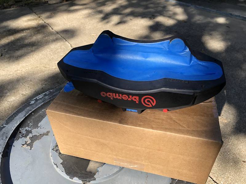

First task was prepping the dark gray GTPP calipers for paint. Initially, I was going to just run with them the way they came as they were great looking (less than 10K miles on them) and having both front and rear sets would have been easy-peasy. Well, his new calipers looked fantastic on his white car, so... I changed my mind. Some G2 Red would do the trick, and I was going to prime everything with high temp primer to get nice even coverage and a nice bright red. Lots of scrubbing and masking ensued. I easily spent more time masking than anything else.
Brembo Upgrade by clair_davis, on Flickr

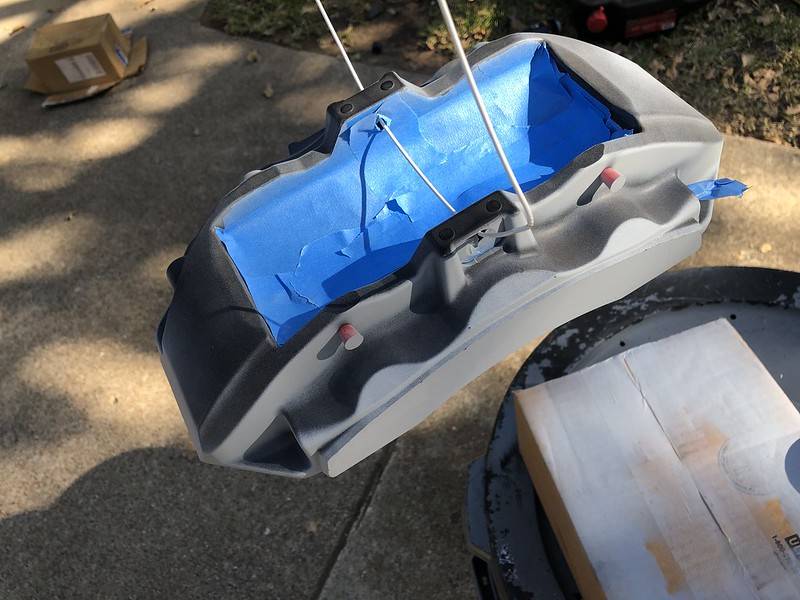

I'll say this now - DON'T USE VHT SP100 VERY HIGH TEMP PRIMER WITH G2 PAINT. I had some adhesion problems while the G2 was drying and I suspect that the primer may make the G2 more likely to chip or peel. So far I've had pretty good luck, but nothing is on the car yet. Not priming would have also saved me a weekend of work and that would have been huge. Oh well, I just hope the G2 sticks like it should.

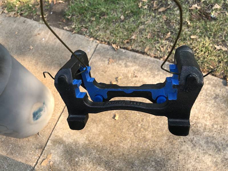

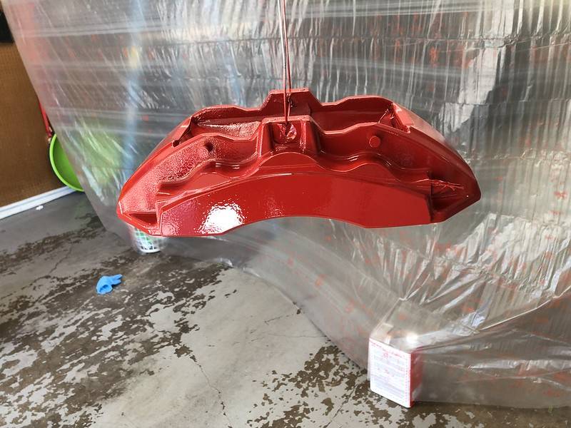

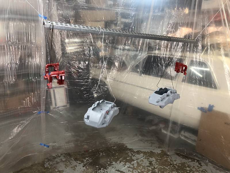

When it came time to apply the G2, I decided to spray vs. brush. I have HVLP equipment and decided to use it, even though it's one of the lower-end DeVilbiss Finish Line kits. The touch up gun had a 1.0mm tip which was pretty big, but maybe not big enough. It ended up doing a pretty good job, even with the limited experience I have with HVLP - basically some YouTube training - but I have painted a couple cars before.

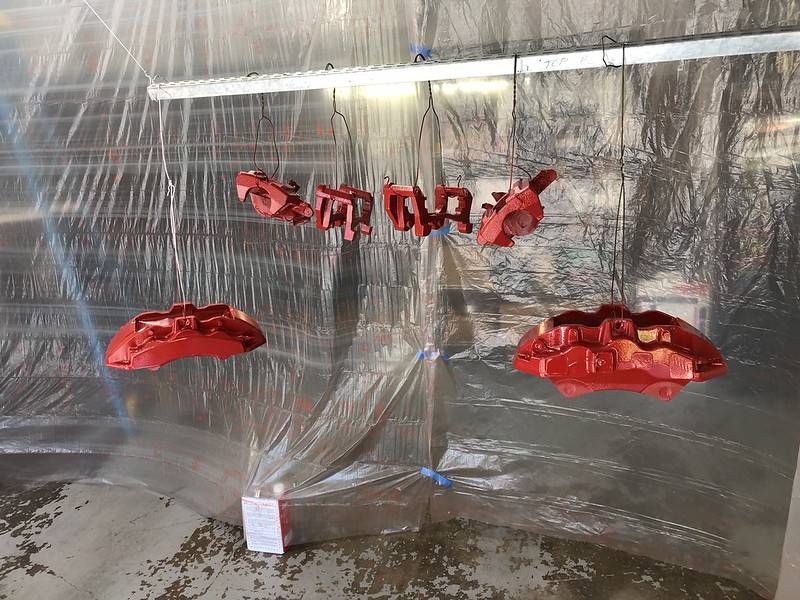

Last Saturday when the high temps were finally down near 70*F, I masked off a chunk of the garage and hung up all of the caliper parts for paint. It went well, but took 5 hours or so from masking the garage to cleaning out the paint gun.

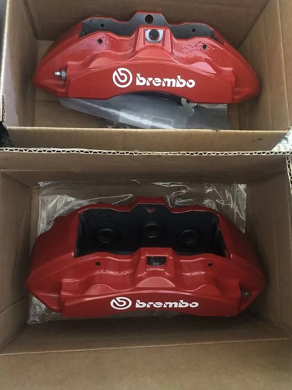

The G2 continues to smooth out over several hours, so don't panic if it isn't perfect right off the bat. It also stays sort of soft even when you're in the "safe to handle" period, and I ended up getting some finger prints when I removed the masking tape the next day. A couple days later, the G2 was noticeably slicker and smoother, so wait as long as you can stand to mess with the parts. Two days is a lot better than one.

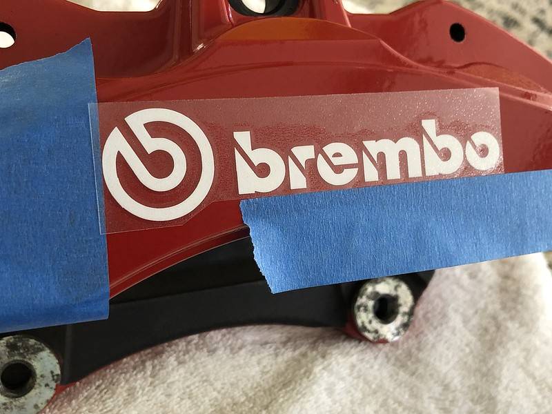

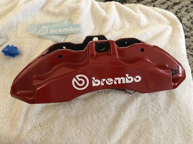

Decals went on yesterday - I put down some low-tack tape to make the boundaries I needed and trimmed the backing on the decals so I could bump them up to the tape and be located properly. The instructions were pretty simple and everything worked great.

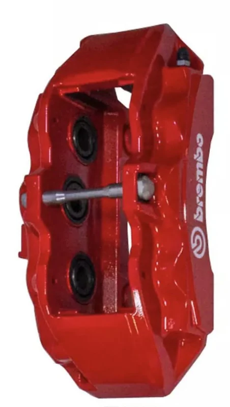

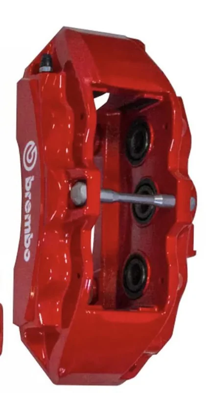

For decal orientation, it can seem counter-intuitive sometimes, so here are a couple photos from the Ford Performance kit:
Driver Side:
Passenger Side:

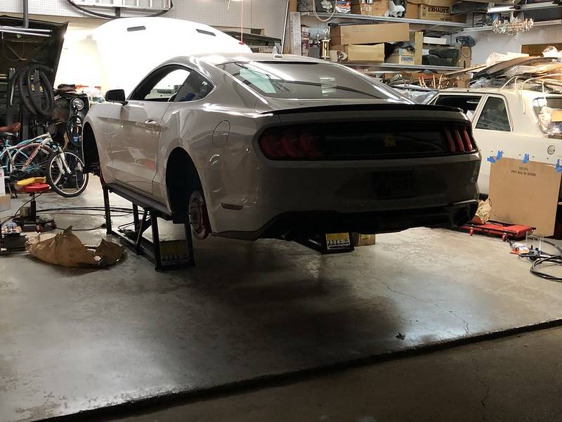

So last weekend I made some time to do this swap. As usual, it took a lot longer than even my generous estimate... started about 1PM Saturday, worked through 8PM, and then a couple more hours on Sunday rechecking torques and putting tools away. I had all the parts waiting and ready, using all new factory parts wherever I could. I did take advantage of some great deals that Optimum Performance Mustang had on the anti-rattle hardware kits, and some aftermarket pads for the front. Price & parts list at the bottom.

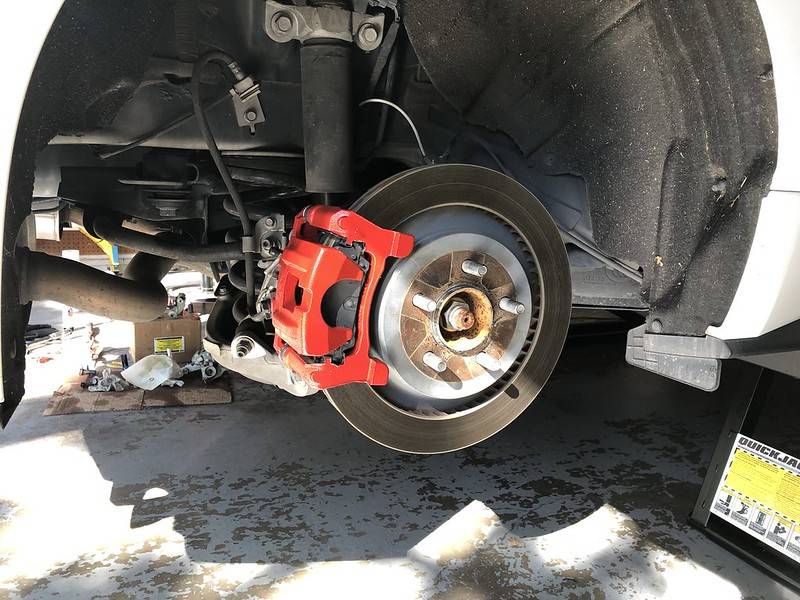

Not many glamor shots, I spent most of my time making sure I put everything together right. I put the car up on the Quickjack and started at the back of the car where the work was going to be more complicated:
- Remove / disassemble rear calipers, fight with the parking brake cables, ignore how the manual said to do things...
- Plug the brake hoses to minimize lost fluid
- Install new caliper hardware kit from OPM
- Grease sliding surfaces & seals
- Reinstall original brake pads
- Reinstall calipers, torque the mounting bolts and banjo bolts with new washers
- Repeat on the other side

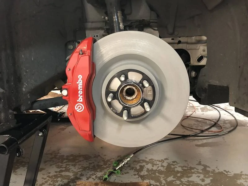

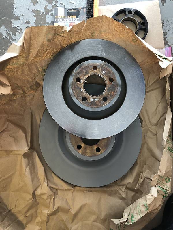

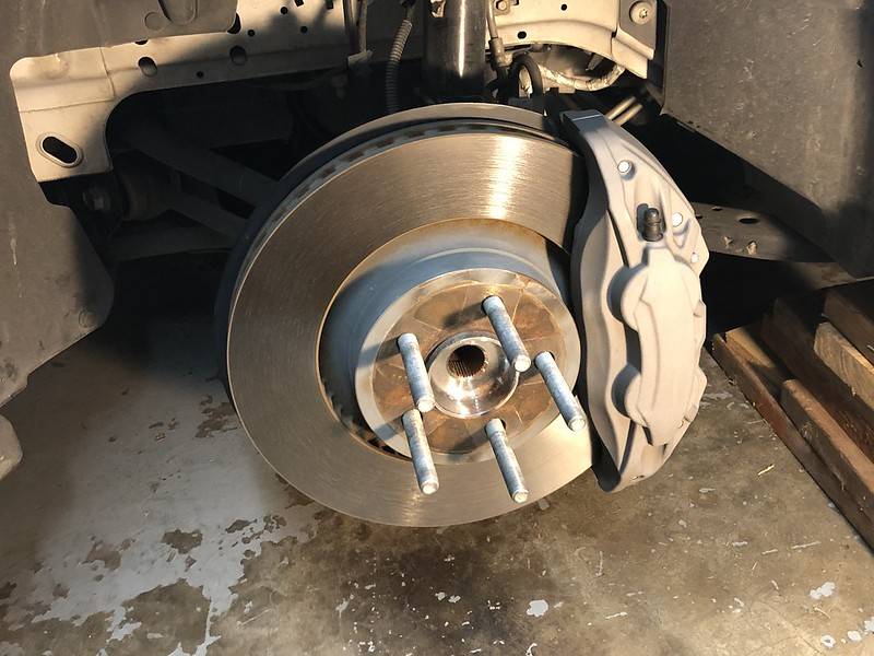

Move to the front - simpler because it's just removing one caliper and dropping the other one on. I did have to install new pads and hardware because the calipers I got were bare. I chose G-LOC pads in their GS-1 street compound. Minimal dust and noise, but good bite and performance. Since I won't likely track this thing before I get back on the AutoX course, these made the most sense and cost was the same or better than the dusty OEM pads. The GTPP rotors also require a different splash shield, so those were installed as well.

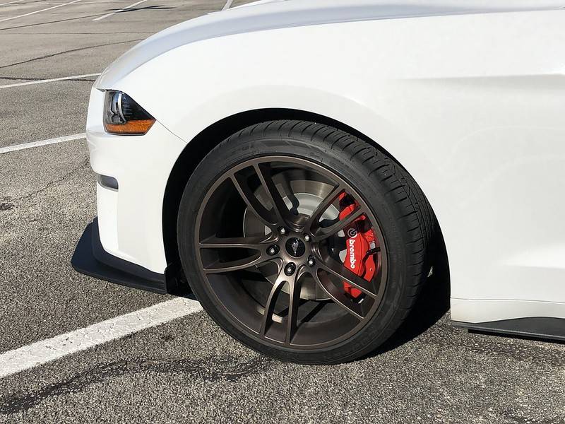

Obviously, the front rotors were replaced, too. Hard to see the extra inch of DIA, but it's there. Damn, these are massive rotors. Love it!
When all the calipers and hoses were installed, it was time to bleed & flush the system. It was due for a flush anyway, so this was a good opportunity to get a batch of fresh DOT4 in the system. I used a Motive Products power bleeder that I also got from OPM with a specific Ford adapter. This still took a while for one person, but was easier than the old loosen-pump-tighten-release-repeat method.
When everything was done, I drove the car around the block, and then I went on a 200 mile road trip. Perfection. The pedal is in fact a bit softer than the EBPP / Base GT brakes that were original to the car - and I really liked those a lot. However, after driving this setup for a week, I'm not sure I need to upgrade the master cylinder to the PP-spec unit. I'll drive a stock GTPP before I decide to make that change. So far, it's great.

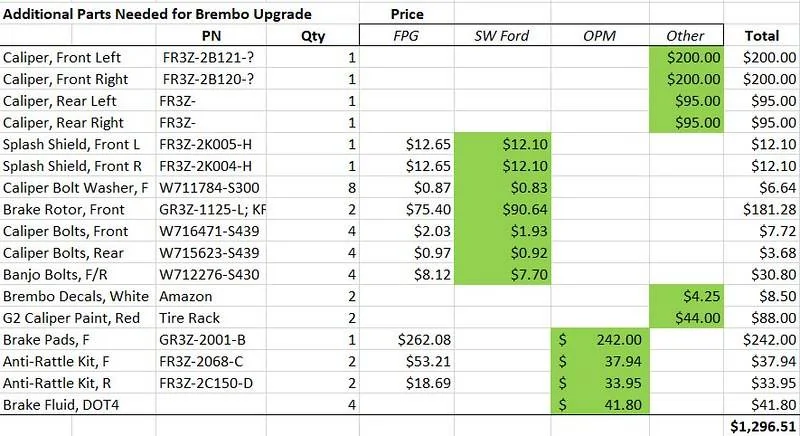

Brembo_Upgrade_Expenses by clair_davis, on Flickr
Overall, not the cheapest way to do this swap, but I'm more than happy with how it turned out and performs.

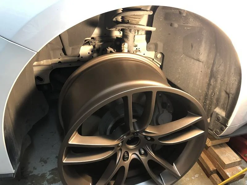

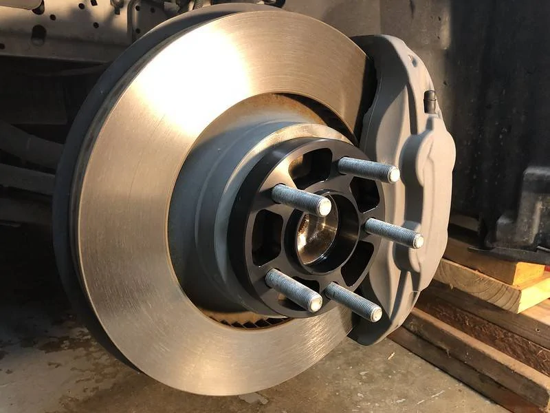

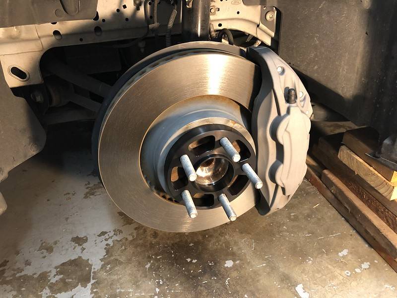

On Sunday, I spent a little time on the car, testing how the 11" SVE GT-7 wheels are going to fit next to the strut with the 25mm spacer that is needed to use the same wheel front and rear. This lets me rotate the tires front to rear and get a little more life out of an expensive 305/30-19 tire. It was a pretty simple operation - up on jack stands, pull a wheel, pop the spacer on, and measure the gap between the wheel lip and the strut. Pics:
The GT350R wheel studs are plenty long for the extra 25mm spacer...
Spacer and 11” Wheel Fitment -01 by clair_davis, on Flickr
Hub-centric spacer from Optimum Performance installed:
Spacer and 11” Wheel Fitment -02 by clair_davis, on Flickr
Spacer and 11” Wheel Fitment -03 by clair_davis, on Flickr
Plenty of clearance:
Spacer and 11” Wheel Fitment -04 by clair_davis, on Flickr

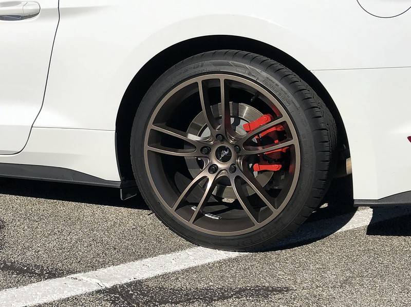

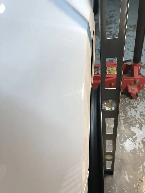

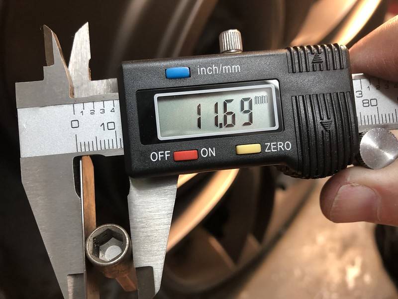

How much clearance? 11.69mm... enough that I'm going to order a 20mm spacer and see if that one will also work as well, tucking the tire and wheel under the fender a little bit better.
Spacer and 11” Wheel Fitment -05 by clair_davis, on Flickr
At full droop and the suspension unloaded, the wheel is about 3/4 of an inch outside the fender.
Spacer and 11” Wheel Fitment -07 by clair_davis, on Flickr
It will draw up under the fender a bunch with the full weight on the car, but it will still need a chunk more negative camber. This not only pulls the top of the tire in a bit more, but also gives more lateral grip when cornering, a win-win. I'll document that operation when I get the parts lined up.

I’m considering getting a set up like this myself, I’m wondering what the pros and cons are…? Any risk of the wheel mount being weaker, etc? Any reason you did this instead of wider rims? What spacer did you use? Your tires sling up all kinds of shit on your quarter panels now?
The longer studs are required to fit the 11” wheels with the same offset front and rear. I wanted the same wheel F/R so I could rotate tires. The studs being factory parts should be plenty strong, and those slip-on spacers are used by tons of road racers.
The wheel mount is functionally the same as a wheel with a different offset, and everything is hub-centric. These spacers are from OPMustang and are top notch. Fit is great, and machined from aluminum billets, not cast.
I haven’t really noticed much / any more shit on the quarters than the 285’s or stock wheels with 255’s, so I guess that’s a win…
