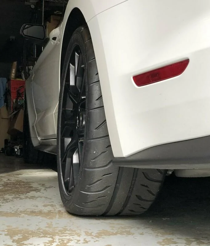

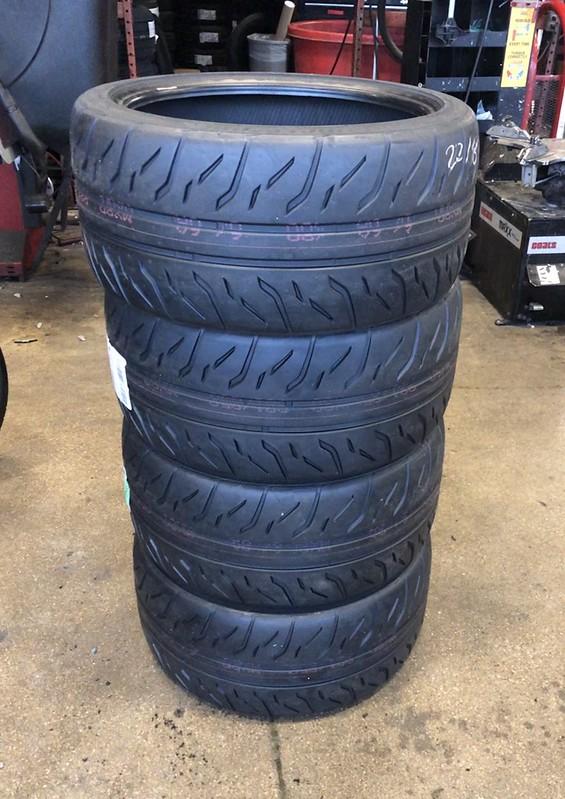

Last Saturday I was able to get down to Discount Tire to get the new tires installed - right before I was out of town on work for a week... They look like a proper stack of tires sitting there waiting to be installed:
RE-71R Summer AutoX Tires by clair_davis, on Flickr

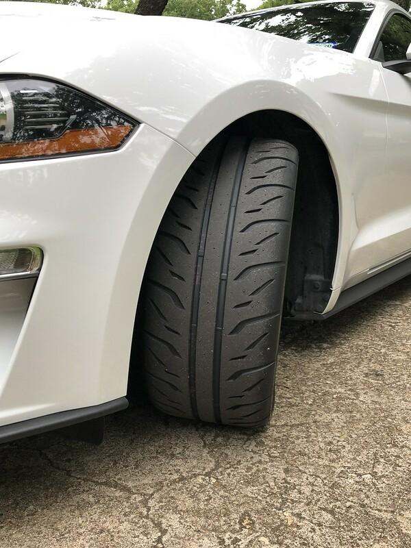

Of course it also started to rain a bit while I was waiting, so I was not very excited to drive fresh autoX tires home on wet roads. They behaved fine for the 2 mile trip. The 275/35 fits the 9" EBPP wheel pretty well - could perhaps use a smidge more width, but 9" was the smallest of the recommended wheel widths per the Bridgestone site. No bulge to speak of, but the sidewalls weren't as straight as the 285's I have on 10" wheels.
I gotta say, these tires are like none I've ever driven on before. Steering response is DRAMATICALLY improved. Turn the wheel and the car starts to move. These sidewalls are really stiff so there's none of this "take a set then turn" stuff going on that even the Pirelli's had. This performance comes at a price though... ride is noticeably more harsh now in every drive mode, and the tires are noisy. In-town speeds you can clearly hear a wowowowowowo sound on concrete streets. At highway speeds it's more of a constant hum that is still quite noticeable. And then there are the tar patches used to seal cracks... these sound for all the world like packing tape being peeled off the roll. I had read a review that stated the same thing and I thought that was a little extreme - until I heard it for myself. Wow, these are sticky tires. Is it a problem? Not really, unless you're bound and determined to daily drive these tires. That's not my plan, so no biggie. I drove them down to my folk's place and back on Sunday with no issues other than the noise. They're now stored in the corner waiting on my first autoX in about 12 years, and the Coopers/GT-7's are back on the car again.

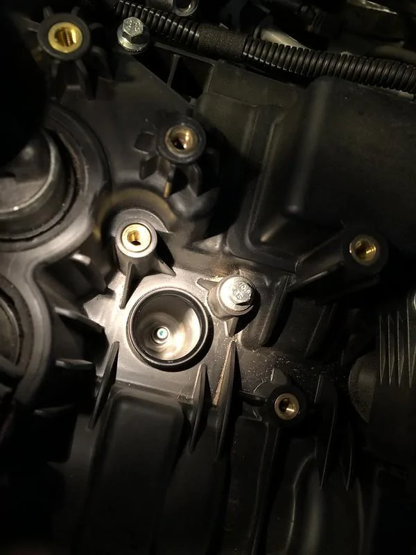

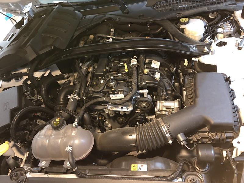

The install wasn't bad, my biggest concern was being able to remove the engine cover without moving the strut tower brace - it works fine if you hold your mouth just right. At worst, you might have to remove the oil filler cap and dipstick, but it wasn't an issue for me.
Spark plug change by clair_davis, on Flickr

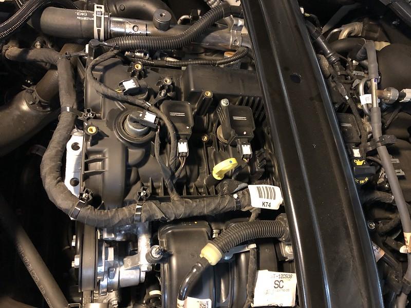

There was a ton of dust and sand under the engine cover, so I vacuumed up everything that I could get to, including the spark plug wells. Fortunately they were squeaky clean:
The plugs on either side of the strut tower brace are the hardest to get to, but a short extension with a wobble end does the trick.

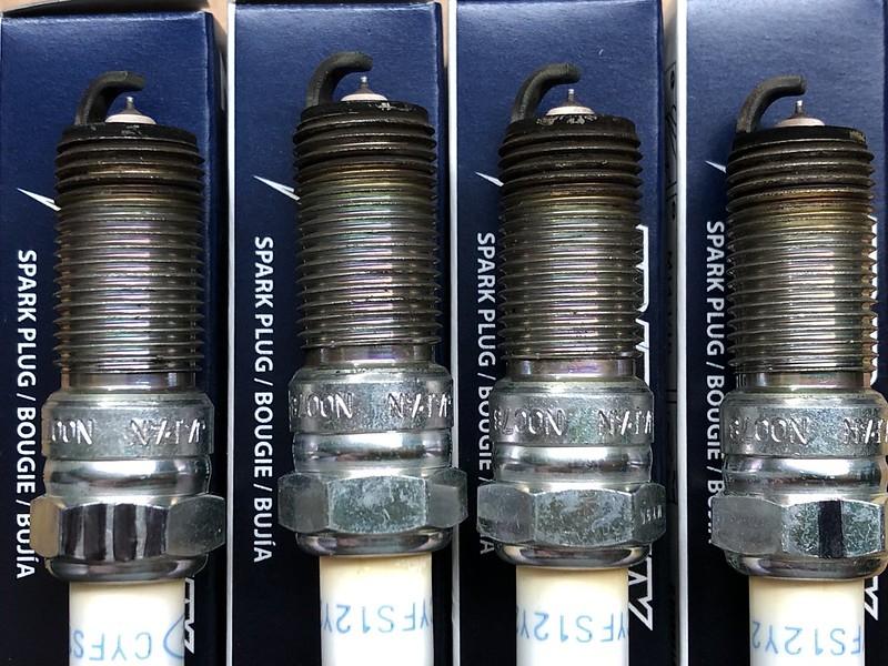

All of the plugs that came out looked OK, I guess as you'd expect for a 12K mile engine. Now we'll see how they do long term.

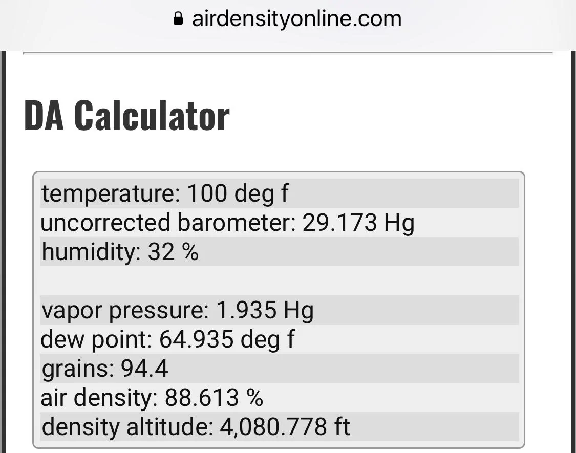

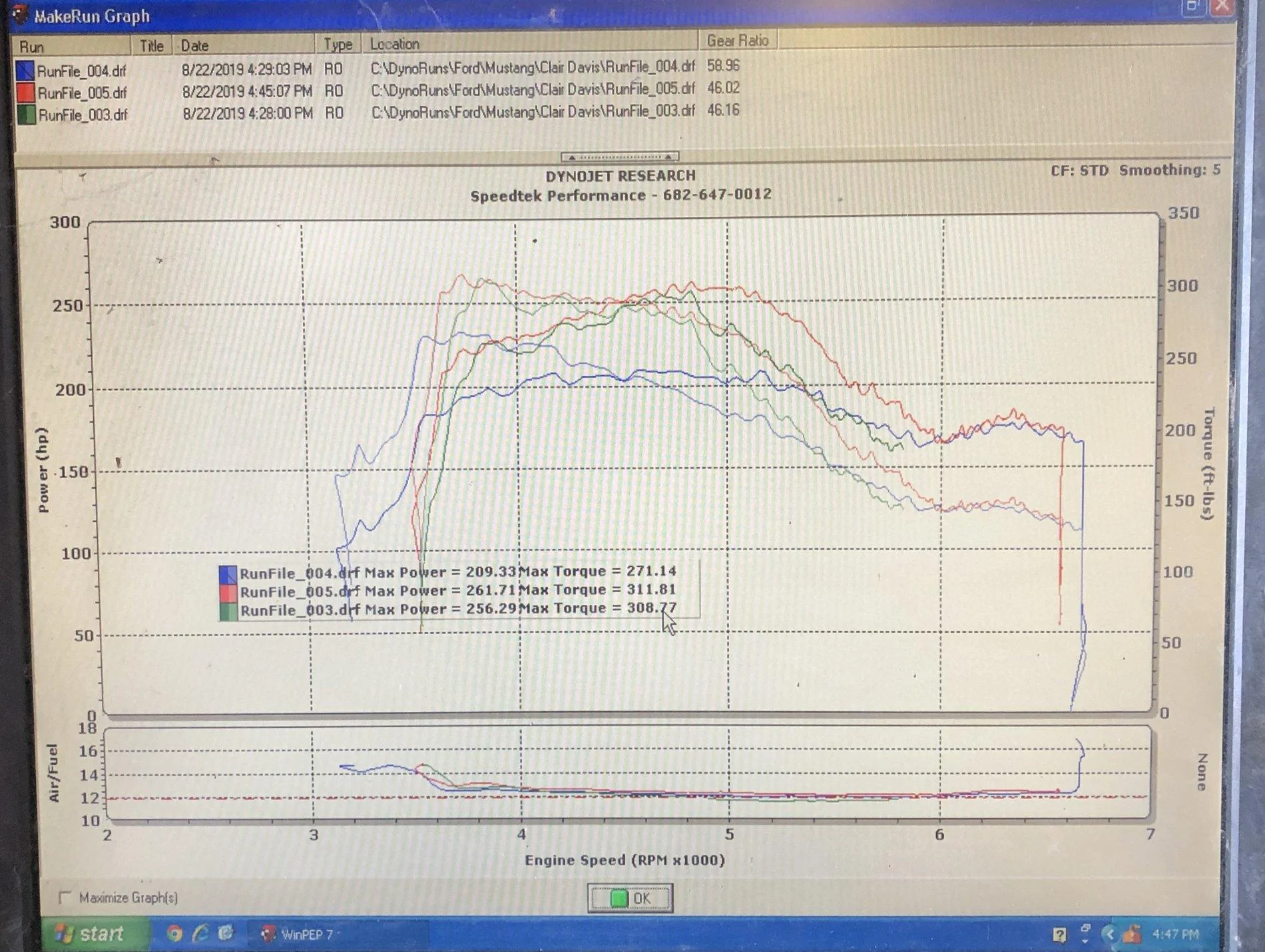

First installment was a trip to the local chassis dyno:
First and last runs were in 7th gear, or 1:1 in the A10. The middle test was in 6th, and also about a minute after the first run, so hotter than hell. Density altitude was also miserable at nearly 4100 feet... actual was around 600.
Results
Best WHP = 261 @ 5000
Best WTQ = 311 @ 3700
The test is a little unusual because the pulls really start around 3500 rpm, so I’ll have to consider that as I install upgrades. Road speeds started around 65mph and ended about 145mph.
So that’s the start. Will take me a while to make progress the way my work schedule has been, but I had to start somewhere.
Thanks for reading along, and more to follow...

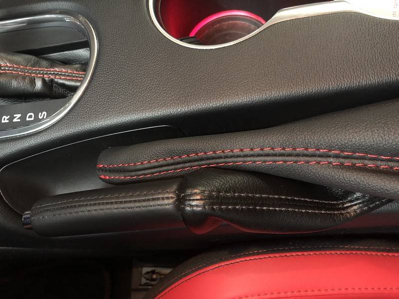

Here's the red stitch E-brake boot dropped in next to the original - pre-install. You get the picture... but I haven't actually TAKEN a picture of the installed piece yet. The texture of the boot matches the console better, but the leather is a little stiffer than stock so you have to be careful when you install to make sure the brake handle will go all the way down.
