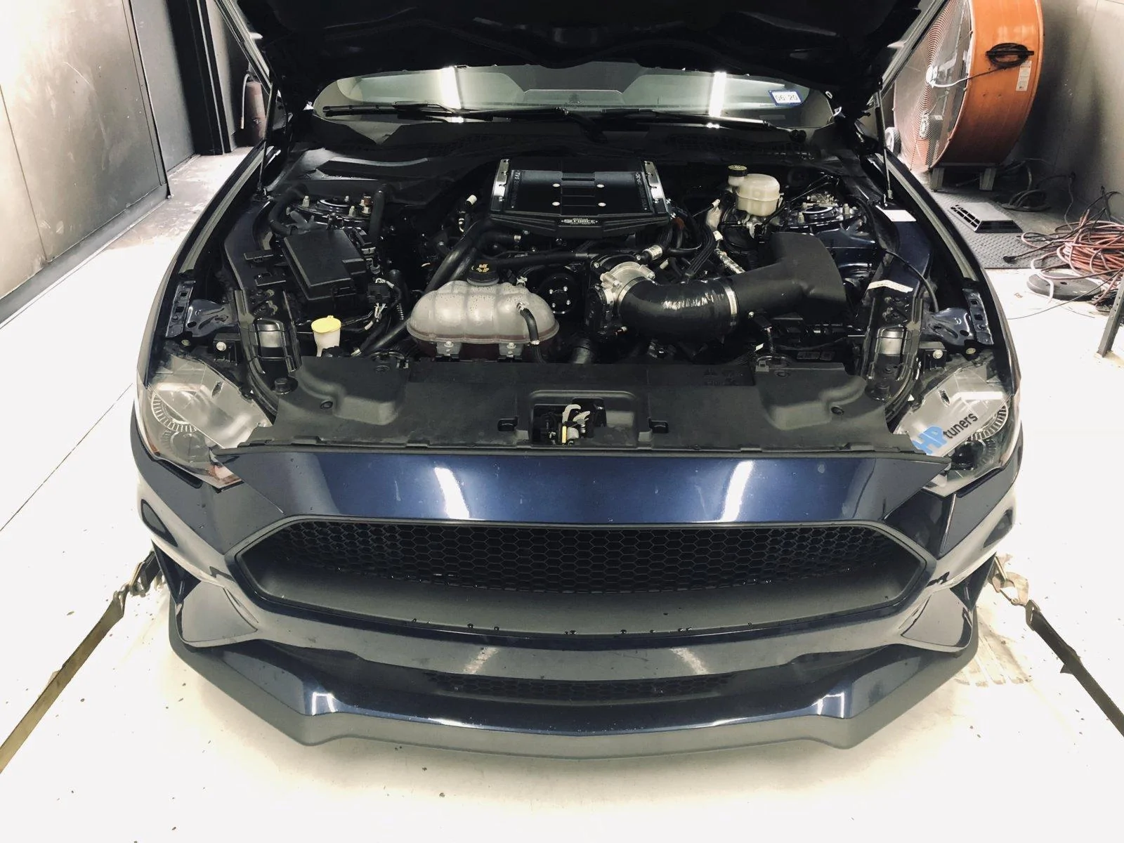

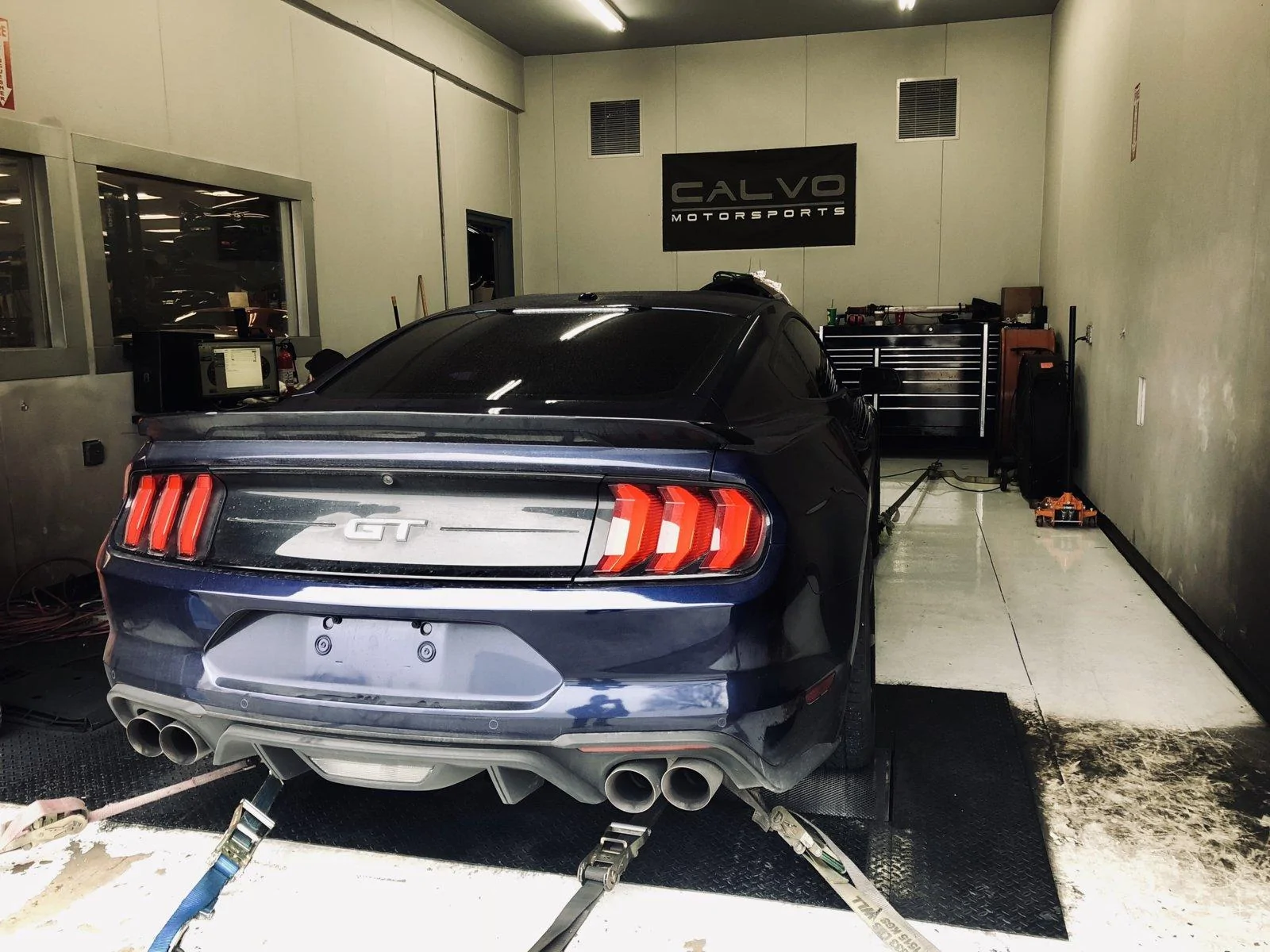

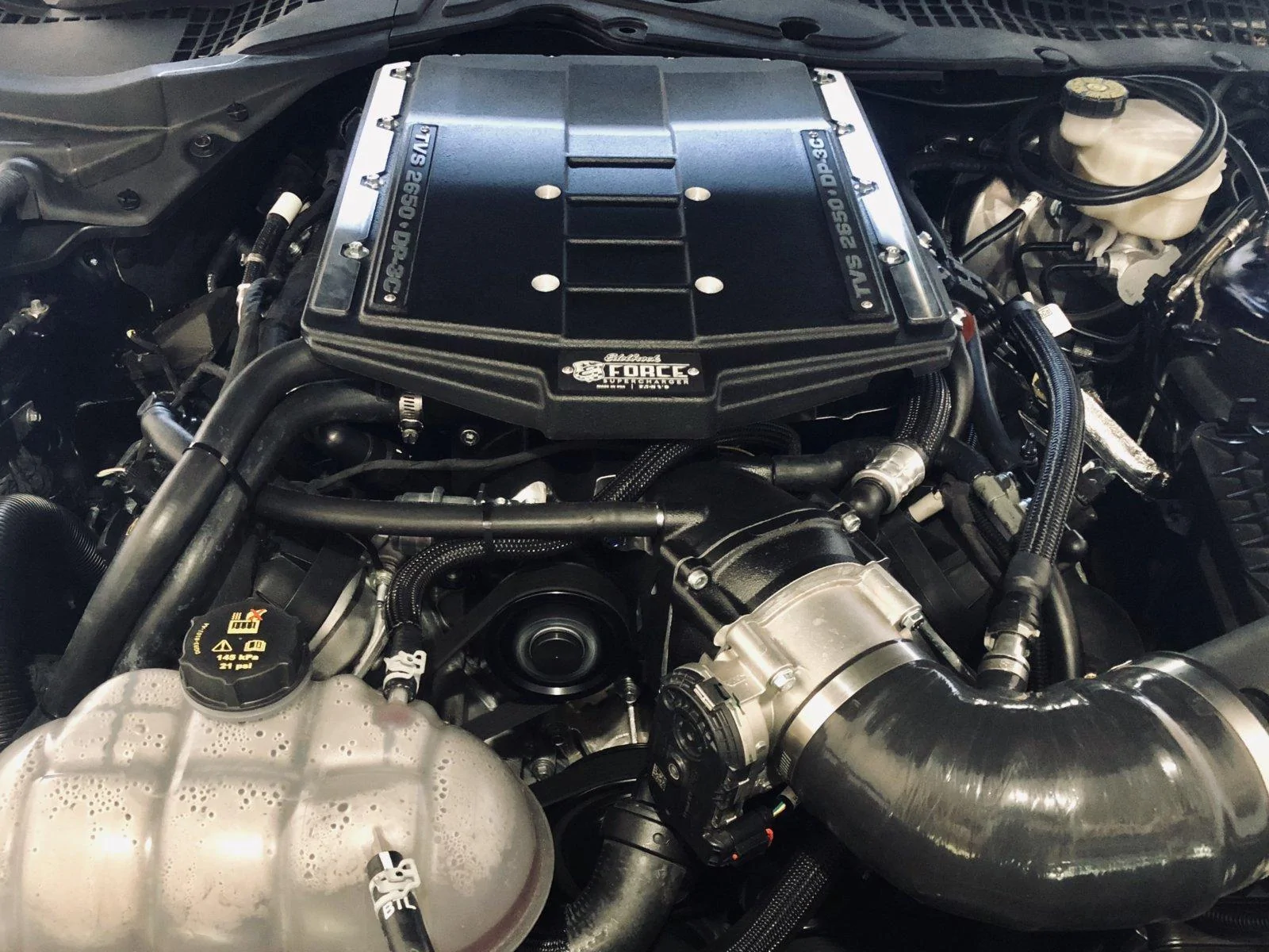

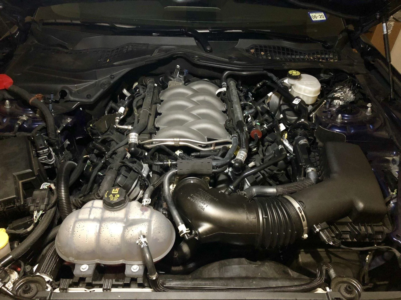

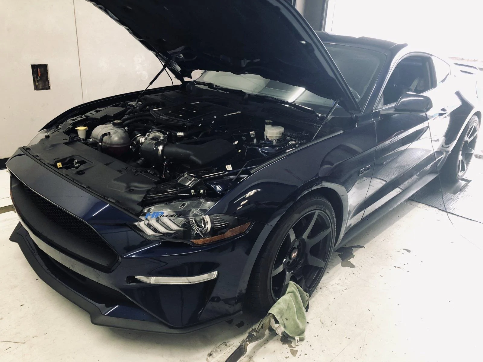

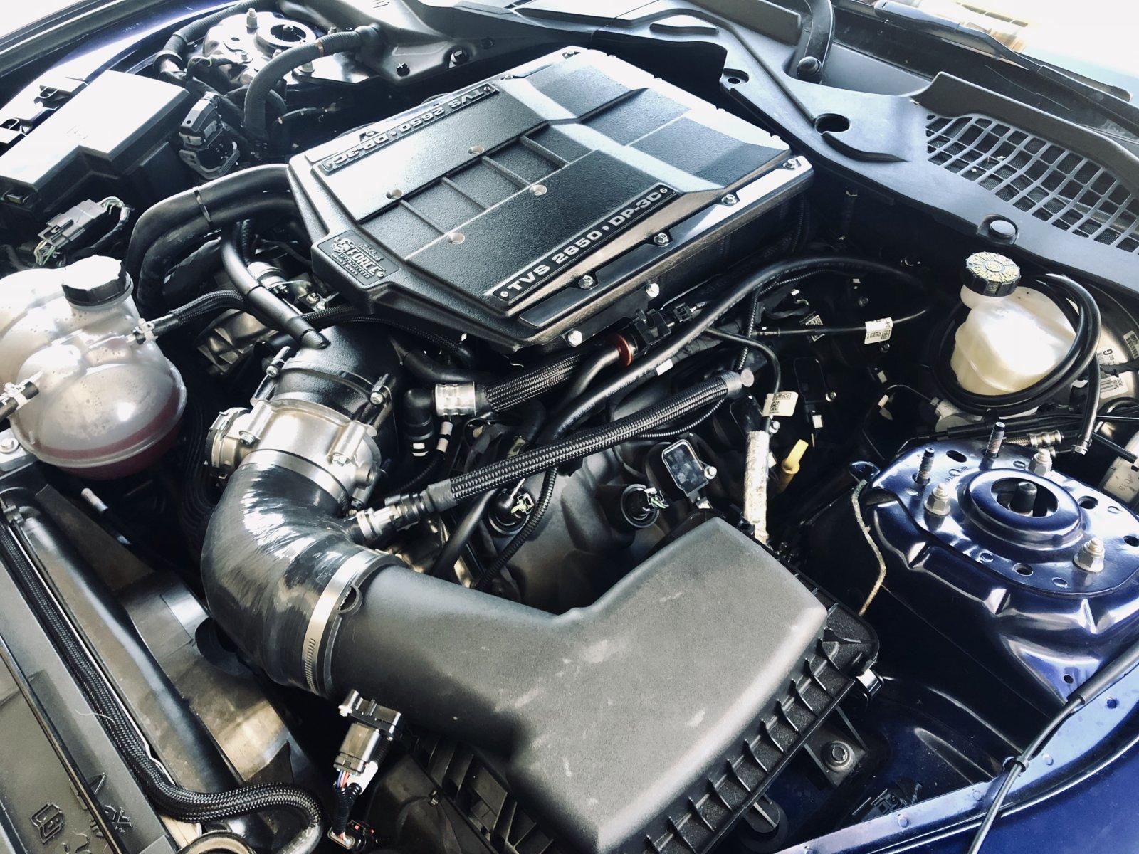

I'm probably a little late at starting a build thread, but here is where the car sits now and I'll keep this updated as more mods get thrown on.

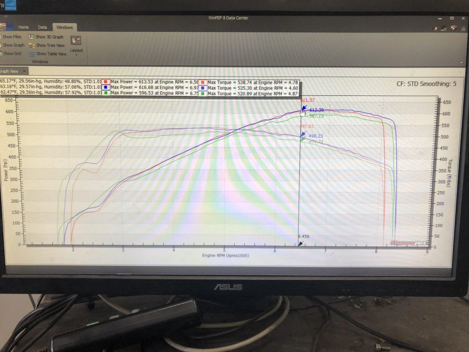

The car made 638whp when we dyno'd it in 7th, but had to use 6th instead bc the trans was slipping on the dyno. The graph shows about 25whp less and 50wtrq less than 7th gear does. The green line a tune with much more conservative timing in it(3* of timing was pulled out)
2018 Mustang 301a w/3.55 gears
Performance Mods:
- Edelbrock stage 1 supercharger kit (Part #: 158320)
- DeatshWerks 95# Injectors
- Magnaflow street series cat-back
- UPR catch can (edelbrock specific)
- Reische 170* thermostat
- Tuned using HPTuners(locally)

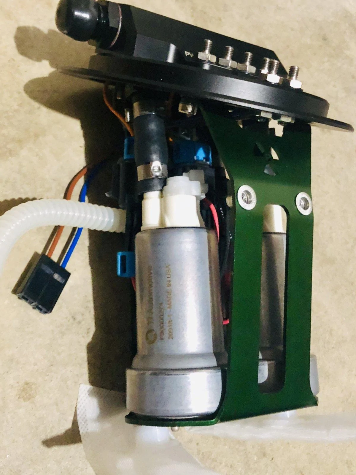

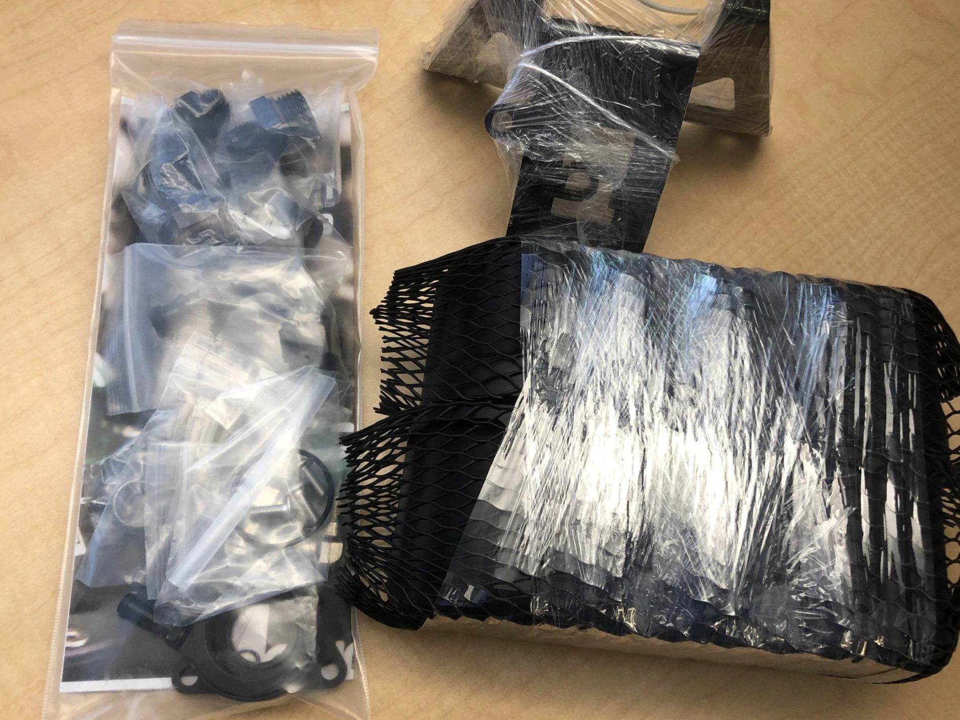

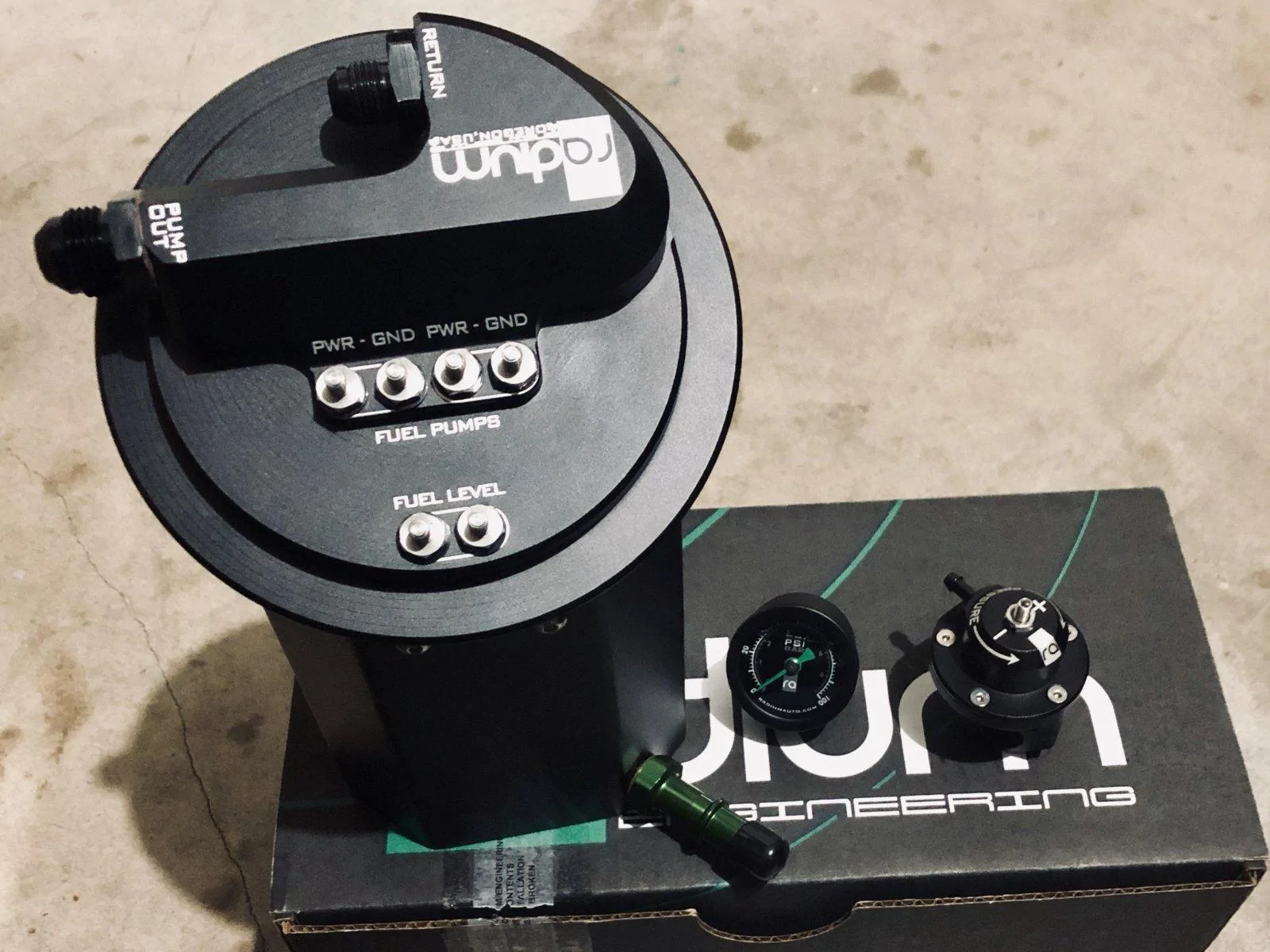

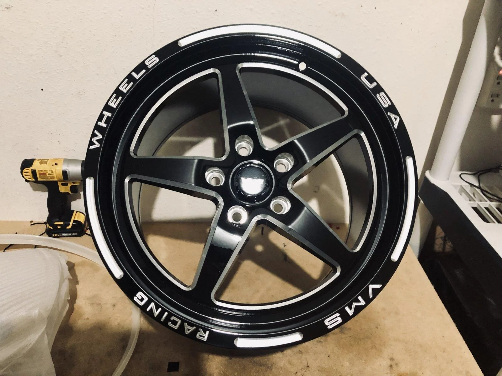

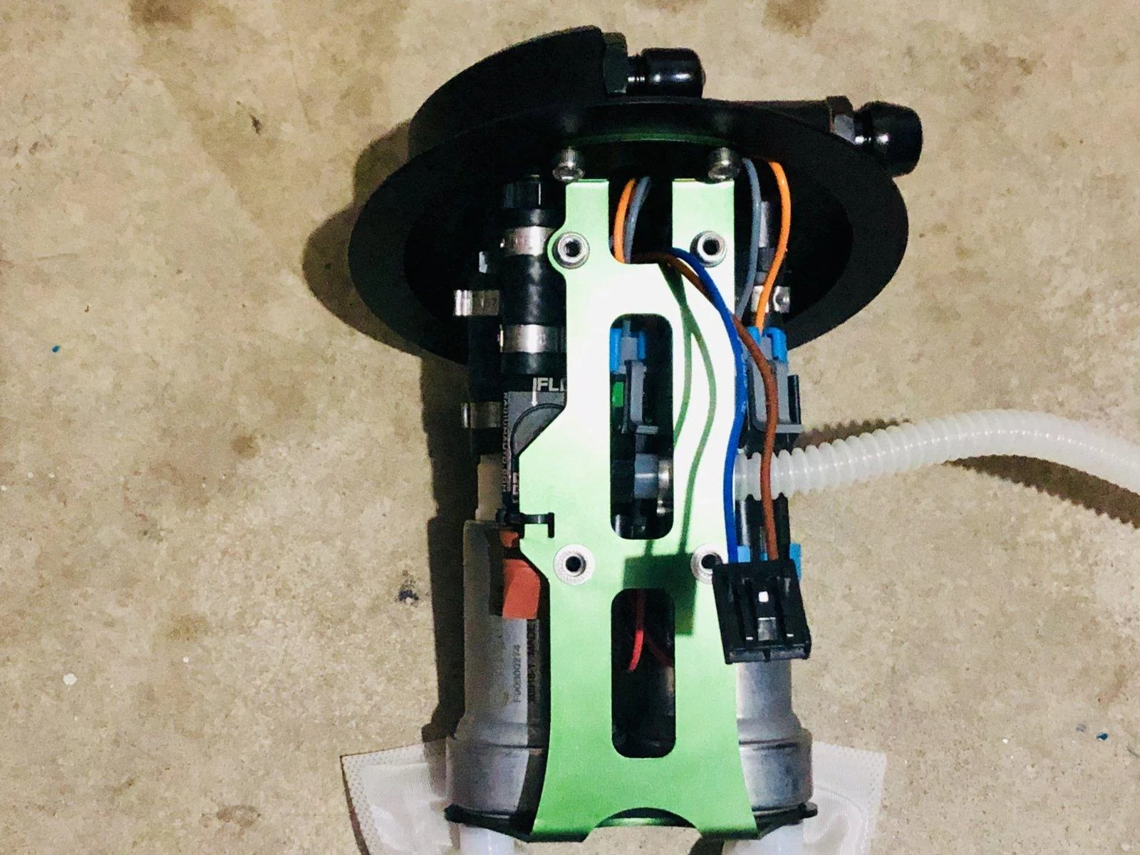

Few shots of the parts waiting to be installed
- VMS 17x10 wheels(still need to buy tires for these)
- Fuel system parts, the hose and fittings aren't in this pic, just the Radium parts. This pump assembly has 2 F9000274 pumps(AKA Walbro 460) and also has a bucket that functions like the stock unit
- Pypes long tubes(used) - funny story on these is I already paid the shop to install them, just haven't had time to drop the car off for them to actually put them on, so they've been sitting the shelf for quite a while now

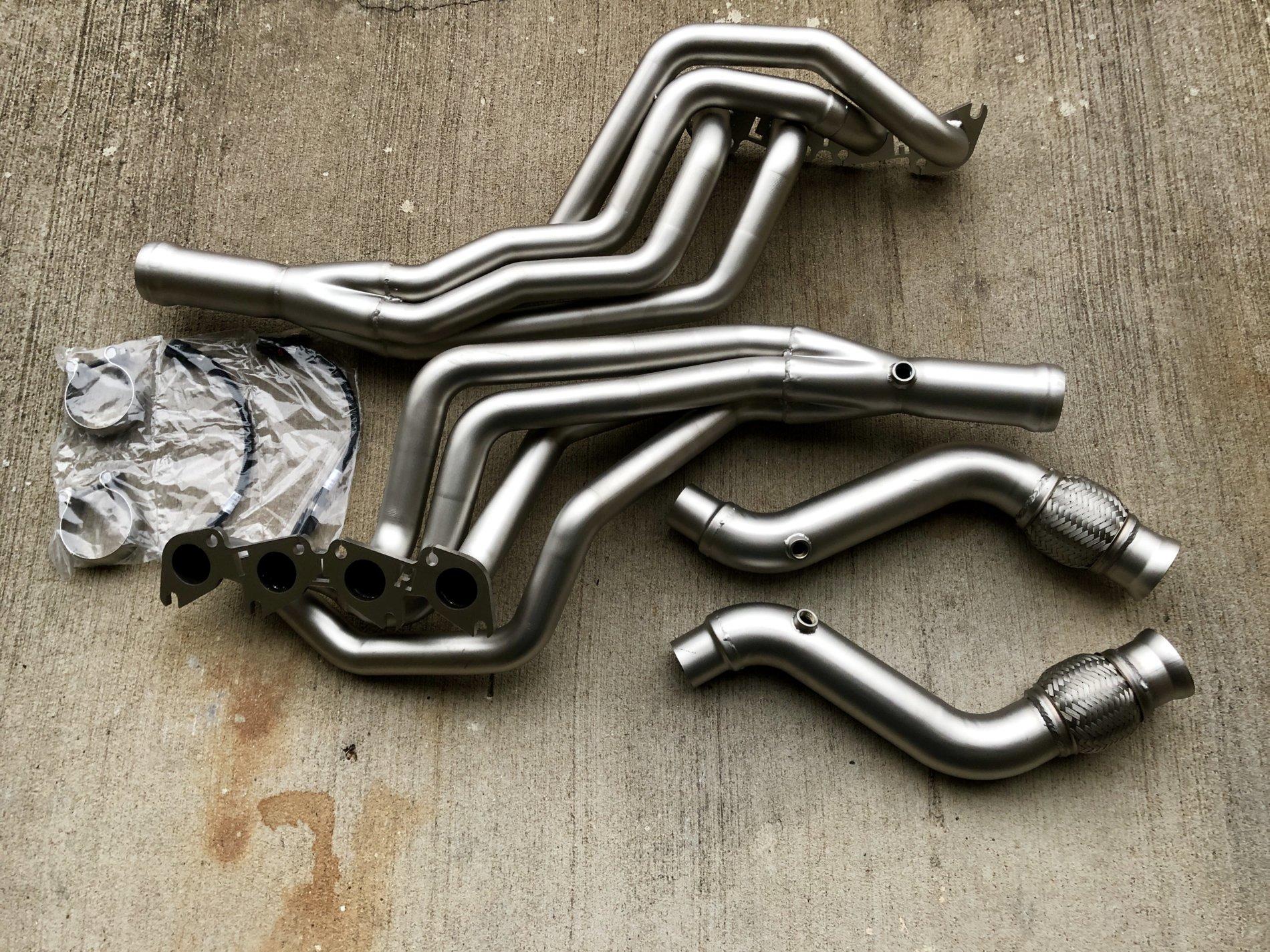

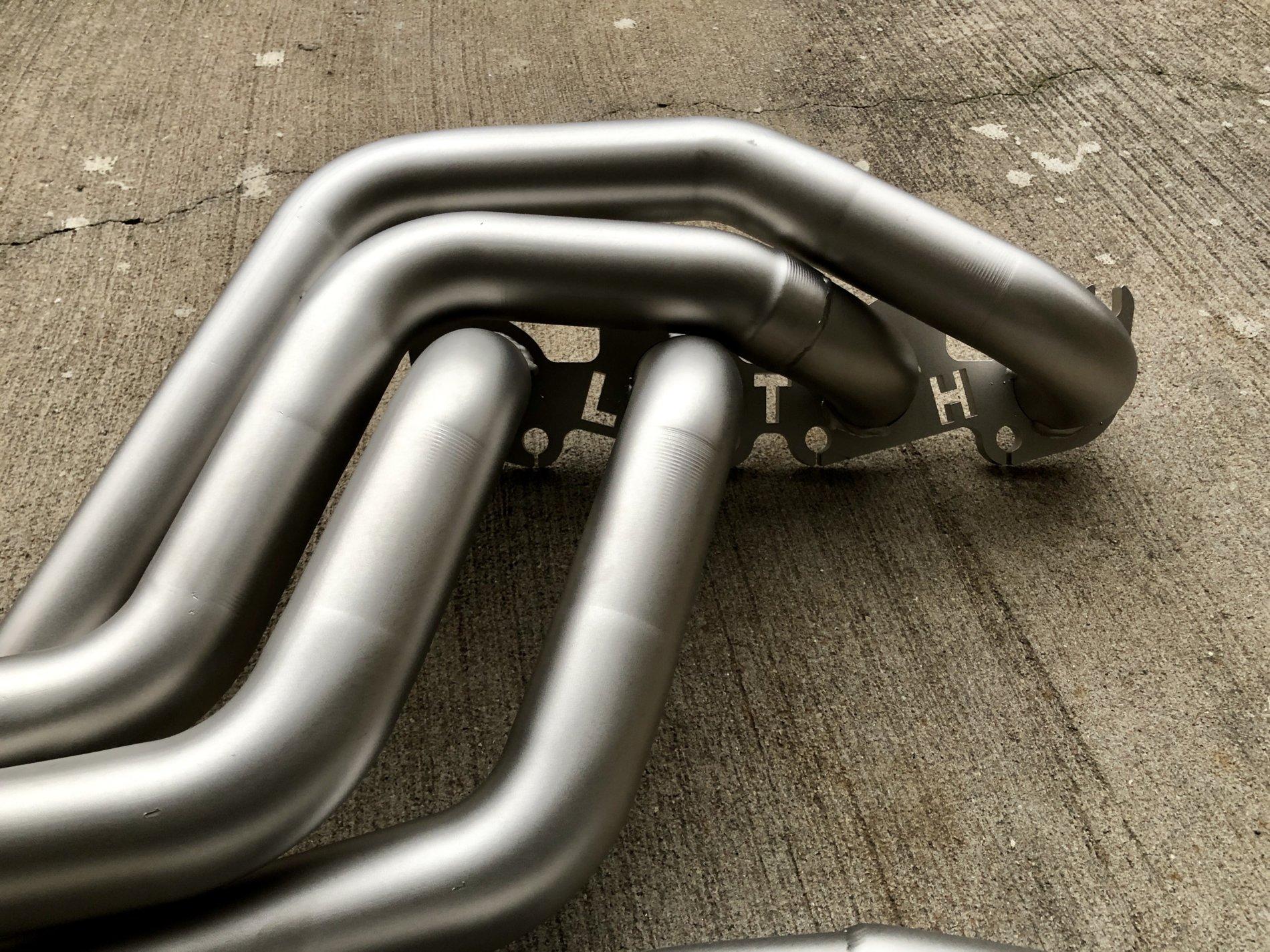

Changing up my header choice, ended up selling the Pypes catted headers and ordering a set of off road LTHs instead.

The wheels are really nice, they weigh about 22#, so they aren't crazy light, but they are lighten than most OE wheels and I mostly wanted a drag wheel to fit a 305/45/17 tire on them, not max efforts so I'm not concerned about weight. This is my daily so the goal is a low to mid 9 second car trapping 150

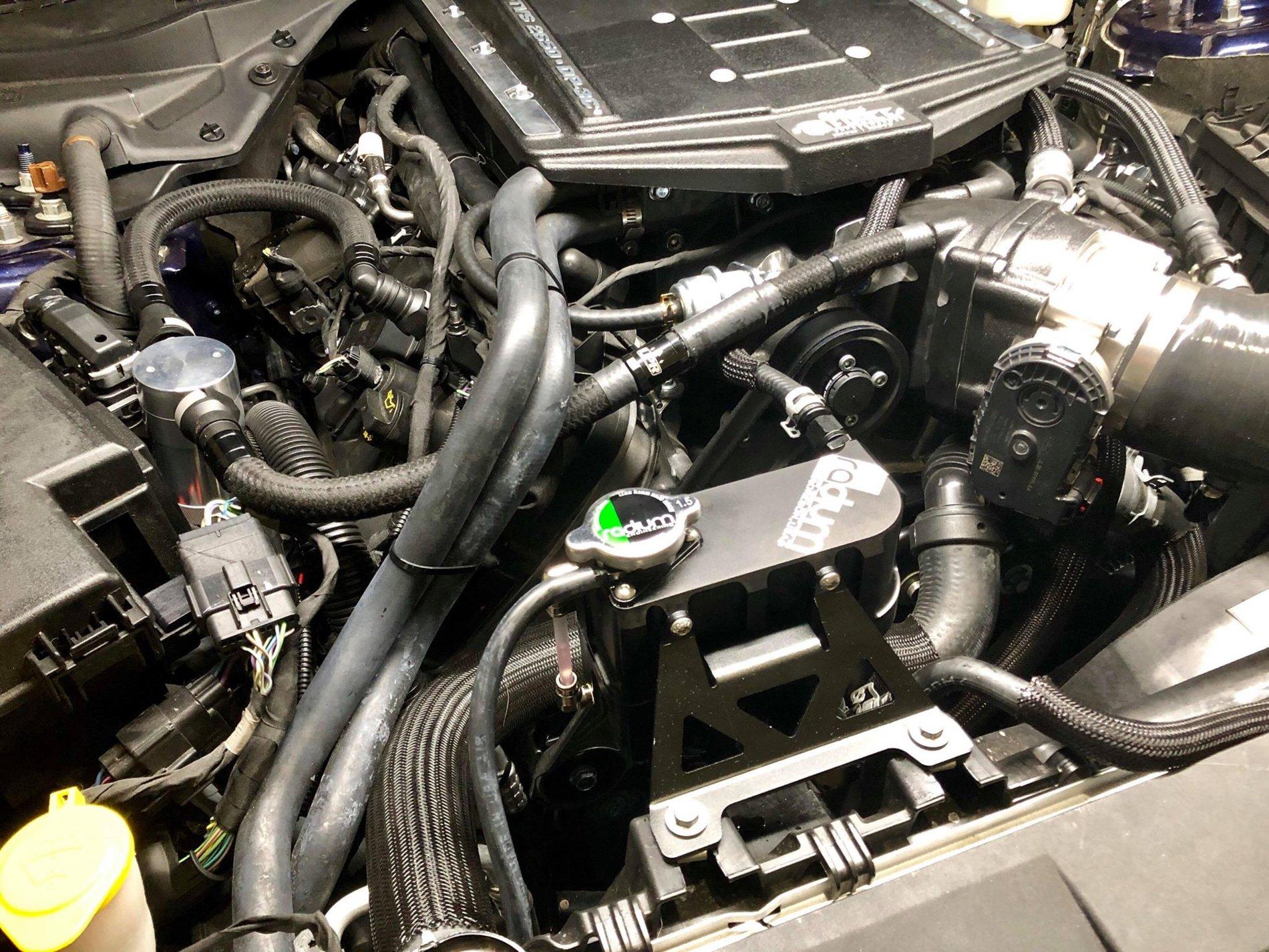

A few updates as well, picked up a few more parts
- UPR catch can, I did mod it a bit to work with the Edelbrock since the Edelbrock PCV fitting is 1/2" not 5/8" like stock, so used a reducer fitting and some extra hose I had laying around
- My LTH long tubes showed up, I ordered the 1-7/8" version
- Installed the billet Radium coolant tank

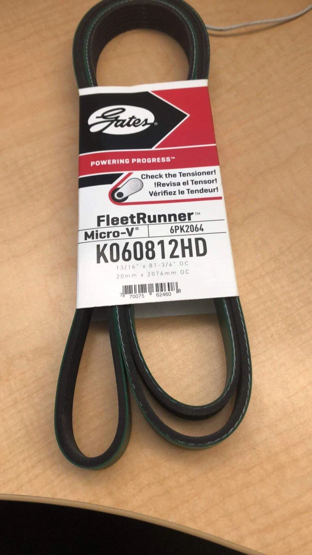

Few more parts starting showing up, ordered a 3" pulley and shorter belt. Got to love how Edelbrock keeps the cost of pulleys nice and cheap, the pulley's are $40, the belt I grabbed online for ~$30 shipped, it's a 81.75" belt(the included one form Edelbrock is 82" and is already quite tight on the 3.25" pulley so it may work fine on the 3", but to be safe I ordered something a little shorter

I'm digging it. How you liking the coolan tank?
Than tank is really nice, I'd recommend it to anyone, the quality is on another level compared to the sheet metal ones you see floating around eBay and being sold by other companies. This thing is billet aluminum, anodizes, and laser etched logo. I've never been a fan of the OE tank, it such a eye sore in the engine bay

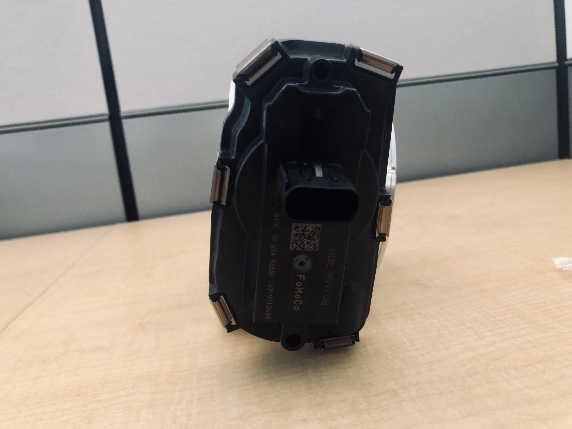

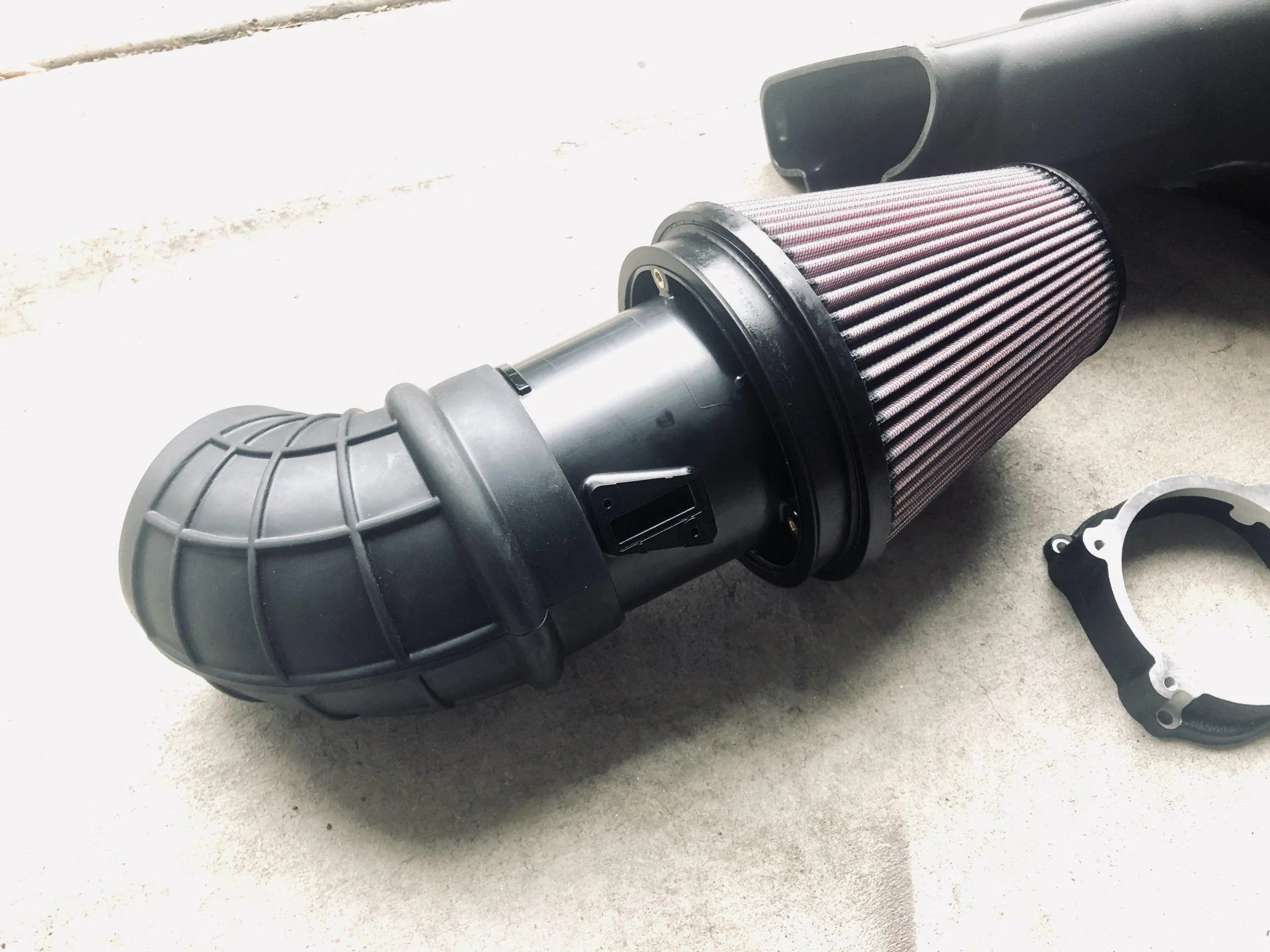

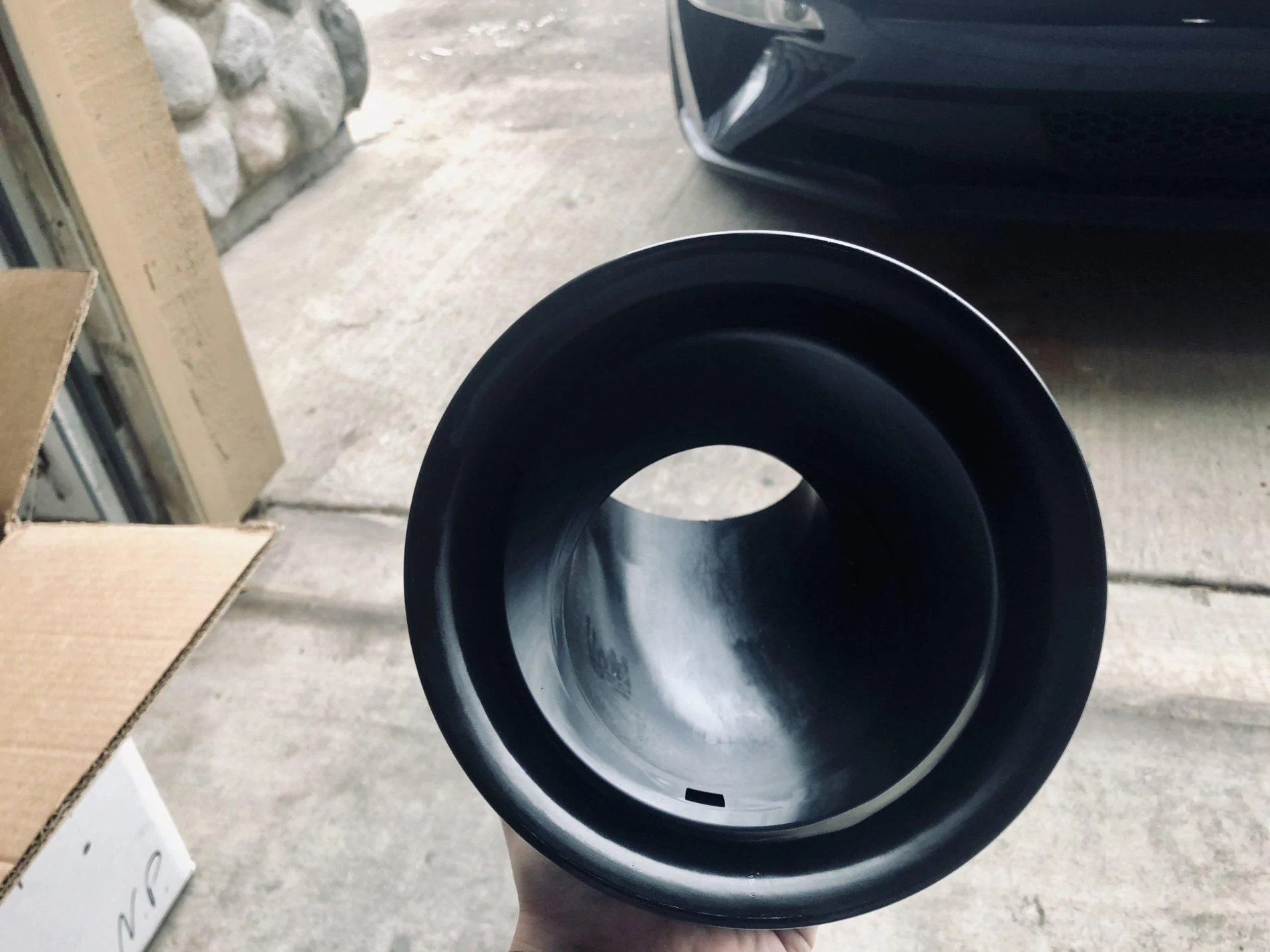

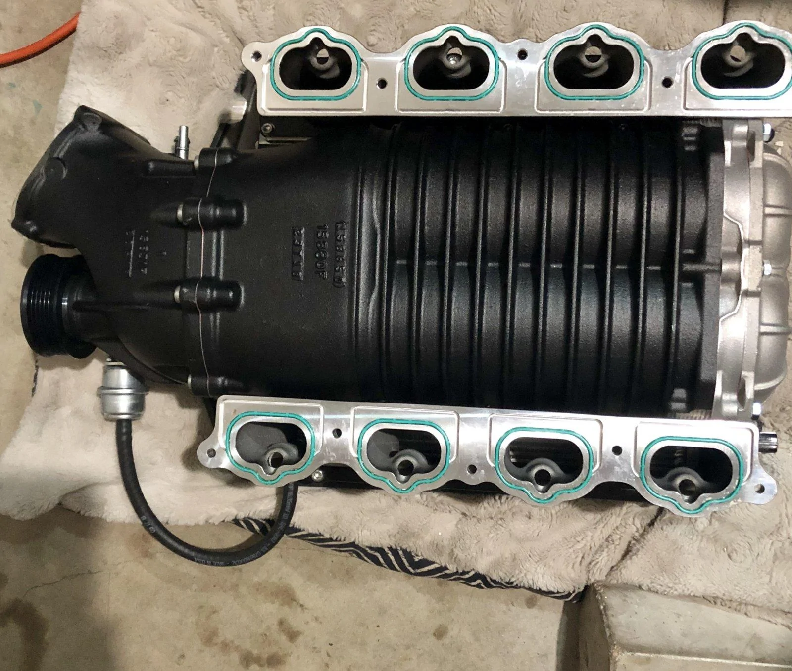

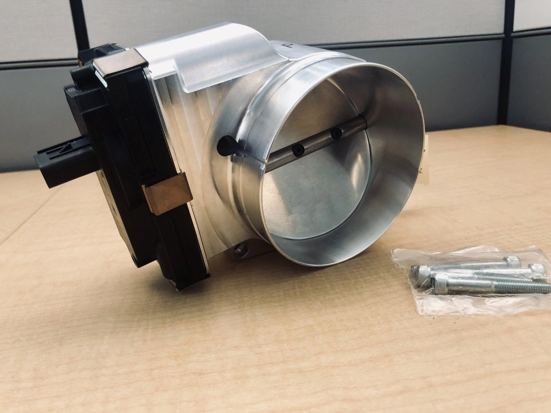

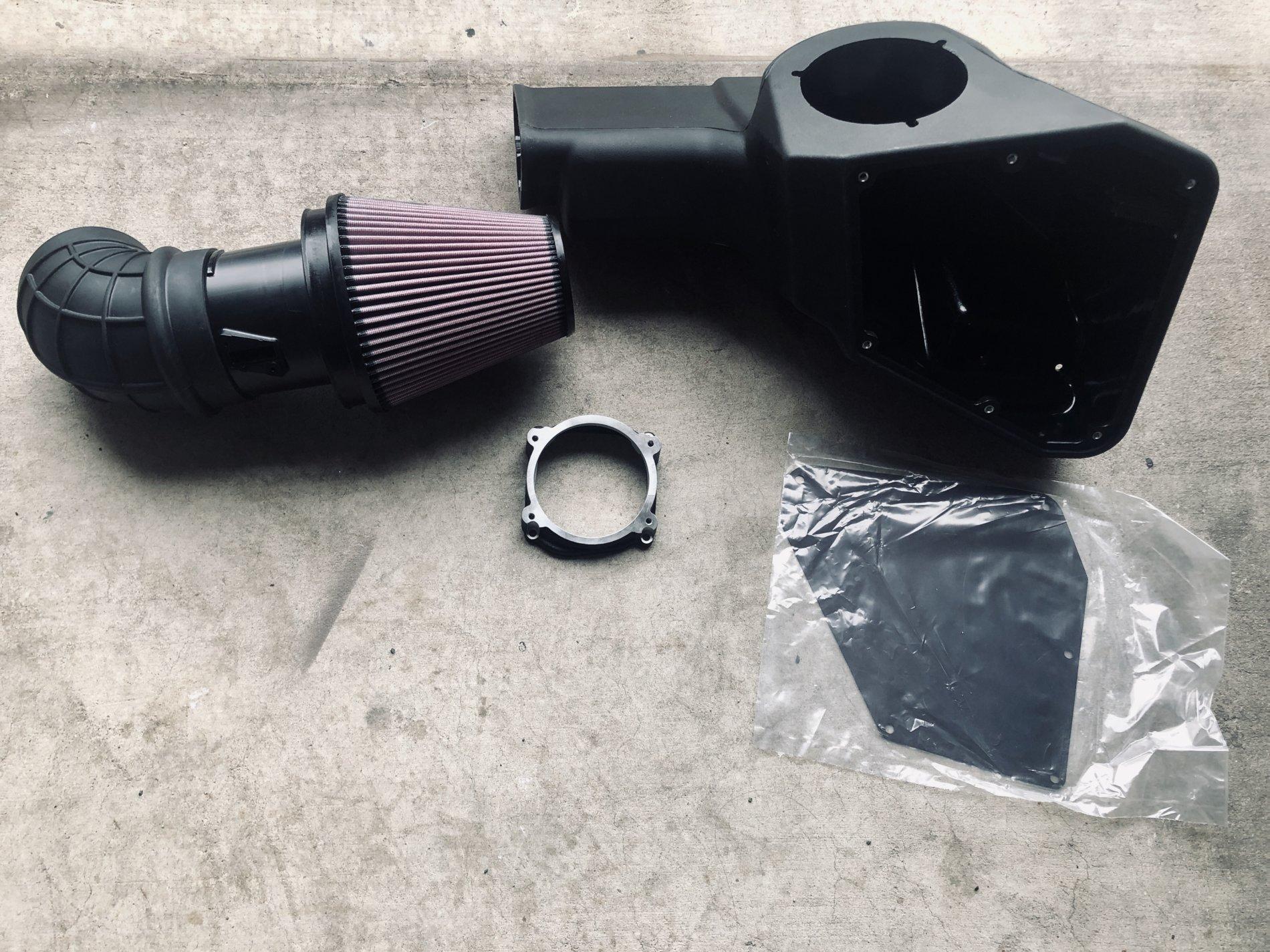

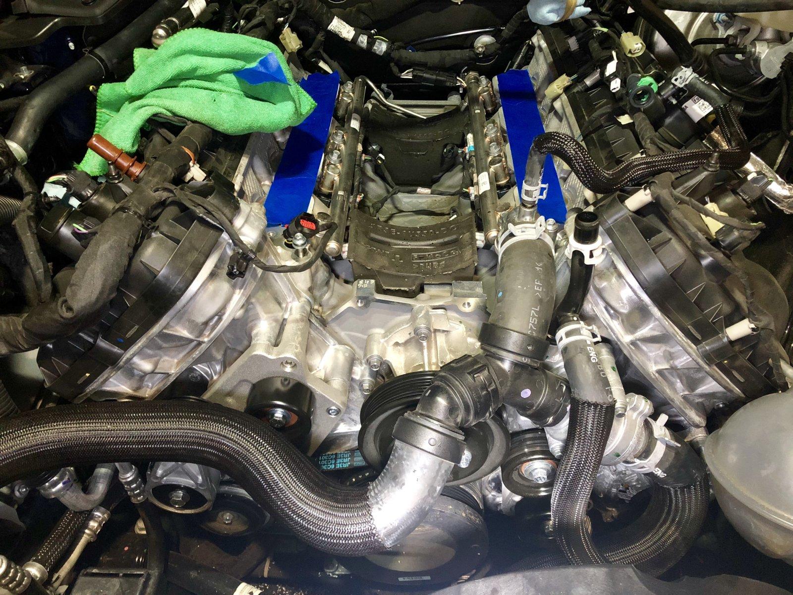

Edelbrock wasnt kidding when they said they were going to add to my pile of parts, their stage 2 parts just showed up today, 103mm throttle body and stage 2 intake.
This is a pre-production model, like the one they showed off at PRI, so it hasn't been anodized yet. The ones they will be shipping with orders will be anodized black with a red blade like what is in their catalog. I'm not sweating the color though, mostly interested in seeing the gains this thing will provide
Kona 18
Kona 18
Jul 19, 2018
604
447
2018 Mustang
Few shots of the intake, I'm going to work on getting these parts installed tonight and will post more pics once it's all one
