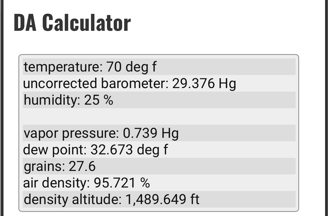

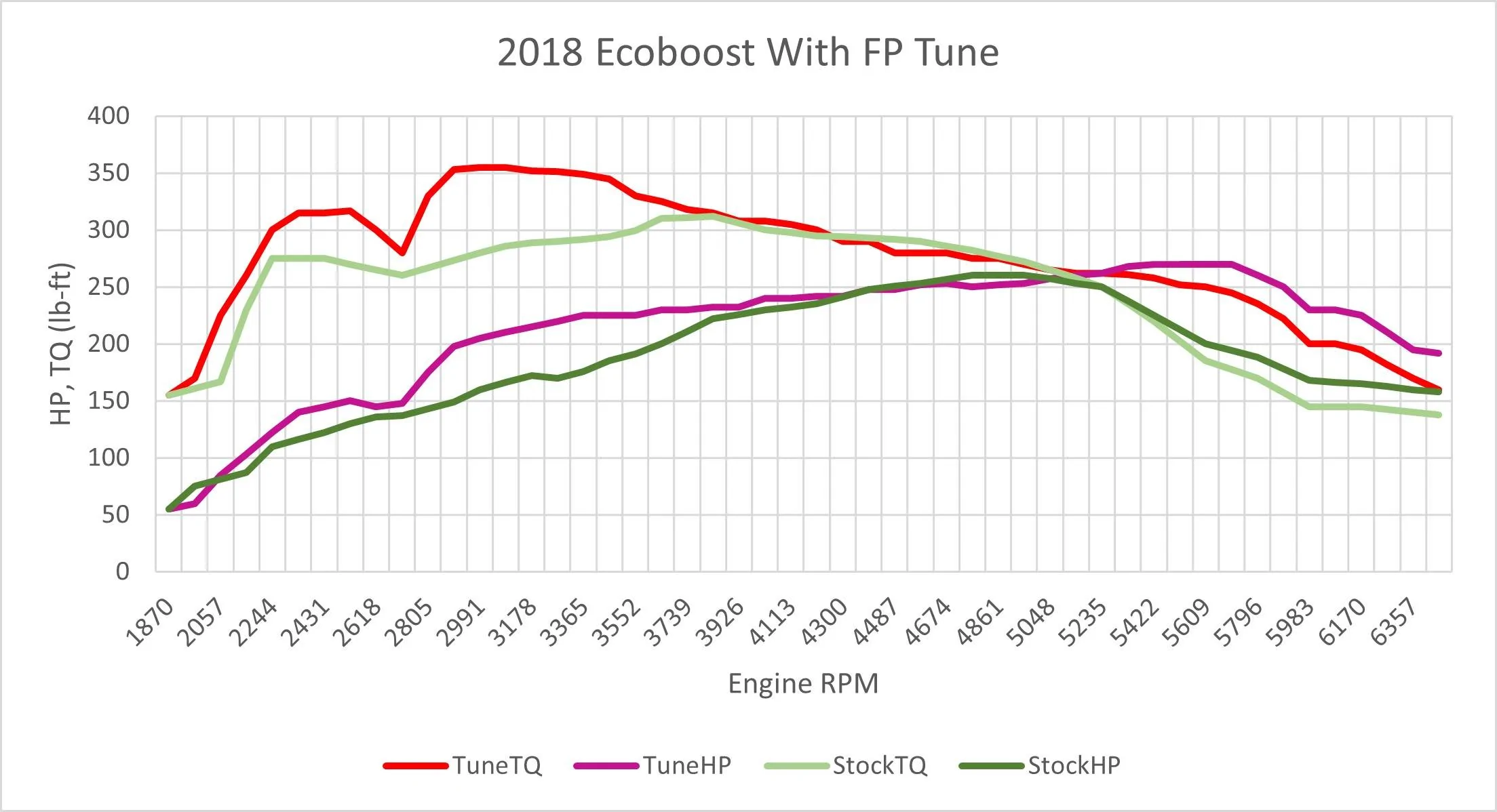

Back in May of 2020, I had the local dealership install the FRP tune for me. That was an ordeal itself, but it got done and after things settled in for a bit, I was able to consistently see a half-second improvement in 0-60 times. The car felt stronger, but how much stronger? Only another trip to the dyno would tell, and a friggin' year and a half later I made it.
Weather conditions weren't identical - significantly cooler with the tune, and the air density altitude was much better as well. With that said, the differences are pretty obvious at the low end and top end, but less than I expected to see through the mid range.
Down low, torque was up a max of nearly 80 lb-ft @ 2900rpm, with pretty fat gains from 2200-3500. Similar gains - more than 50 lb-ft - were seen from 5500-6500 where the stock 2.3L falls on it's face.
Horsepower increases of 30-50 HP did occur from 2800-3700, but the peak gain of 76 HP came in at 5700rpm. There was an additional 45+ HP available from 5400-6300rpm, again opening up the top end over the stock tune.
All in all, it's a pretty decent result, even if it feels like there is still something that needs to wake up. For now, I'm happy with the extra power and I need to get it out to a drag strip to verify how she runs in the quarter.

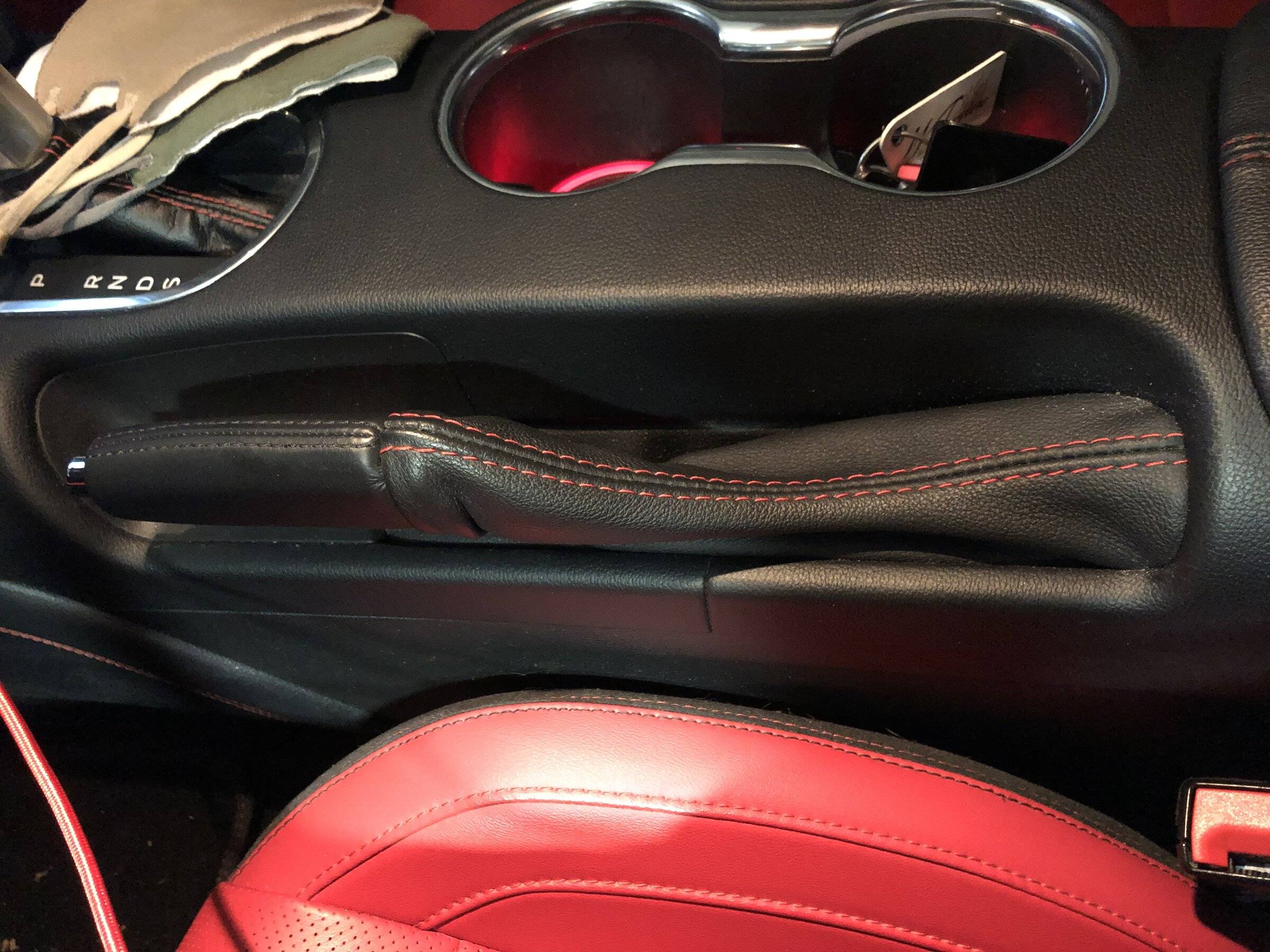

Here's the red stitch E-brake boot dropped in next to the original - pre-install. You get the picture... but I haven't actually TAKEN a picture of the installed piece yet. The texture of the boot matches the console better, but the leather is a little stiffer than stock so you have to be careful when you install to make sure the brake handle will go all the way down.
E-Brake Boot by clair_davis, on Flickr
did you ever install the e-brake boot? if so, how was the install for you? It looks beuatilful

Sorry for the late reply on this - I did in fact get the boot installed a while ago, and it looks / works great. It was a little stiff at first, but has settled down nicely. The only down side is that it points to the lack of red stitching on the handle end of the lever…
