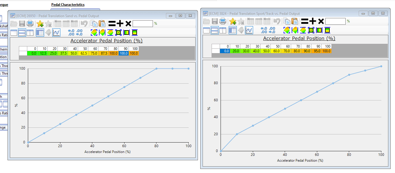

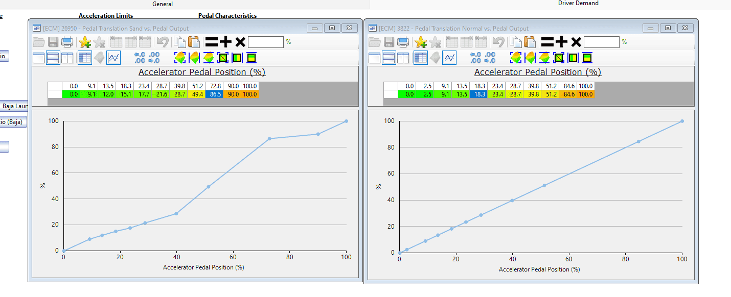

They are a gimmick, you want better throttle response get it tuned.
We were just talking about this in another thread, but the factory tune has pedal enhancements and changes for the different modes. The plug in ones are garbage, but in the tune you can change the pedal percentage/pedal output easily per mode. From the other thread.

@ZXMustang I did happen on a thread with some throttle mapping but have not seen those. Thanks for adding that- what are the 'Sand vs Pedal Output' charts for? Would those be our Weather mode? And the next conclusion would be that Sport and Track both offer the same pedal % vs pedal position values- is that correct? Can't say I've really felt that much of a difference.
