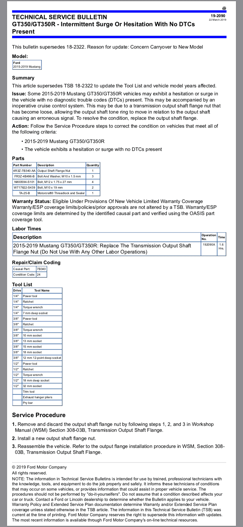

Crammer I hear ya man. But just spoke to the dealer. They believe it’s a backed out flange nut that monitors something with the transmission. Apparently there is a TSB for it which I’m attaching a screenshot of. They said the part is on back order because it is so new.

Thank you for posting this. On mine, if I am in 3rd on and off the throttle very lightly and then bring it to the floor it will occasionally barley accelerate. If I lift and bring my foot back done it clears up. Wonder if I am starting to have this issue.
