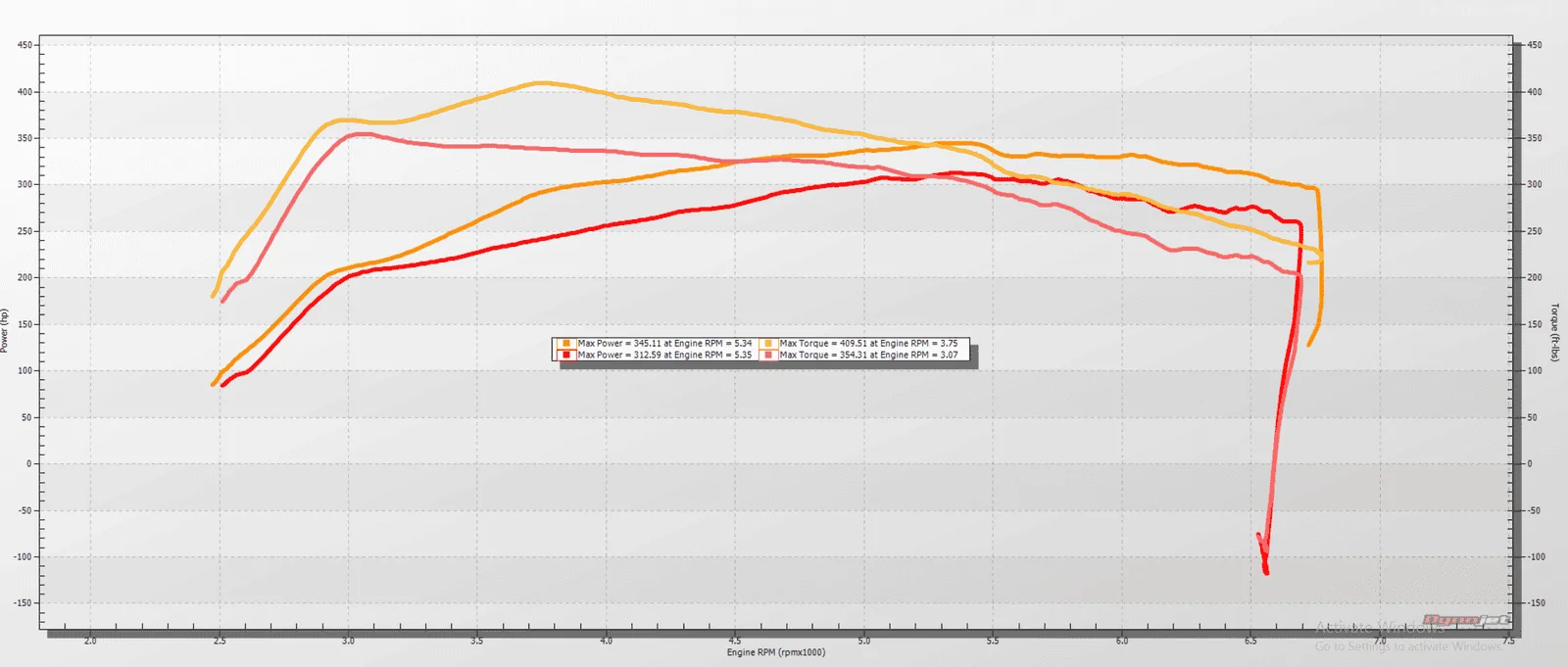

E30 results! I'm impressed. This is at the same boost level (about 21-22lbs) as the 93 tune, just with a 1/3 E70 and 2/3 93 octane mix (aka E30). The tune was tweaked by Lund for the change in stoich for the fuel and it allows for more spark adder but that was the only change. The car loves it! Unfortunately the fuel system won't support full E85 in these cars so E30 is it. The plot is a cooled-off 93 pull versus a cooled-off E30 pull. The E30 tune is also lots more consistent as it only lost a couple hp and tq on a backup pull. 177-179* cylinder head temp on both.
Also the air inlet temp (post intercooler) was much warmer on the E30 pull, starting at 82*F at the beginning of the pull rising to 156* at the end! (yes the factory intercooler is terrible). On the 93 octane pull, inlet temp started at 51* and rose to 125*.

Nice, E30 is great stuff. I picked up 50whp on a car with E30 from the 93 tune but unfortunately I can't find the runs from that day. Here is the latest one I did two days ago, I just can't get enough ethanol in my life. It's the man's fuel!
Only Modifications:
Levels Intercooler
AFE Drop In Filter
93oct vs E30
Edit: Realized the picture is too small..

Cool, thanks Adam. Is that 50hp gain also with adding a little boost? Lund doesn't want to add any boost until I upgrade my IC (I don't blame them, makes sense to me). This was at 21-22lbs.

23psi. Most E30 tunes I do are additional timing only, with a base timing around 22-24psi depending on the customers modifications. They have to have a setup that makes sense in order to get the full benefit of E30.
