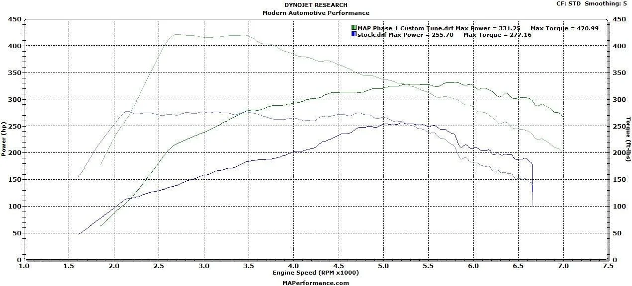

I don't have an EB right now (profile states "future EB"). I've been reading, researching and collecting info. I misspoke the 350-360 number, that's E30. I thought that was in the max ball park for a tune with full mods + 93 octane, but checked my notes and was wrong. I have "wheel 330hp/400tq with full bolt-ons and Adam tune" and another per Adam "I have dyno graphs of 93oct posted for our P1 and P1.5 kit, 330-335whp 410-420wtq on BP 93oct". Nice numbers and if I can switch MAPs will out of town with access to making E30 then even better!

Yes this is correct and on par.
