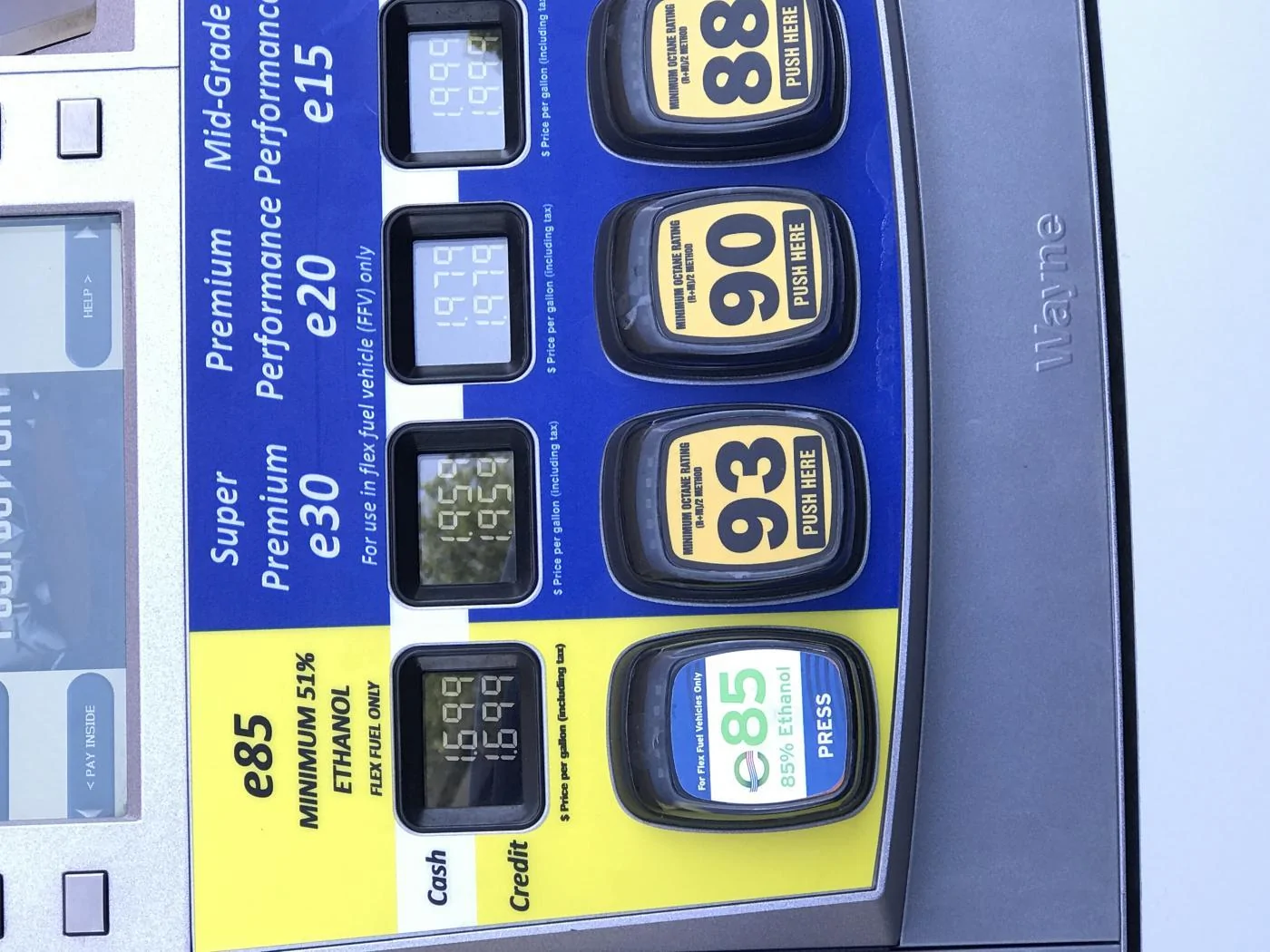

I have been reading all the talk about mixing gas. I would love to use 93, but we only have about 2 stations within 25 miles that carries it. Two stations have 93 that is already 30% ethanol. Would this be safe to use as I'm currently on stock tune?
Where are you? I have never seen fuel like that. I live in Massachusetts and everything is E10 and we have 87, 89 and 93 octane.
Rob0381
Mar 20, 2017
52
Kansas
Rob
2015 Mustang RS1 Premium W/PP
Pretty much the center of the US, Wichita, KS. I'll most likely just stick to tuning mine to 91 because of the scarcity of 93.

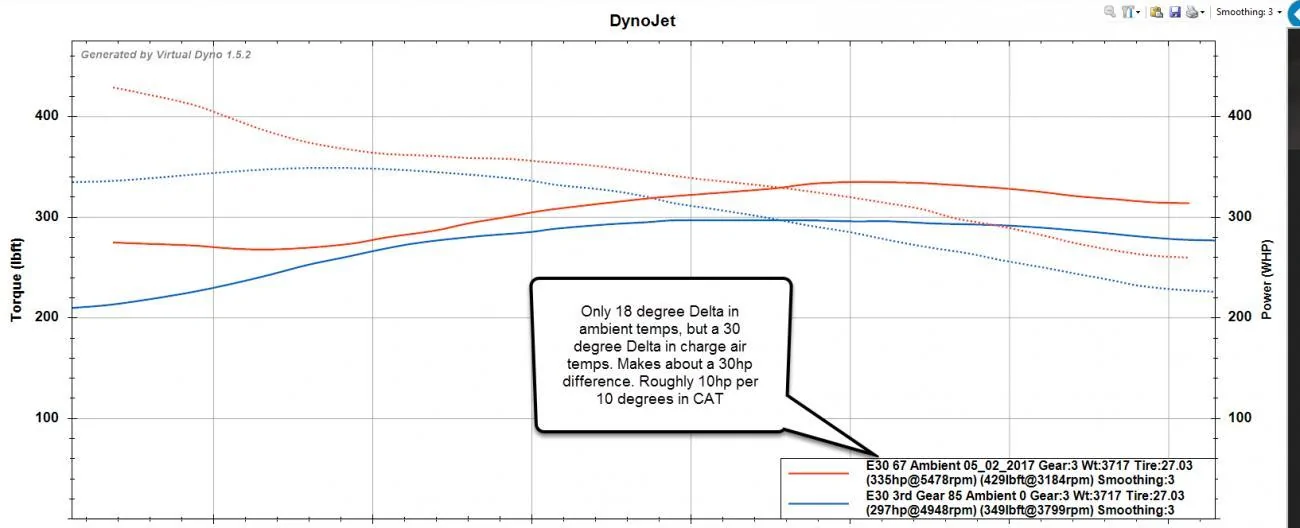

The point in running e85 mixing with 93 is that it raises the octane up because e85 is rated at 105 octane. Higher octane means less detonation and more timing can be advanced.
Screen caps below illustrate your point. The new octane rating with 93 was of course just 93. When using E85 it resulted in 95.489. The 93 pump in the second screen is E10 and the E85 pump is 105 octane.
