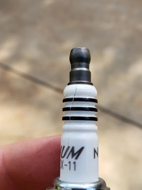

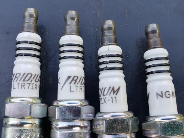

Welp after breaking down and pulling my brand new as of 2 days ago NGK plugs to do a compression test I found 3 of the 4 plugs on bank 2 had cracks in the porcelain! Still cannot believe it and definitely a first for me.. car runs great with good plugs.

Nothing wrong with just buying (or warrantying) a new set of plugs. That's a hell of a lot cheaper than what it could of been. So... Does this count for TBR's suggestion of spark blow out? :lol: Glad it's resolved though.

Damn. How tight were you tightening them down? You think it was install issue or defect?
