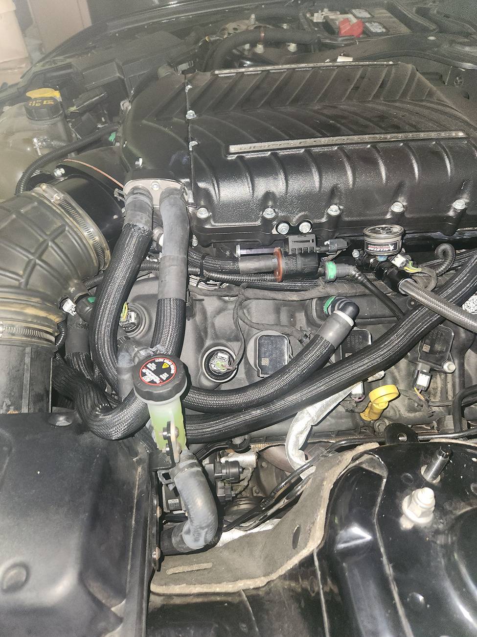

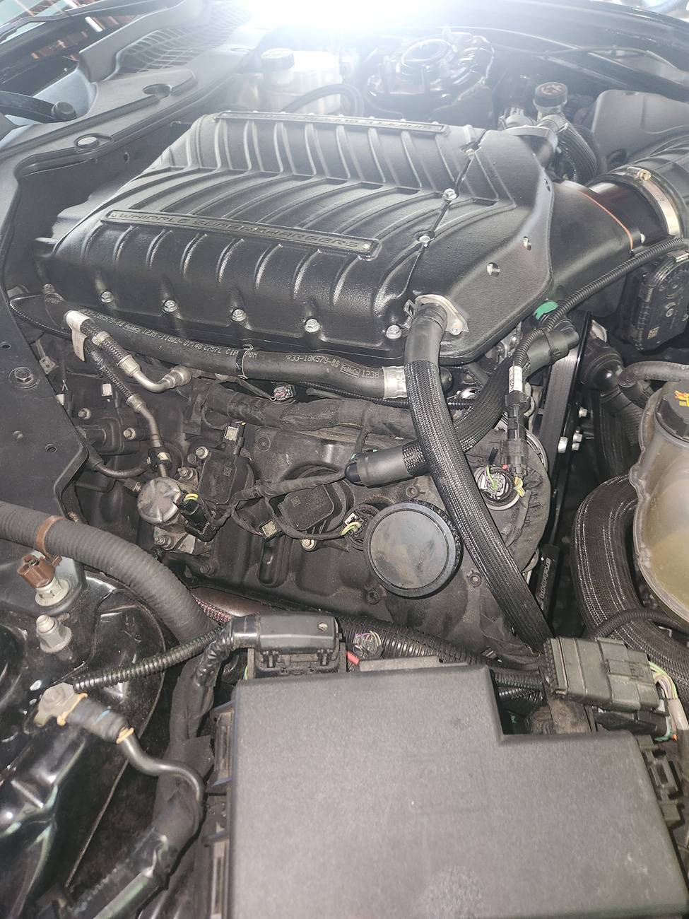

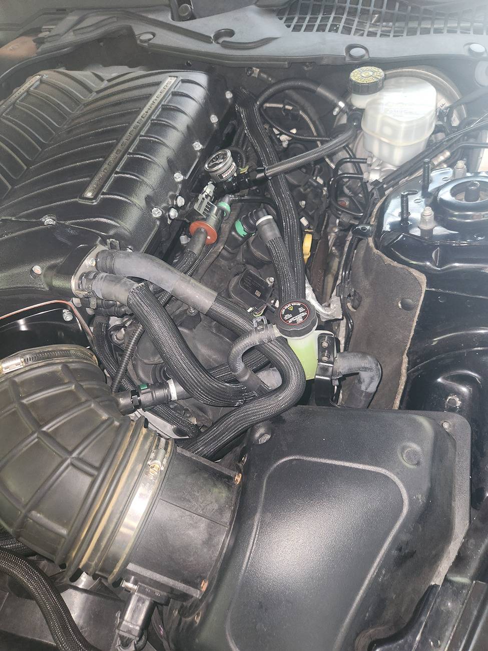

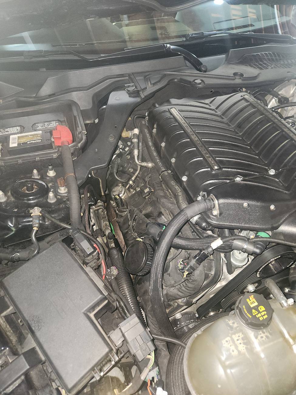

From Whipple support after looking at pictures of my engine compartment and me telling them what was going on with the oil pan gasket.
Jason,
The PVC routing looks correct. Make sure the passenger side hose does not have a kink. The way the hose bends looks odd, and a kink there would create high pressure in the crank case. Also make sure there are no blockages in either of the PCV hoses. The passenger side should communicate freely into the supercharger inlet and the driver side to the intake tube. The breather on the oil fill would need a check valve to prevent a vacuum leak as well.
If you install a breather catch can, the port on the supercharger inlet and intake tube are normally plugged/capped off. The PCV valve on the passenger side is replaced with a free flow fitting and both the driver and passenger side valve covers connect to the breather catch can system. The breather on the oil fill would no longer be needed.
Thank you,
Whipple Support
