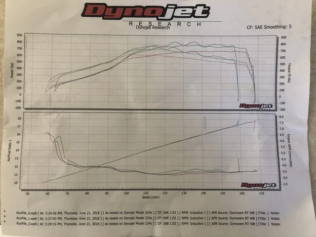

Yesterday I got it dynoed. The lowest run was about 10psi, middle is 13psi, and the top was 16psi but it was breaking up like crazy which can be seen on the graph. Even the middle run seems to be dropping off too much on the top.

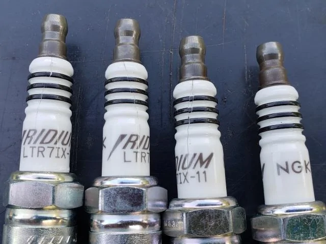

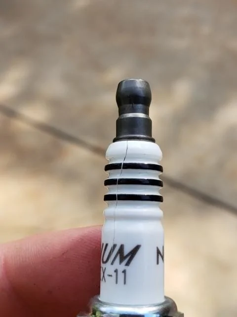

Make 100% sure the porcelain on the plugs is not cracked!! I Had the same issue on brand new plugs and chased it for a week, Pull all plugs and inspect porcelain, if they have cracks it arcs in the plug valley and causes break up!

^^^ that would definitely cause some break up. these plugs are so fragile....

I’ve tried another set of plugs with the same result but when I gap them I’ll check the porcelain very carefully.

Clutch? My graph looked similar, it was the RST smokin'

I’m running an RXT through a TR6060. I’ll post a video a bit later showing the dyno run. It sounded terrible.
