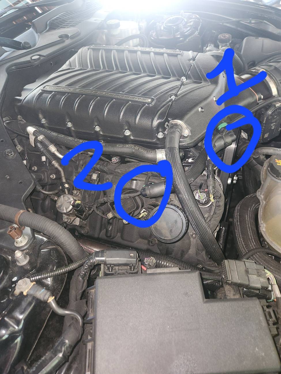

Should the line from the pcv to the whipple be sucking in air? When I unplug it, it blows out air. I’m guessing it’s blowing air from the intake when unplugged but I wanted to be sure.
I’m just baffled with this, about ready to sell the car.
Are you pulling the line off here (1) or here(2)?

The way I understand it, at times it'll blow air there, and at times it will suck. That's why the PCV has a check valve in it, and so does that UPR vent.

. While looking over the PCV system I noticed a line that was partially hidden. In the middle of that line is a check valve with an arrow pointing the wrong damn way.I swapped it, took the car for a ride and the noise is gone. Car even seems to have more power.
I haven’t tried it without the breather yet but I plan on doing it tomorrow as the oil stench sucks.
I’m hoping this is it.
