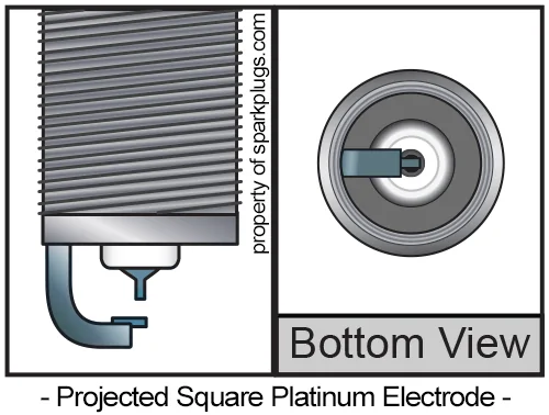

NGK 95605's are the same heat range, come pregapped at .032, have a projected square platnium electrode which is preffered for boosted applications. They are Ruthenium which is a step above iridium for life of these very small electrodes. The smaller electrodes are the less energy needed for a spark to jump between them. So you might not need to run as tight of a gap or even touch the gap at all. The more gap you can get away with, the more consistant and stable combustion events you will get.
