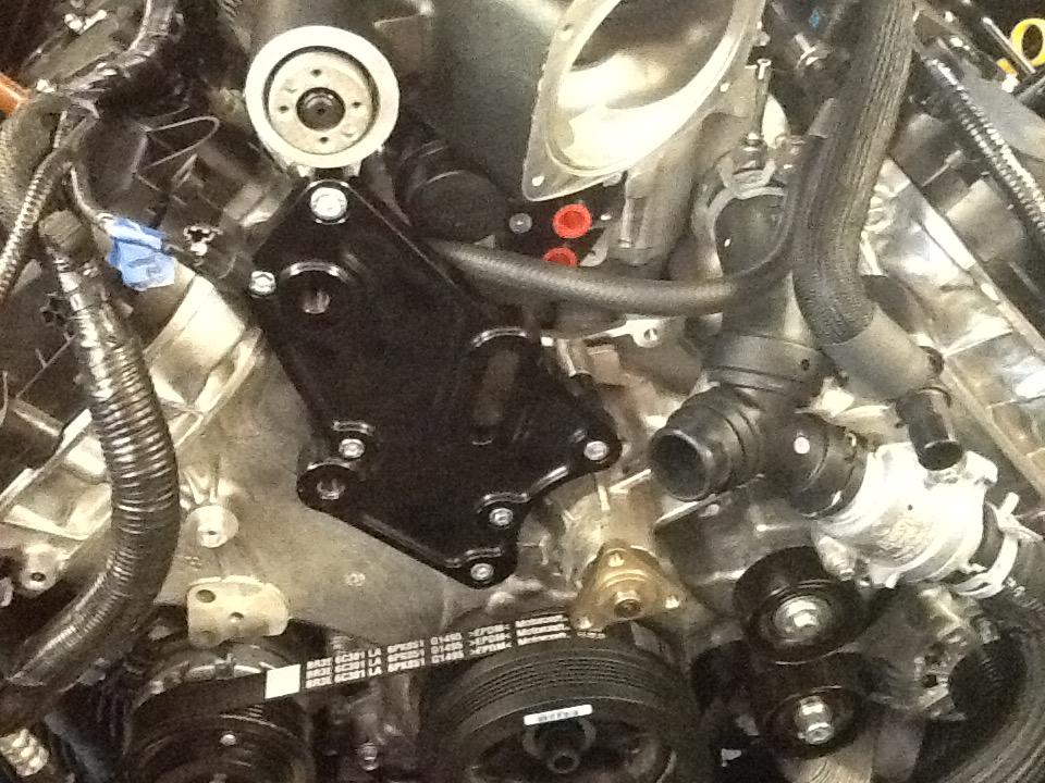

Can someone please tell me if this is the correct bracket for the Whipple Stage 2 kit on a 2016 Mustang. It is not what the instructions show. It bolts up perfect but there is no where to put the supplied spring loaded tensioner.

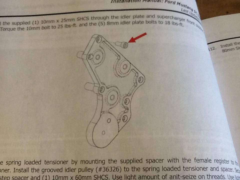

This is the picture from the instructions. Can anyone with one verify.

Looks like you have a different bracket than mine. I would contact Whipple immediately.

It's nothing like the one pictured in the instructions. It does fit as you can see but no where to bolt the spring tensioner. I!m just skipping over on going on to what I can do.

Looks like it might be for the F150 5.0 application...

You are correct lxh89. Dustin just messaged me and said he was sorry it was for an F150. He is going to Fedex me one overnight to have it here Monday. That is why I bought a Whipple. Awesome customer service.
