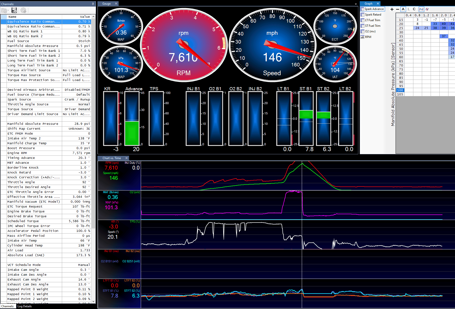

This pull was 775@7500rpm. The IAT2s never got over 138. Not sure what the boost reading is. Looks like almost 21 degrees of timing never pulled up top. I can not attach the file.

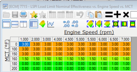

Just FYI, this is how Roush limits boost with charge temp:
I think they run around 1.6 load stock, depending on ambient air density, so it would start limiting throttle above 155-160 deg charge temp.

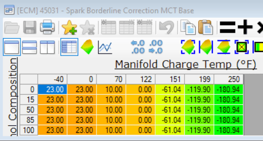

Roush starts pulling borderline timing at 122 deg charge temp:
This number is multiplied by another as a function of engine load, generally time .15 so at 151 deg it's pulling about 9 deg timing. Keep in mind this assumes you aren't riding the knock sensors. I don't know about the Mustang but the F150 Roush was tuned to not ride the knock sensors.

138 degrees IATs are wild.
