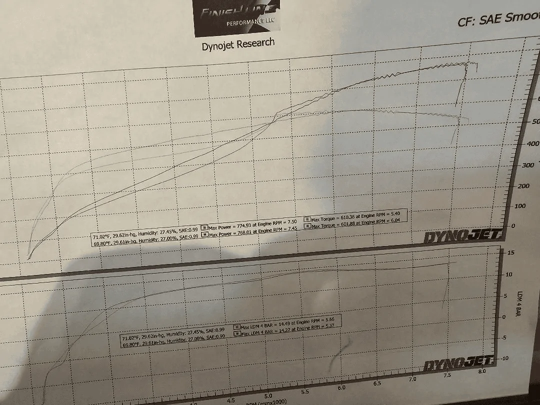

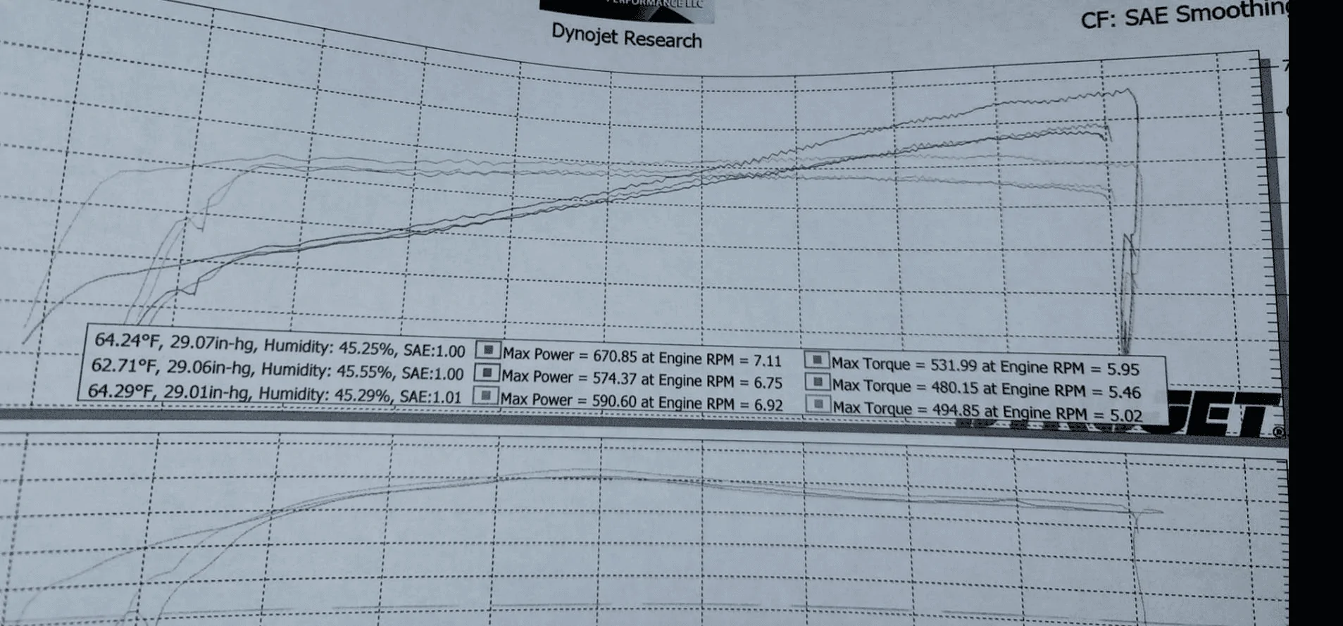

I posted the wrong graph before....a Whipple 3.0 should hold (and increase slightly) boost until redline. Look at these two graphs as comparison
Are you 100% sure they are graphing boost in both of the ones you posted? This is why it's nice to see the whole graph (as well as the legend). If boost is going down you will be able to tell in the power curve.
2018-mustang-gets-a-lethal-upgrade-from-whipple-over-700-rwhp-2018-05-12_15-06-22_359843-960x...webp
Yes graphing boost. Same Dyno.
Roush E85 87mm TB
Whipple 3.0 132mm TB 93 pump

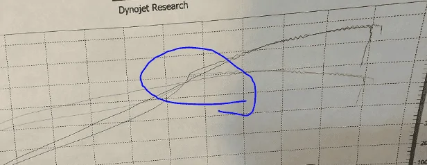

That spiky shit in your HP at higher RPMs could indicate slip, which coincides with that dip after 55-6000
That red line in the first graph looks wonky too right in the middle
The spikes are in both cars dyno graphs. Roush and Whipple. The wonky at crossover was tires spinning on the dyno at WOT.

I agree with robvas, that Whipple car should be making steam up top, where the 2650 is running out of gas. Up top is where the Whipple REALLY shines.

Both belts could be slipping. That Whipple for sure should be building boost until redline. I can't find a Roush 2650 graph with boost logged

680rwhp looks normal for a Whipple 3.0 stage 2 set up on pump gas. Maybe the boost ref isn't correct????

The dyno was before the interchiller. My first thoughts are the TB and inlet are to small. That's why I'm seeing a boost drop (we didn't see belt slip or the TB closing during pulls) Then I see a dyno sheet same dyno Whiple 3.0 132mm tb. I see the same boost drop....

Whipple starts ar 12 drops to 9.
It should be making similar power then, and it isn't.
There could be a hundred things wrong but it's most likely not the supercharger and not the 132mm throttle body (car in the article that made way more power had the same one)
