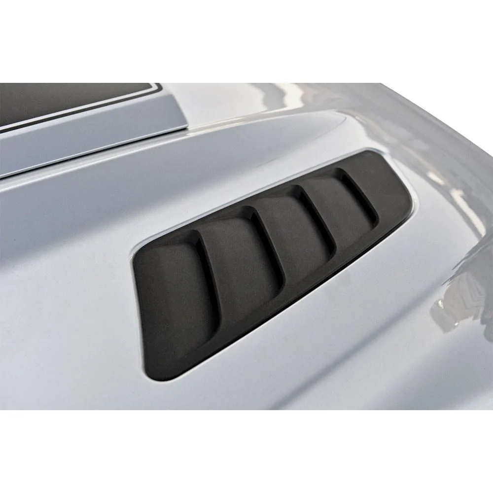

Maybe the Roush version is more functional in that respect?
Reminds me of the 1LE Camaro hood vent....and the Chevy Performance guys certainly do their homework.
